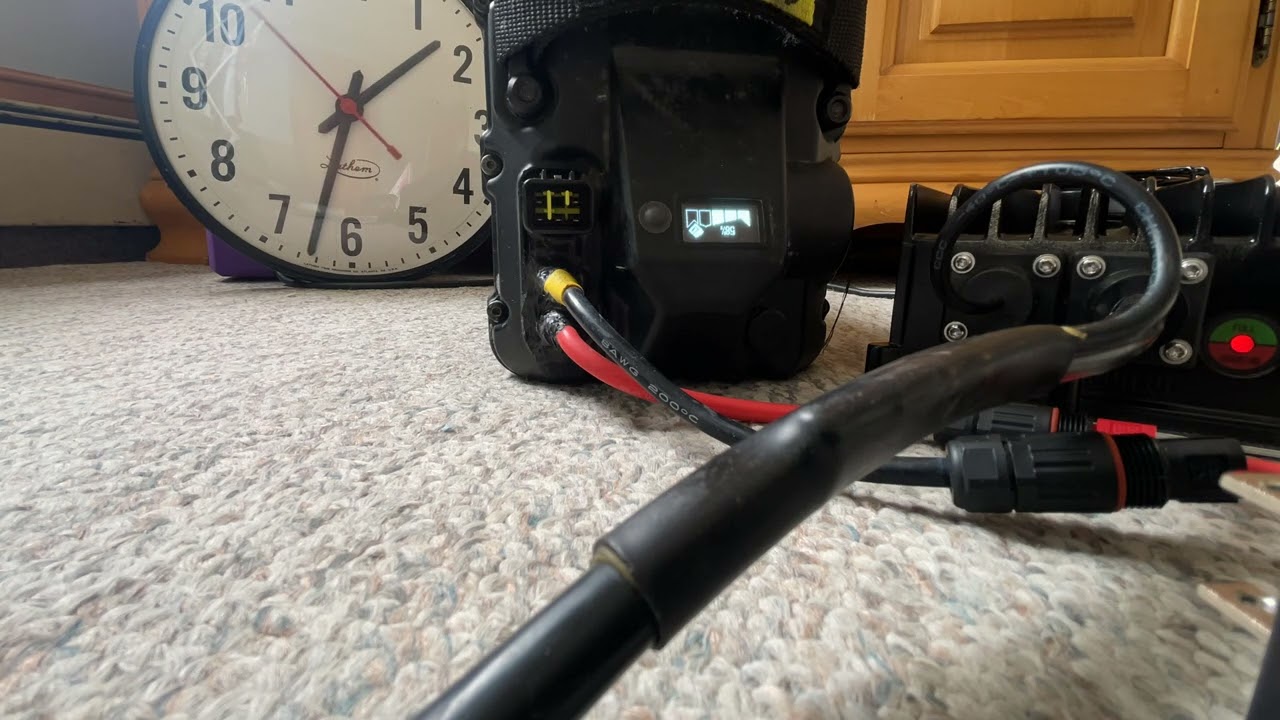

I am charging at 7.5amps and I find that a decent time for my uses efoiing. So way less than spec but that will likely help in cycle life. I also only charge to 41v so far. I have a few long distance tours planned where I will go to 42.
I don’t know the answers to your questions at all. I just connect the battery to the charger and it charges. I bought it on Facebook.
Now it charges at 60% of the charge level more slowly than I said above (1:40 for every 1%), maybe I was wrong, or maybe the speed is different at different charge levels, or maybe it’s because it’s very hot in my apartment today.
Here’s the video, as I promised. Next time I’ll try to make a longer video when the battery is more discharged.
I can’t control the charging speed because it’s a ready-made waterproof battery with a BMS inside and just two wires to connect the charger or ESC.

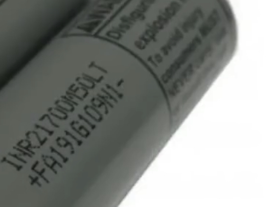

This is the cell used in these packs
IMG_2087
The data sheet is linked by @windego above
Between 0.3c-0.7c charge :grinning:
Standard charge time 4.5h according to this:
