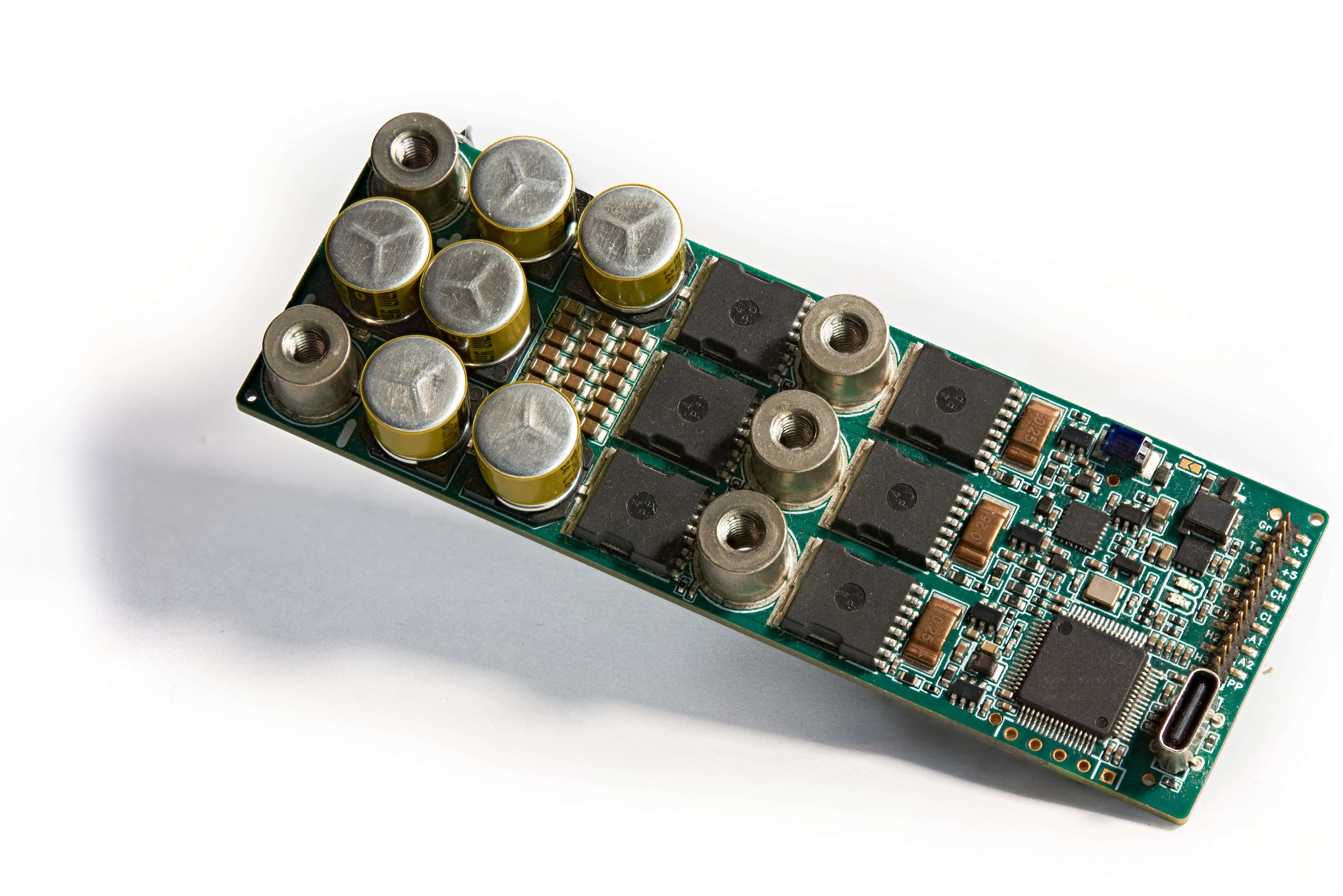

Ok, this got here from China in 4 days, it’s almost faster than half of domestic shipping.
Looks great. Form factor is good and heat transfer also seems really good (forgot how much I hate soldering cables to ESCs).
Signal cable is pre soldered which is nice.
Soldering the thin GND cable to the 12200 was pretty annoying.
Using the same settings from my 12200 it behaves identical on the bench. I think for my tow boogie this could be a drop in replacement.
