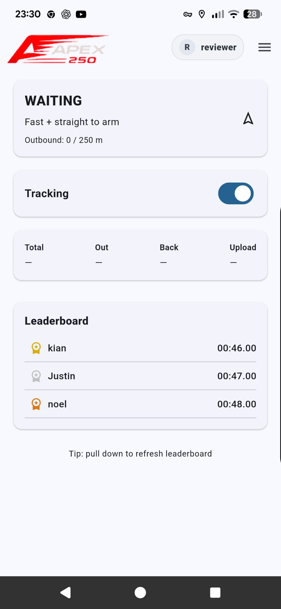

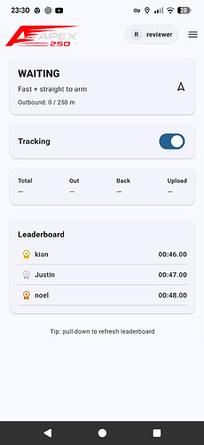

Some Android screenshots.

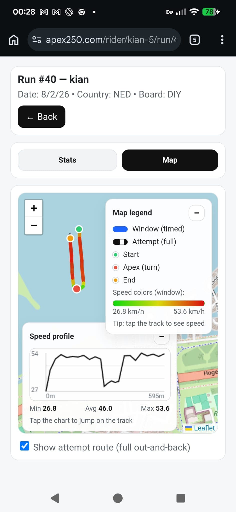

Interesting project 50+ km/h is cookin!!
Can you define what the app considers an apex turn? For example assuming the path coming into the turn and out of the turn are parallel - what is the max distance between the paths?
Re: Interesting project 50+ km/h is cookin!!
Do not pay too much attention to this.
We needed some dummy runs/data to populate the database for testing :grin:
