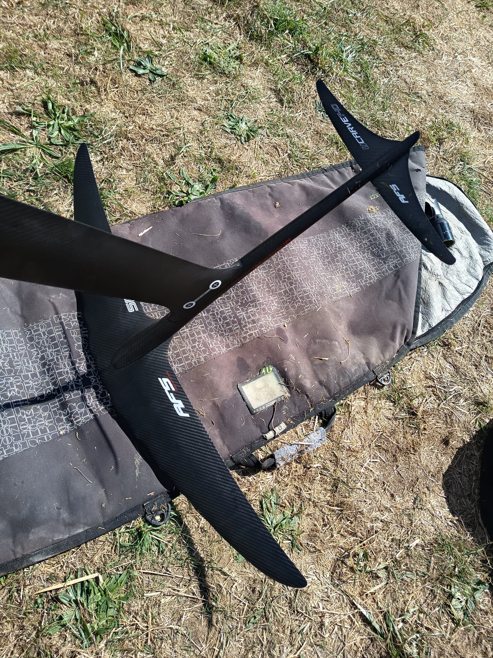

Got some new toys…
Was a bit of work to get the stretch pod to fit the slim mast, as the design was failing for chord<119mm, but got it fixed.
The foils are just amazingly good.
Not sure which part is responsible.
But for the 750cm² I had to adjust my VESC settings up. In chop I could only get that one going with a wave pushing.
So had to increase current limit from 100A to 120A and power limit from 1900w to 2200w.

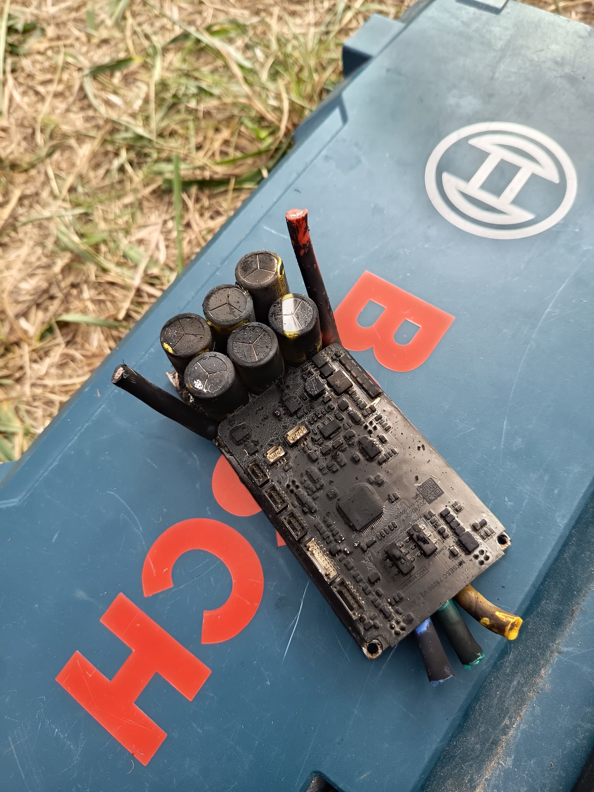

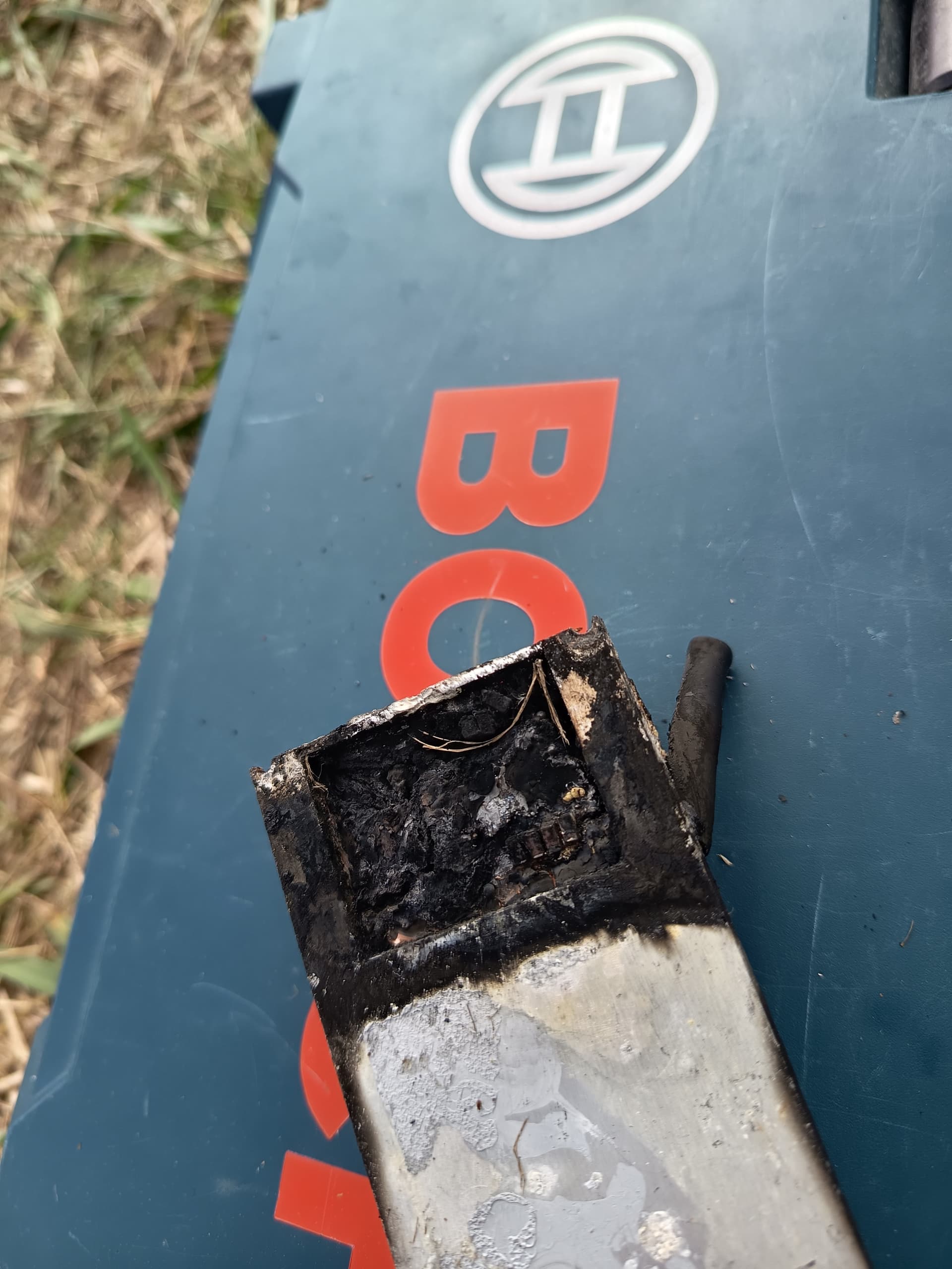

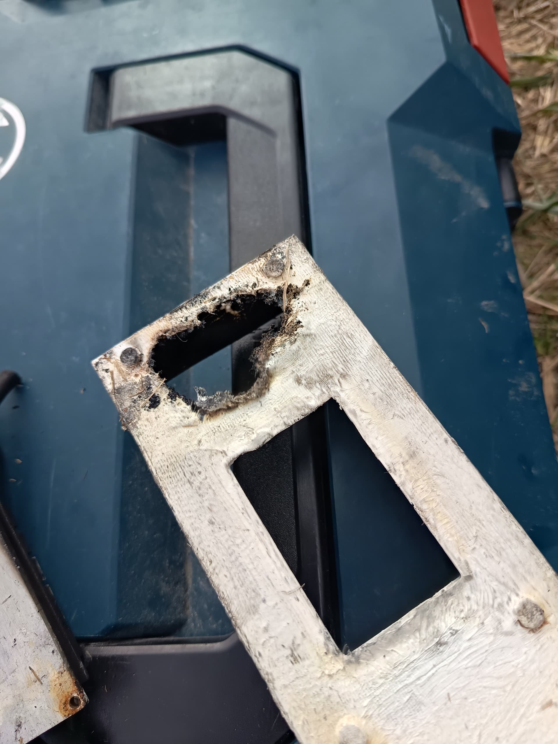

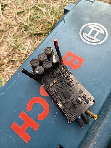

Turned on the setup this morning and created a lot of black smoke.
Happy this happened on land and lucky only the ESC died and the board is undamaged.
No idea how to potentially deal with this when in water.
Wow, very ugly. Did this happen right as you connected the battery or did it seem to spontaneously start smoking?
I had a 75200 like that short a 14S battery a few years ago. No smoke from the vesc, just a blown fuse.
I suppose this can make a case for an easy kill switch. Those used to feature on efoil builds but haven’t seen them on assist builds. Harder to integrate into a smaller space.
no, this happened after a while (>30s <5 minutes).
I heard an odd clicking sound when connecting, like a relay clicking and in hindside, I should have checked, since there should have been nothing that could have made that sound.
This was luckily no full short, batteries were not even slightly warm after.
I assume there must have been water inside my box that houses the ESC and the components on the undersided just slowly burned through.
