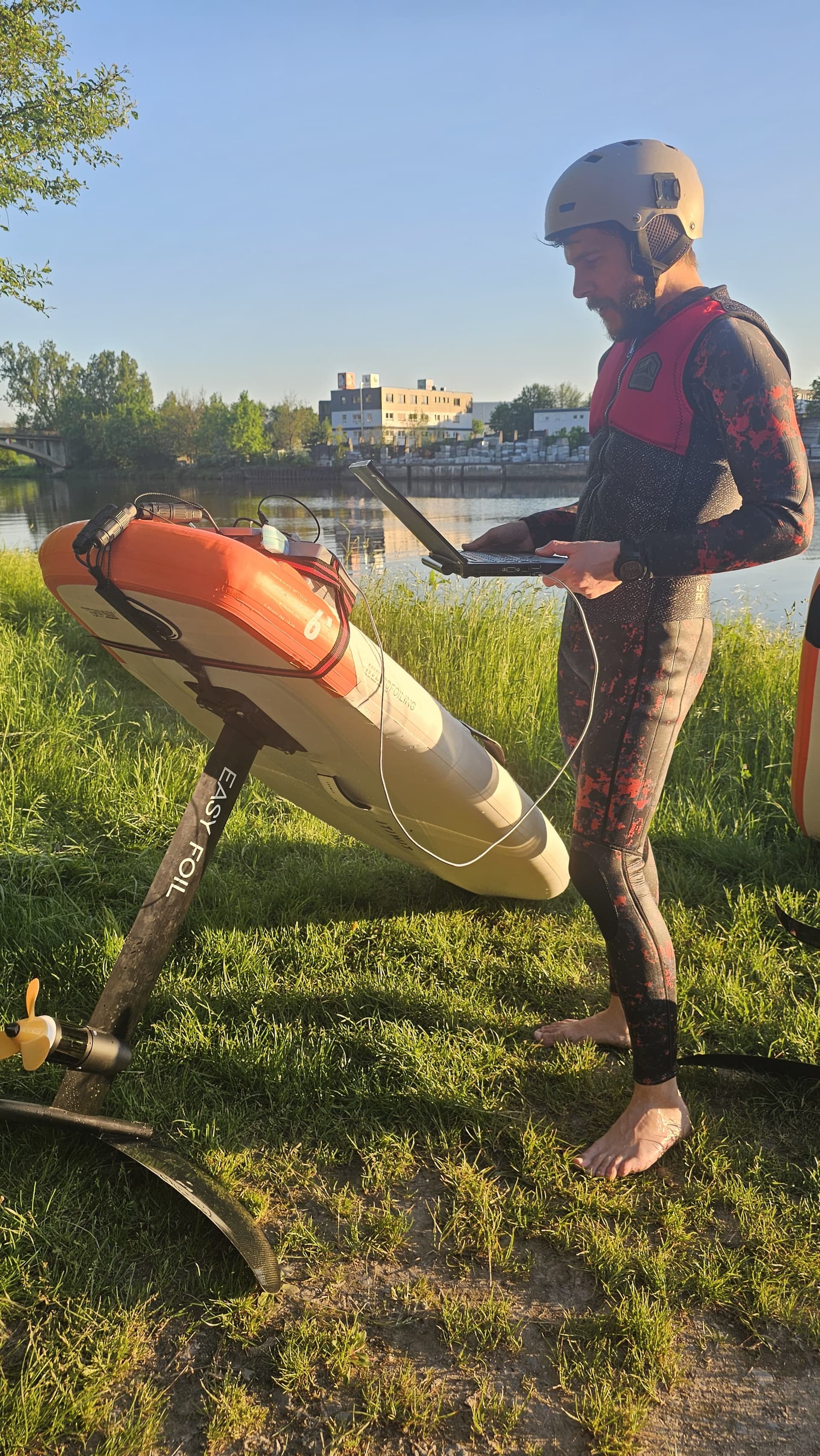

First build in 2022
Weaponcase build, almost everything ordered twice for 2 builds

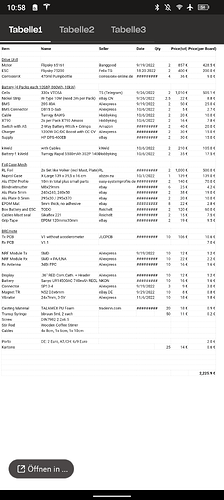

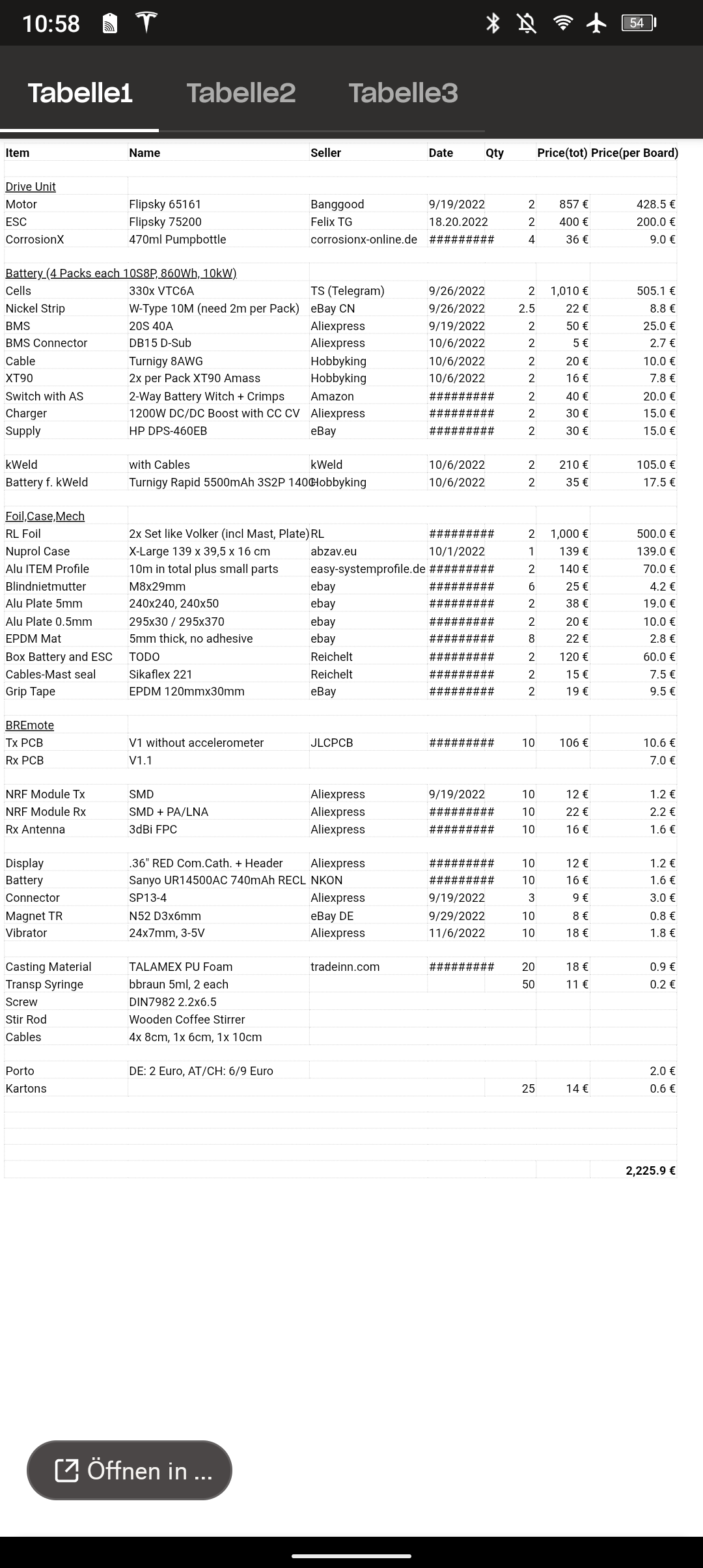

Price 2200 Euro for 1 complete Foil (see image below)
  • 500 Euro Foil set
  • 500 Euro Battery
  • 500 Euro Motor + ESC
  • 500 Euro Case + other small Parts
  • 200 Euro Tools,…

Price overview 1st build
1st:
2nd:
3rd:
