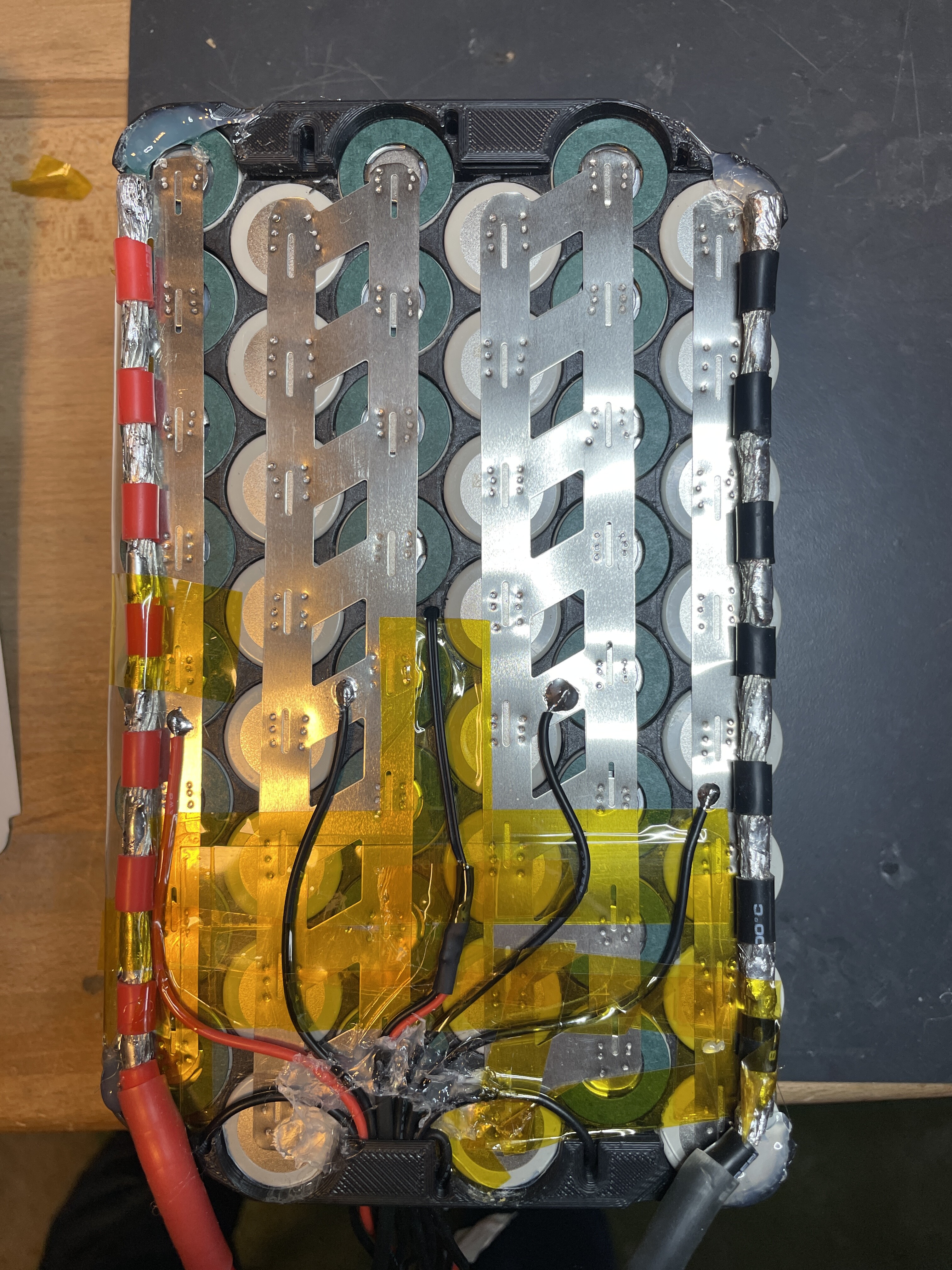

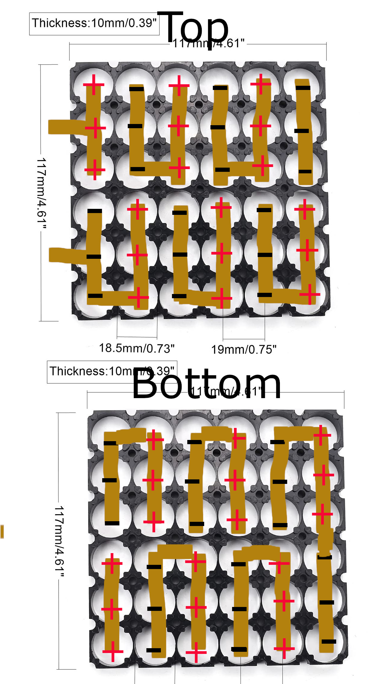

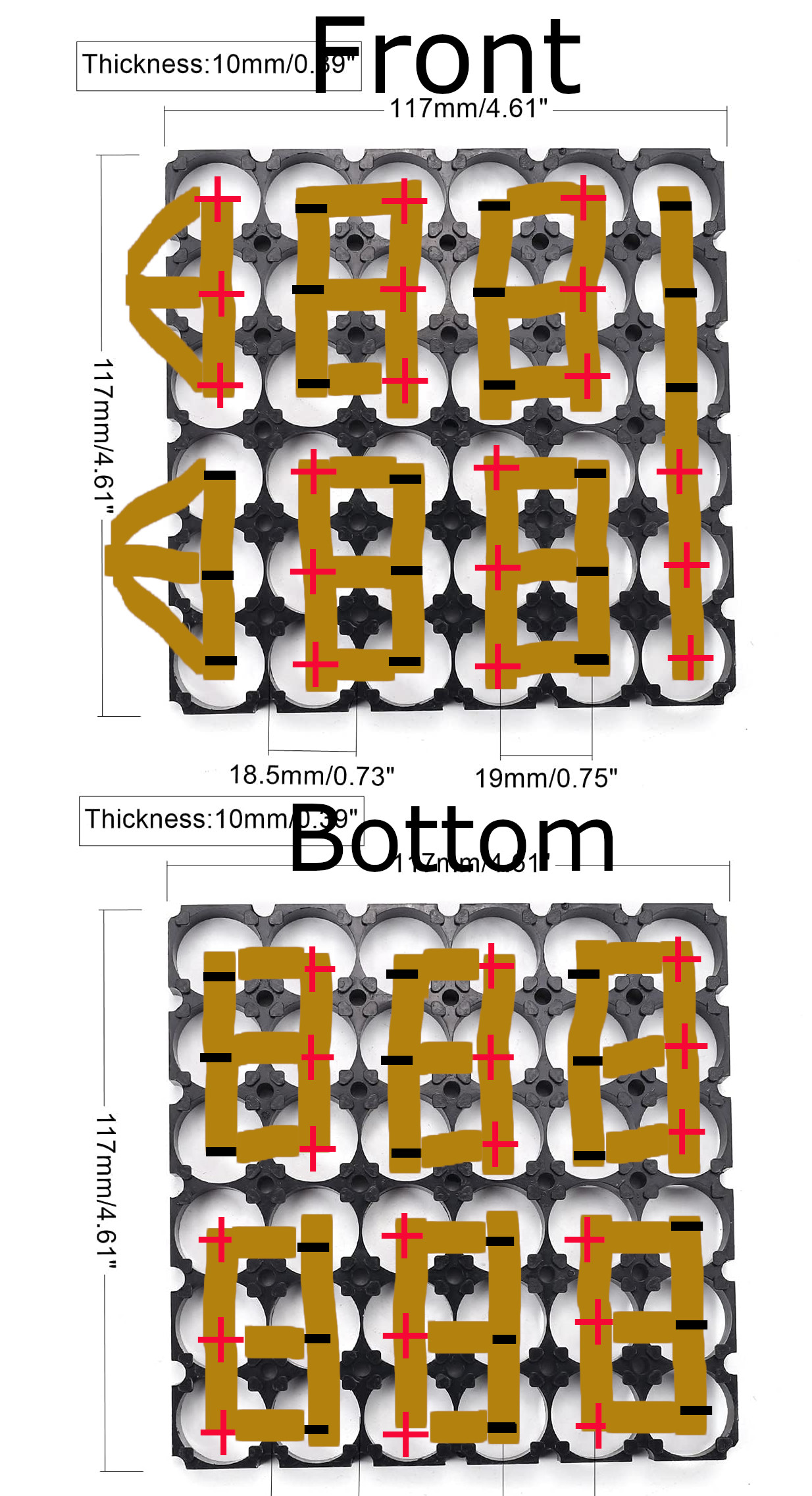

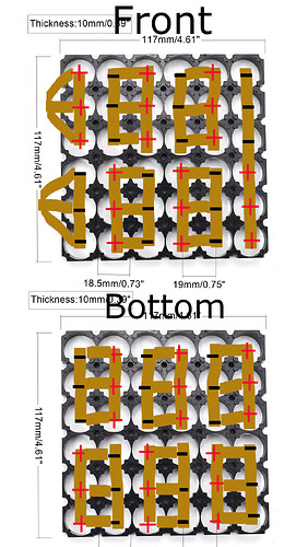

12s3p wanting the positive and negative to exit from one end due to enclosure limitations. Also the balancing leads are something I have no idea about yet will be using a 13 wire 12s connector and charging with a icharger x12 12s balancer.
Thanks!

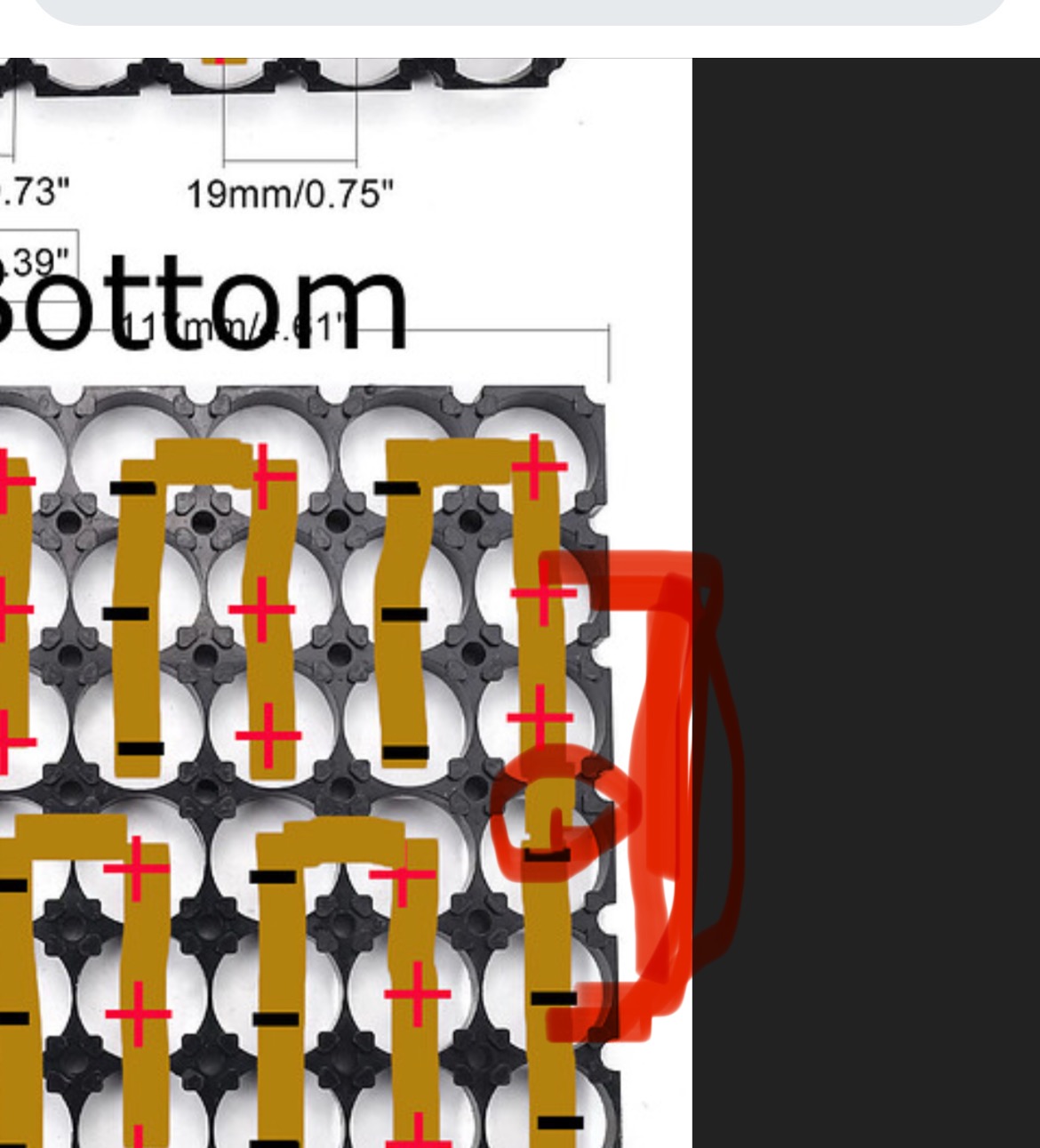

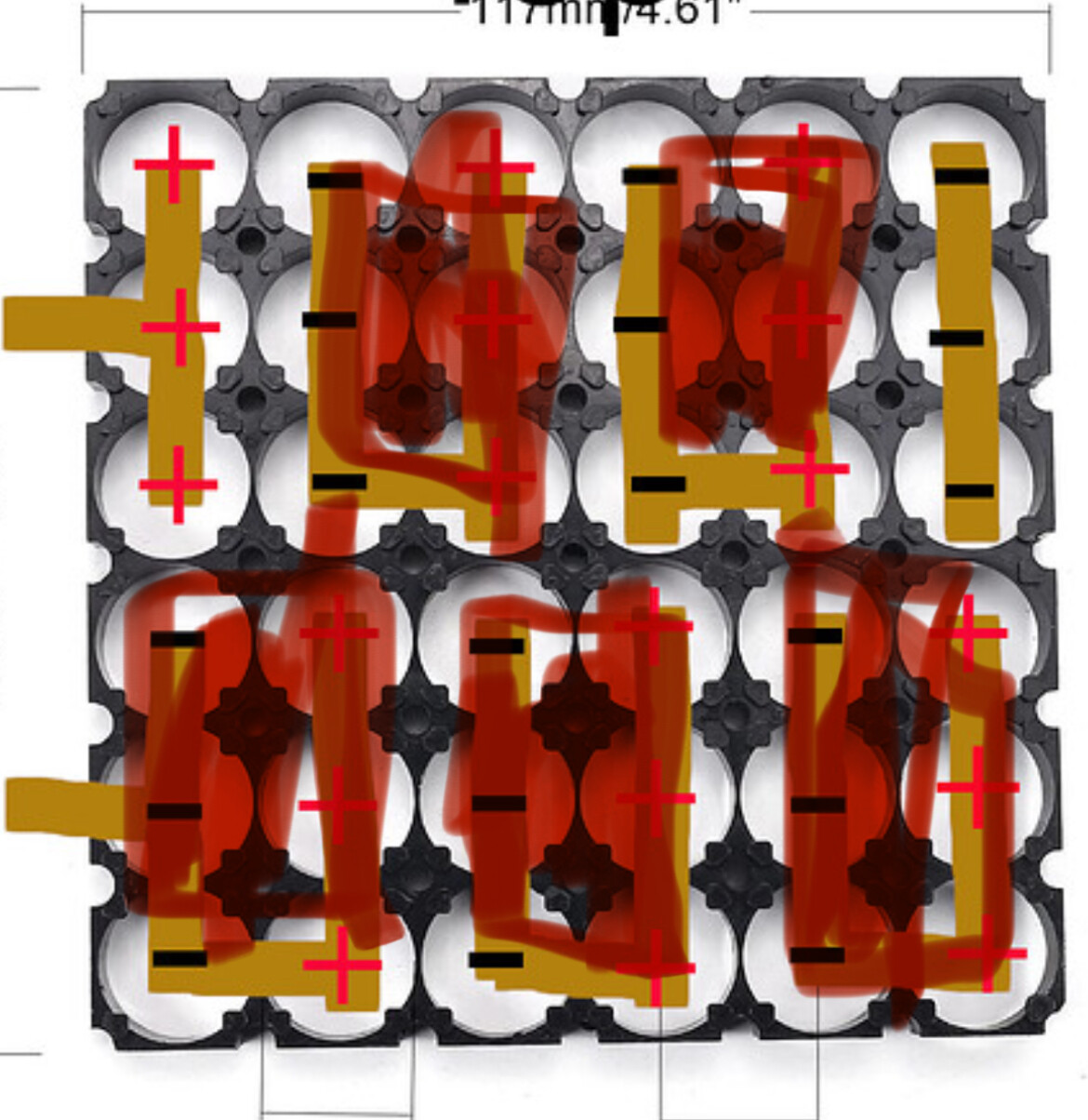

Better connect the S connecrions over the whole area.
Hot spot here, add some wires/copper
I was about to reply roughly the same thing.
If you have large enough sheets of nickel you can just have one continuous piece as shown above. If you have the more normal nickel strip you should add more along the series connection. Your initial setup above forces all the current through a single strip, that makes heat and would be less efficient
Plus and - terminal connnection might also be too weak with just the nickel strip.
That is how I connect my terminal leads (8p)
Had a feeling it would be better to have more series connections.
Was planing on doubling the series connection and that whole right side long straight section with .2mm 10mm wide copper strip. Would that be enough or do I need to run it from the opposite ends to give it alternate route of travel? Could even triple it right at that hot spot.

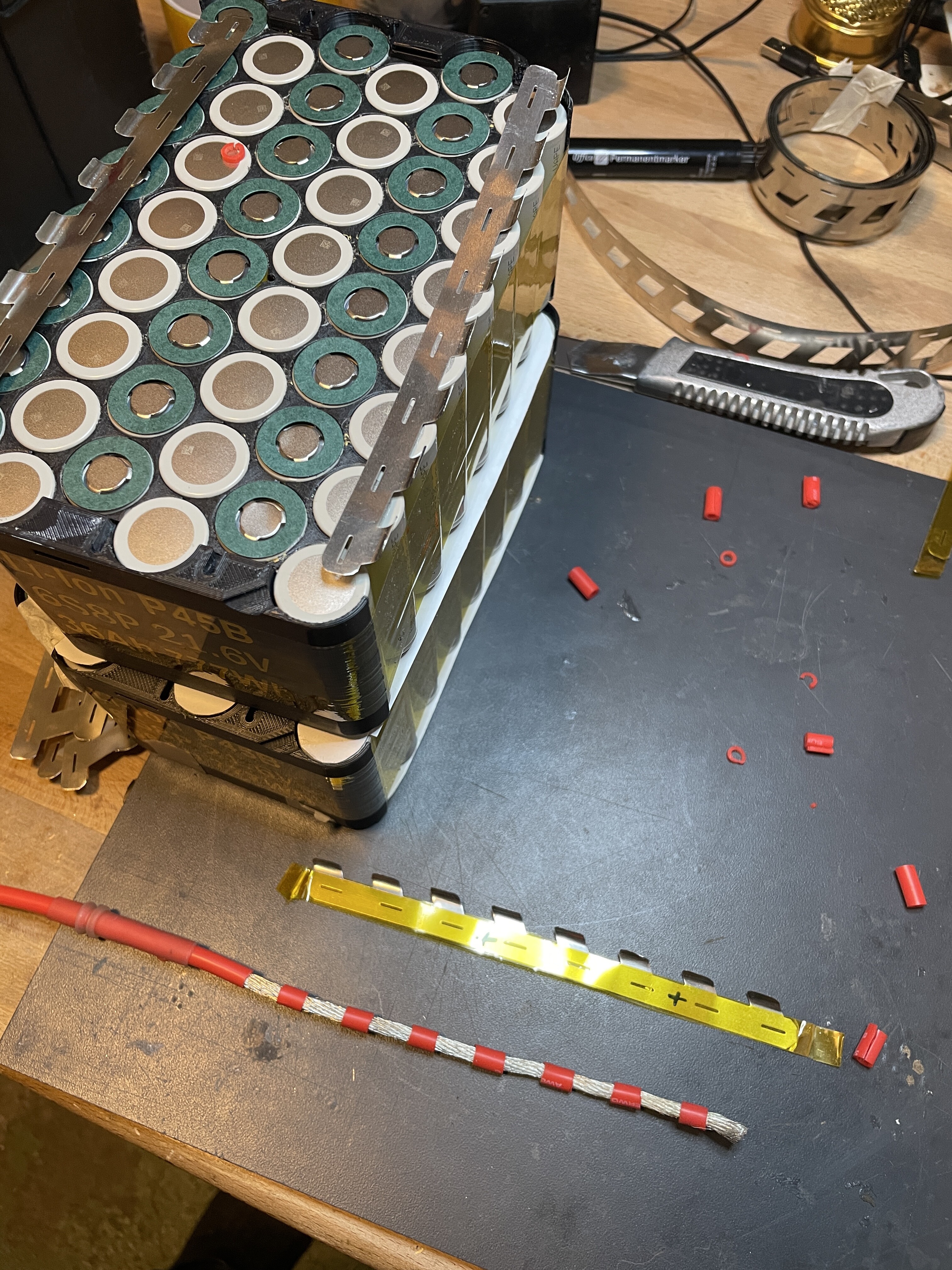

I know it’s frowned on but I’ve done a lot of research on safe practices of soldering these cells successfully. Main thing of course is to keep the heat out of them and use a high power iron for only a second with both the cell and the strip pretinned. This way I could use the copper strips to pull the heat away and for their efficiency.
Mahalo Sat_be and Roger

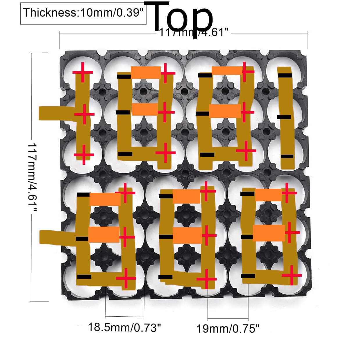

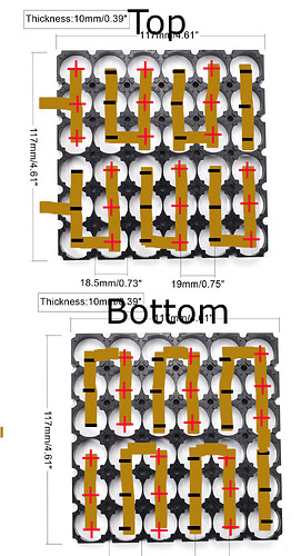

This look better? (with the bottom right and + - sides doubled copper strip to .4mm x10mm) trying to keep this as thin as possible to fit in a 3.3" tall aluminum case.
Changed per sats correction below
