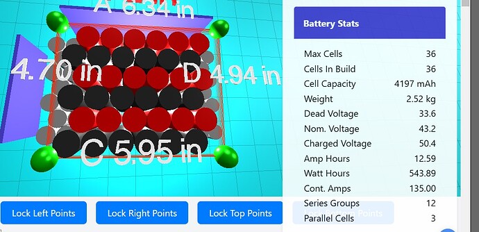

Still looking for a good guide on 12s3p pack building and how to arrange it for efficiency. Also need to figure out the balances leads. It’s a lot to learn but I’ve been wanting to get into battery building for years.
Here’s a good tool for figuring out the battery size and layout, not sure how it figures the pos/neg. Any help or pointing in the right direction here will be greatly apricated!

Can anyone with battery building experience proof this set up?
12s3p wanting the positive and negative to exit from one end due to enclosure limitations. Also the balancing leads are something I have no idea about yet will be using a 13 wire 12s connector and charging with a icharger x12 12s balancer.

Better connect the S connecrions over the whole area.
Hot spot here, add some wires/copper
I was about to reply roughly the same thing.
If you have large enough sheets of nickel you can just have one continuous piece as shown above. If you have the more normal nickel strip you should add more along the series connection. Your initial setup above forces all the current through a single strip, that makes heat and would be less efficient
Plus and - terminal connnection might also be too weak with just the nickel strip.
That is how I connect my terminal leads (8p)
Had a feeling it would be better to have more series connections.
Was planing on doubling the series connection and that whole right side long straight section with .2mm 10mm wide copper strip. Would that be enough or do I need to run it from the opposite ends to give it alternate route of travel? Could even triple it right at that hot spot.
I know it’s frowned on but I’ve done a lot of research on safe practices of soldering these cells successfully. Main thing of course is to keep the heat out of them and use a high power iron for only a second with both the cell and the strip pretinned. This way I could use the copper strips to pull the heat away and for their efficiency.
Mahalo Sat_be and Roger
This look better? (with the bottom right and + - sides doubled copper strip to .4mm x10mm) trying to keep this as thin as possible to fit in a 3.3" tall aluminum case.
Changed per sats correction below
No it is not going to work like that, you need to connect - in the very right of the top row to plus of the lower block straight through! Think it through.
Follow the current flow and you find the mistake.
The plus P row at the bottom is orphaned, you need to arrange the cells in a way you have all “digital” 8 shaped strips at the bottom, alway 6 cells connected.
How’s that?(above) Thanks for catching that, it’s 4am and I was winging it.
