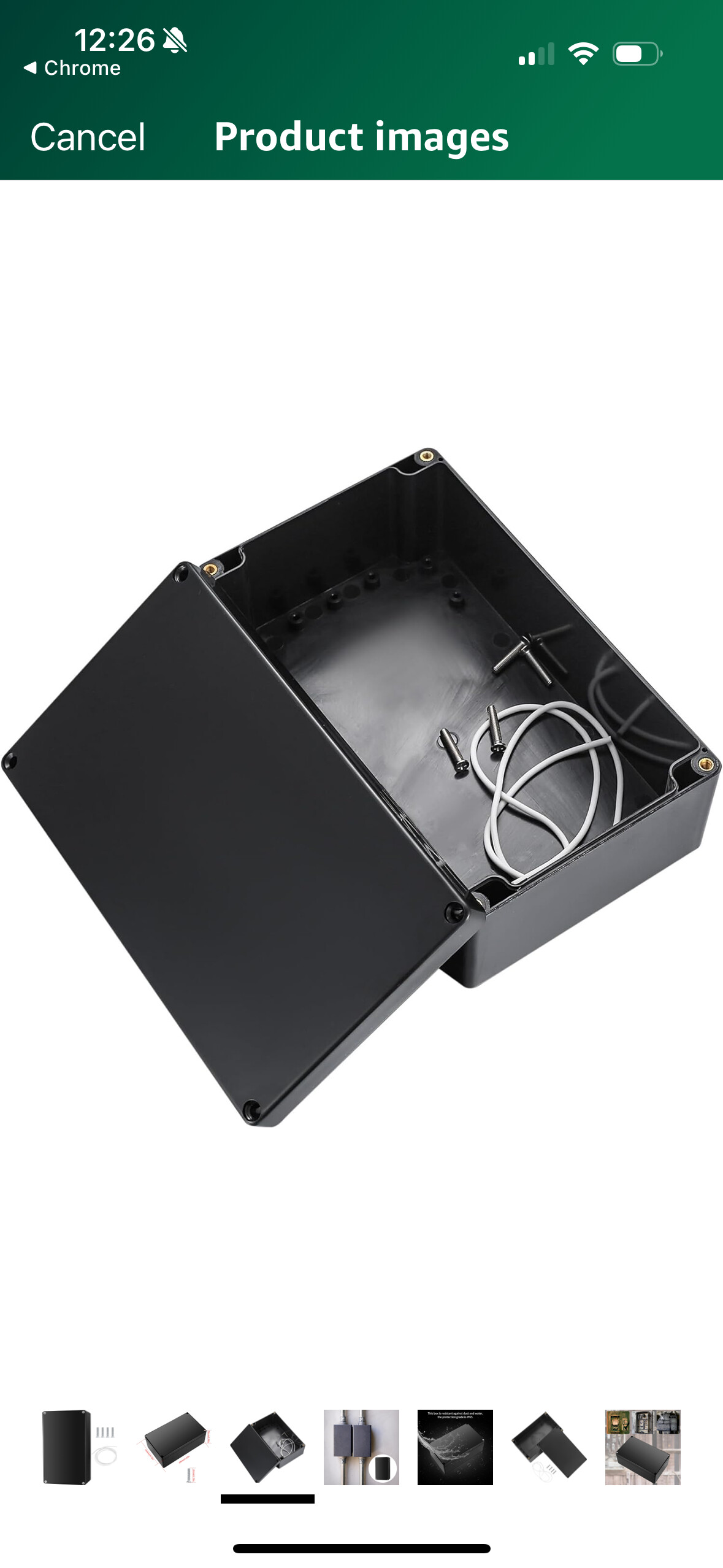

For the battery will use 21700 16S3P

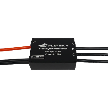

For the ESC the new waterproof from flipsky leave the ESC outside the derivation box so it can cool down
IMG_8378

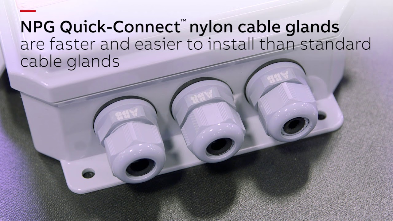

For the battery enclosure use a derivation box ip68 with gland connection for all the cables to get in too (6 cables) will secure the box in the backpack with foam

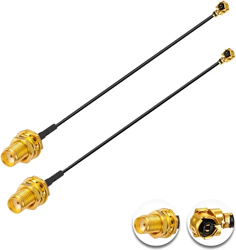

Finally run the antenna cable out of derivation box to the shoulder pad
