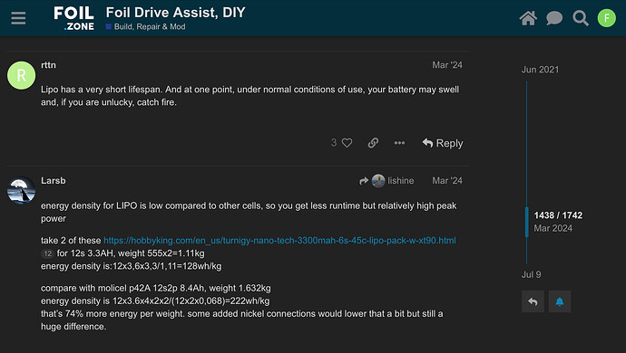

@Larsb had some very clear detailed statements as I recall
Like this for example
No opinion from me but some experience, I got a tow boogie where I first used my 18650 based ebike battery that was 14s and around 900wh. Now this battery is older and I imagine degraded a bit, It ran my boogie for around 30-40min before voltage sag didnt let me get onto foil anymore even though 40+% of battery remained.
To not miss the season I ordered 4x12ah 6S Lipos (turnigy/hobbyking). Have them in series and parallel so 12s and maybe around 1000wh. I can pull higher amps out of these at lower voltage so can foil all the way to my set low voltage cutoff. This lets me ride around 1hr on the boogie.
