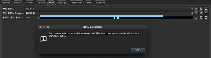

The “ERPM Limit Start” setting looks interesting too:
According to the description text, it could be used to soften the ERPM limit, which sounds like it could smoothen things out on the top end. Thoughts?

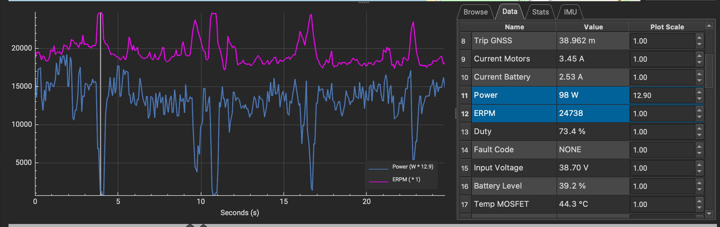

Here’s a VESC log visualizing the ERPM and Power where you can clearly see when the prop ventilated because the ERPM spikes and the Power (Watts) is going way down:
Assuming there’s no really solid way to solve the prop ventilation issue with VESC settings, do you think it would be feasible to solve the issue with a custom VESC LispBM script that prevents ERPM increases if current draw decreases?
If this is what you want, can’t you just have speed (rpm) control configured?
Thats is technically what a speed regulator does.
Or even using duty/voltage control. Motor current will slam down to zero as rpm increases raising back-emf voltage to input voltage*duty.

My ERPM Limit Start is also on 80% and I think this is ok for me.

But that is bullcrap. There is no significant speed error if the controller tuning is decently quick…
It is just that would be the feature with speed control, motor RPM would not skyrocket when propeller is running in air. With current control thats what happens without rpm limits.
But I only got a masters degree in control engineering, so I might be completly off, lol :wink:
