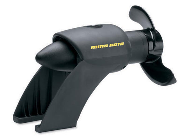

I can’t find real motor power or thrust numbers, but voltage is relatively low (25.9 Volts) and the whole thing will be designed for low speed cruising in a kayak or on a SUP, so very likely no enough to foil.

Our thruster put out roughly the equivalent power to a MinnKotta 30.
Let me know if you have any further questions.
Which I’m assuming that she meant the Minn Kota 30 trolling motor. It puts out about 30lbs.
