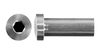

You could just use a Barrel Nut. All you would need to do is drill the back of the prop to the diameter of the barrel nut. Get the prop on your lathe and you could get it to fit perfectly.
Perfect method, its cheap, simple & quick
You have inspired me to install my 7 inch pitch FR prop onto my Reachertech motor.
Only had to drill a 10mm hole through for barrel nut clearance. Easy!
Used a 25mm CSK barrel nut. Was a touch long but nylon washer made it good. Probably only need a 20mm.
