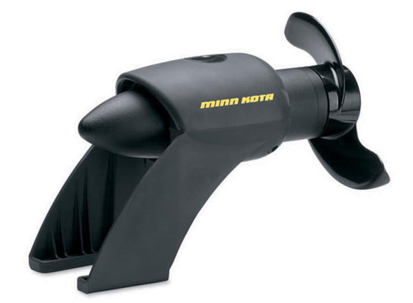

something like these
I actually have that one sitting in my office it’s waaaay bigger than it looks in the photos and won’t work.
