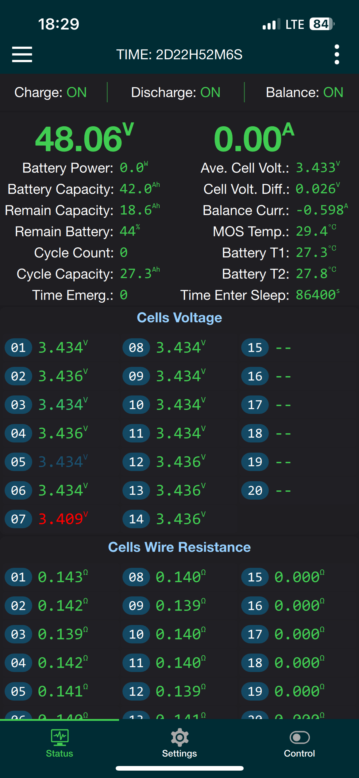

The link under shows the stats of my BMS and my VESC.
Both showing ±2700W of Power, at full throttle, but my VESC shows 120A and my BMS shows 53A.
Is it normal?
Yes, because vesc shows phase current and BMS shows battery current. It should be possible to show battery current from vesc (with metr you can log it). I think its calculated from phase current.

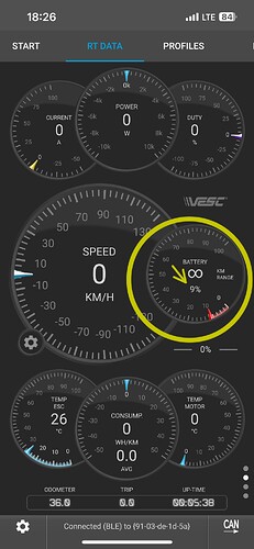

Hey guys! New question!

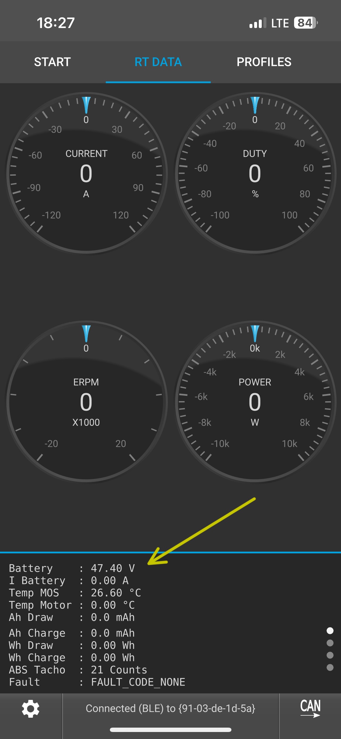

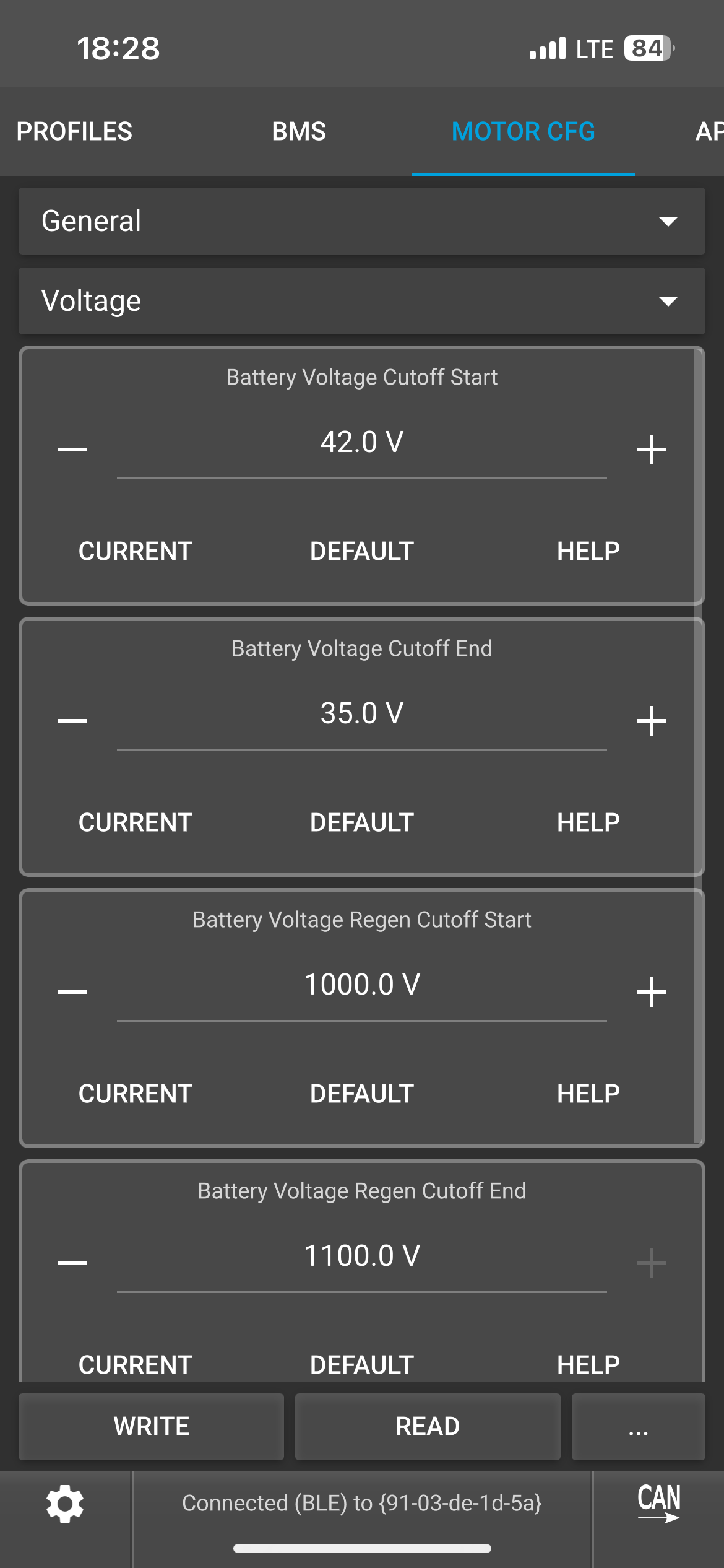

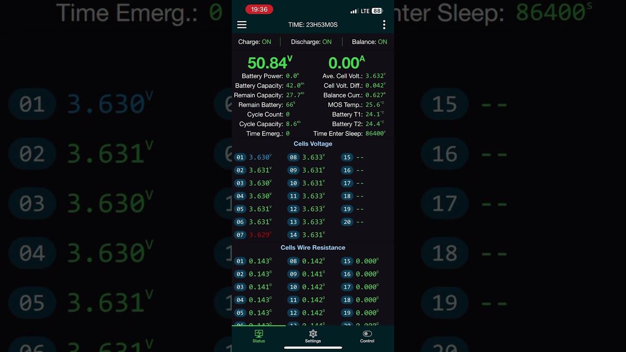

Yesterday I went for a ride. At the end, my VESC cut the power thinking the battery was low.
The VESC showed 9% battery, but my BMS showed 44%.
My VESC also showed that my battery was still at 47.4V and my setting to start the cutoff is set at 42V…
You guys have any idea?
