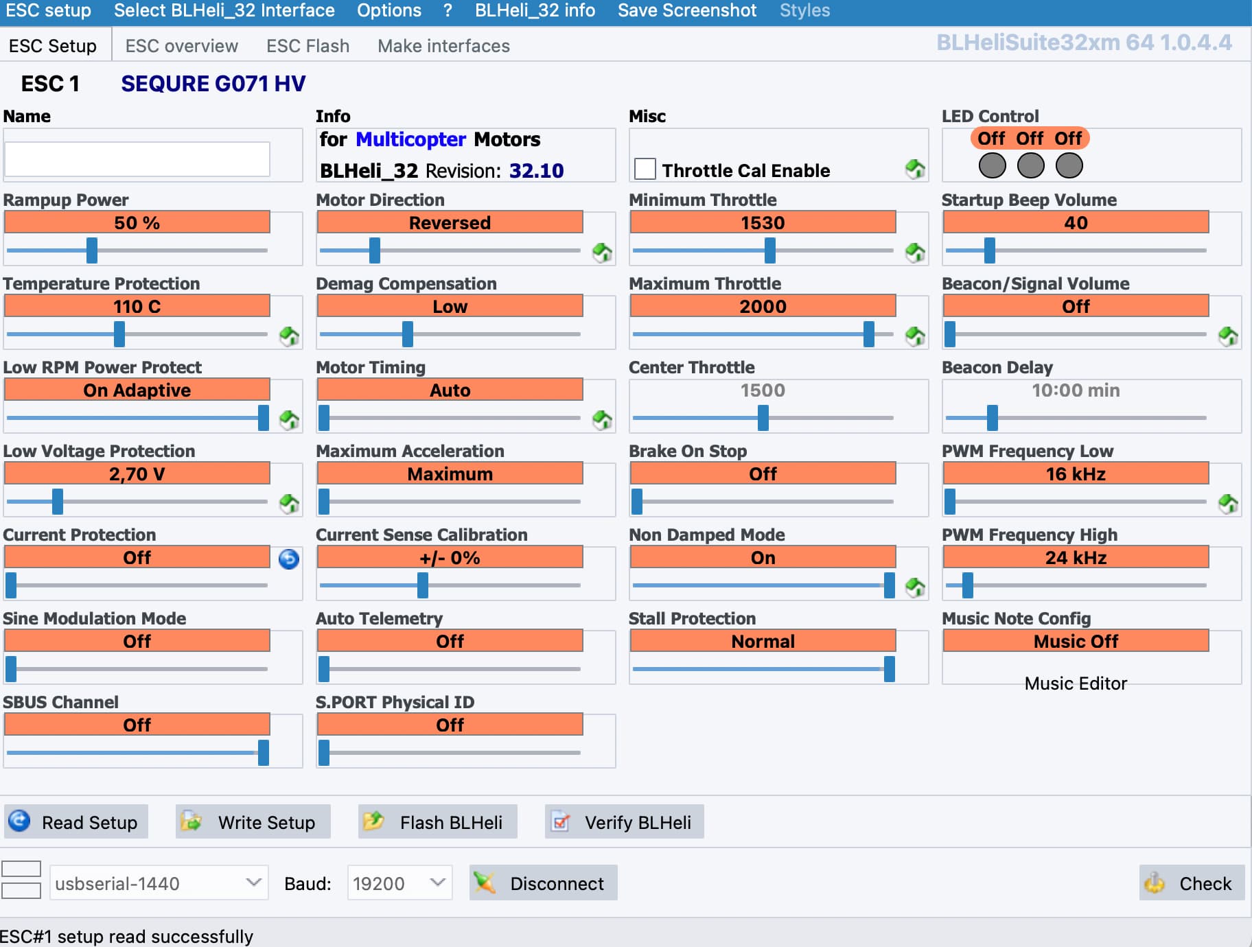

The sequre ESC is based on BLHeli. config is:

Maybe changing the acceleration from maximum to some other (lower) value will help? Or maybe disable non damped mode? Just thinking maybe the signal jumps a bit and triggers some over current error?

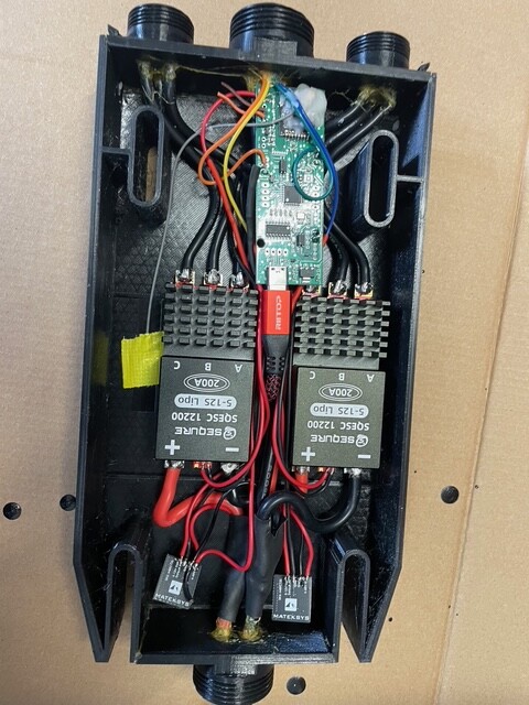

Have you tried to temporarily move the receiver away from the motor cables?
The electromagnetic environment just near those cables is quite wild and can easily interfere with the receiver. @ludwig_bre can probably tell how well filtered the electronics are but I think it can be a good thing to try out.

I have a dual motor Bremote setup with 2x BEC, and Iām having some issues with my right (Starboard) motor losing power after about 20 seconds being on foil. I also find that after surfing a long wave and Iām the marginal zone for signal back to where I left my boogie, that the same motor wonāt get power when the other is fine, so it goes in circles until I paddle closer to it. That motor that loses power is connected to the 10k resistor side of the Rx. This happens more frequently when battery is below 50%. Is there anyway I can troubleshoot this? Iāve ordered the V2 Bremote with external antenna, so perhaps that will solve all my problems and I should just be patient!?! ![]()
If you have intermittent connection, the PWM signal generation for the 2nd motor is also intermittent, while the 1st (original output) is smooth and constant until the failsafe sets in. Probably this behavior upsets your ESC in some way. What you can try is to put the throttle all the way to 0 and wait a bit, maybe even steer to the starboard side (make sure it gets 0 throttle)ā¦
Other than that maybe some changes to the PWM timing on ESC side or Rx side could also help

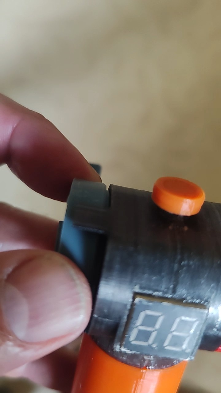

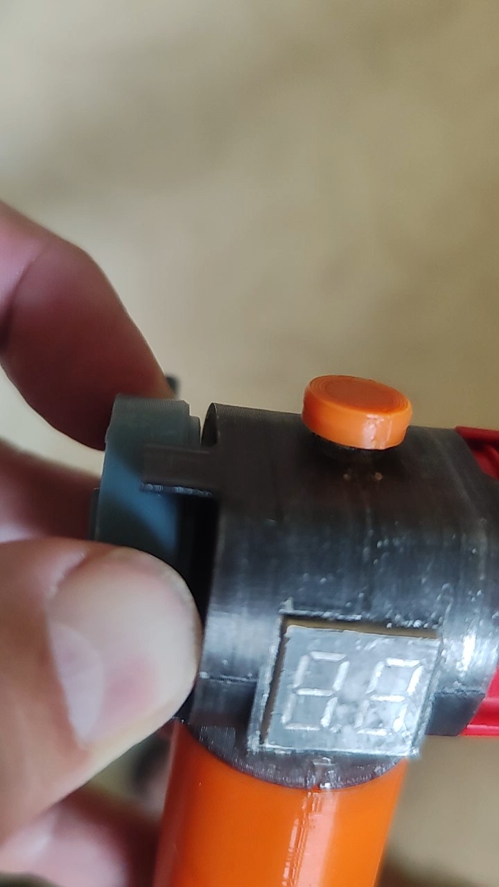

I have a lot of play in the trigger handle.
It moves about 2mm in and out.
It is still working but ā¦
Is it possible to remove just one side of the main body to replace the mag rod?
Or do You have other ideas/hints?
