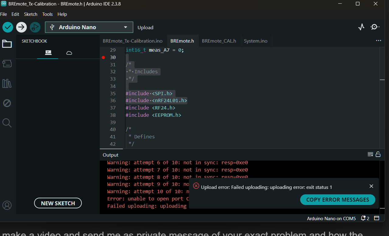

I cannot upload the Bremote Tx calibration for my old bremote v1, the remote keeps shutting off when I try. Any suggestions?
Hey,
It’s normal the remote shuts off (display) and only talks to you in the serial monitor

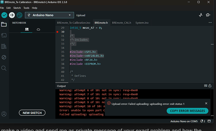

So how do I upload the files if it turns off??
Even if the display turns off, the remote should stay connected via USB?
How do I re upload the files if it keeps shutting off?
Are you following the video at 41:23 minutes?
Maybe make a video and send me as private message of your exact problem and how the remote is behaving?
It seems like Arduino can not open the com port… Make sure you actually selected the correct port (unplug remote, needs to be gone from the list, plug in again, needs to reappear)
Sometimes other programs can block the port as well, make sure to close all other applications, especially like 3D printer software.
Post the complete orange debug output as text here
