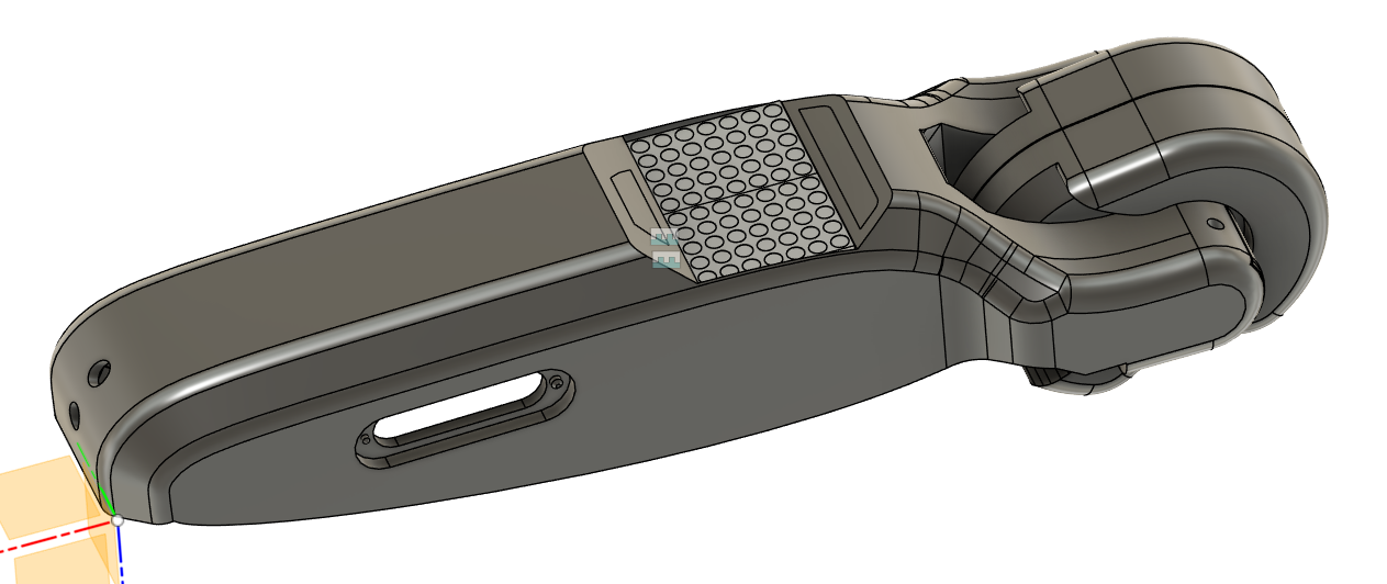

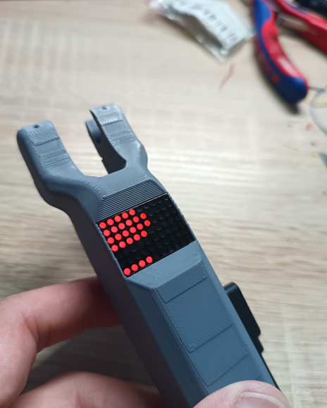

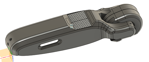

Small update on the Nano, I have been tinkering on a version that also has the “normal” display
If fits quite well and will provide more information that the LEDs
Furthermore, that means the hardware of “normal” and “Nano” remote are exactly the same and therefore the software can be too.

Nice!
Your first video had me seriously worried.
The fiddling with the leds alone looked like it would take me 12 hours with my skill level.
I also had considered to completely get rid of the display and to use an external device over ESP-Now.
Or just use my watch over BLE.
Would make assembly much easier and should also be much better sealed vs water.
You can get a complete display module done for like 2-3 EUR with one of these ESP32/Display combo modules.
