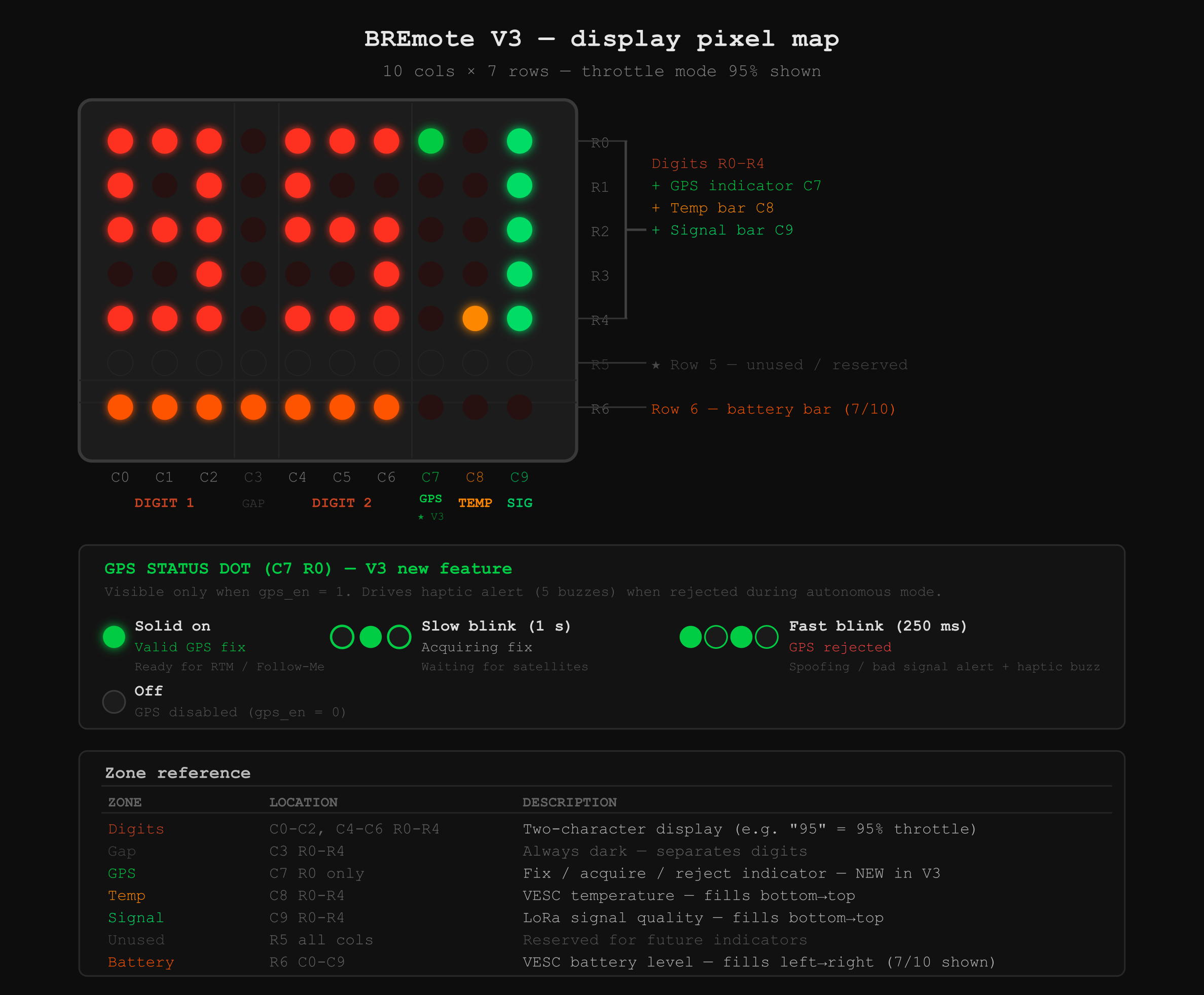

here is another preview of the working display.
