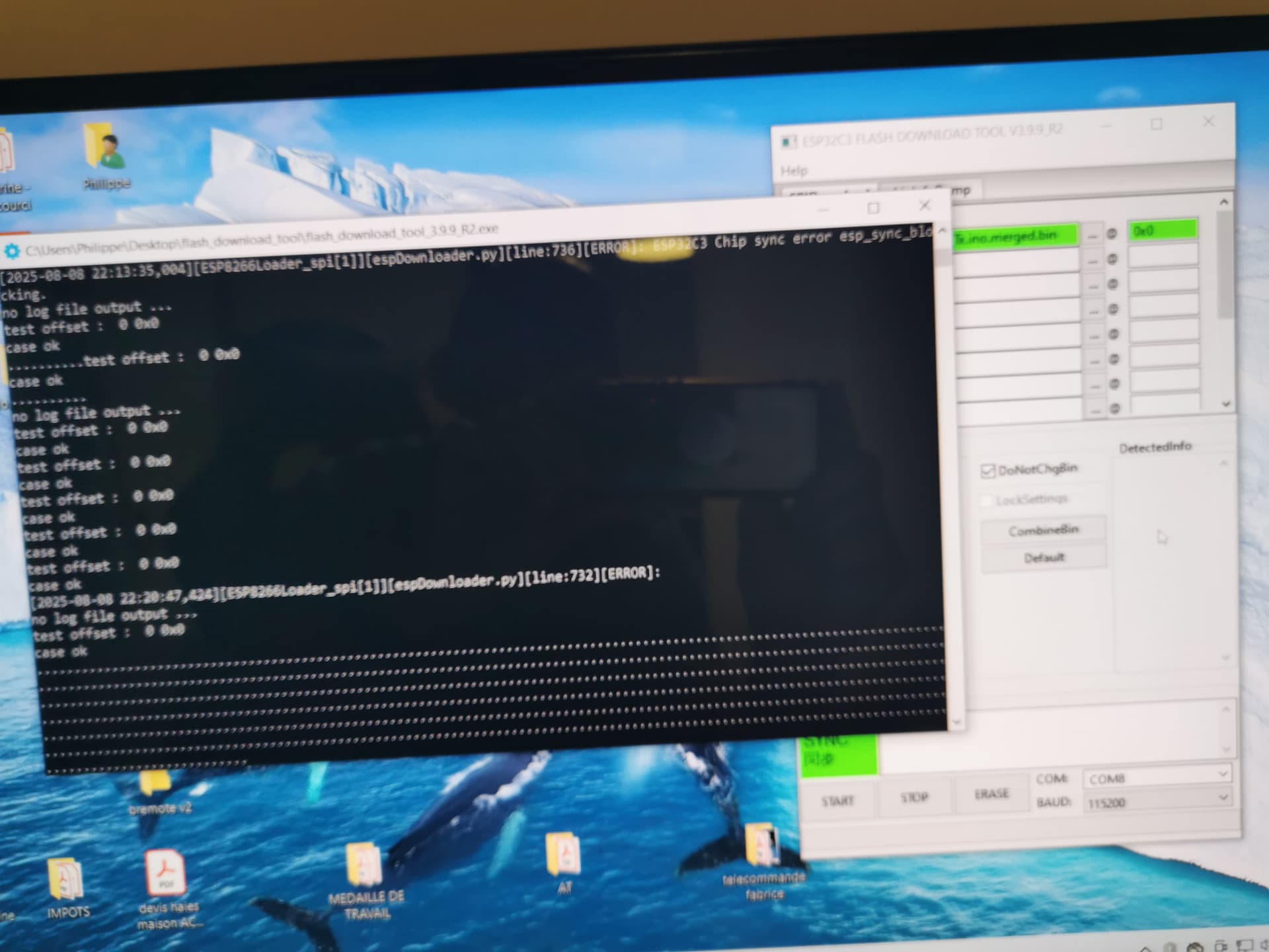

Since I haven’t received any replies to my emails regarding the electronic problems with my old remote control I received in early July, I decided to order a new Bremote v2. I’m installing it, but nothing appears on the screen. I’m trying to flash it, but this time, I can’t get the remote to start. If anyone can help me, please.

The flash tool at the moment can’t get any connection to the processor…
Please check the above points and report back

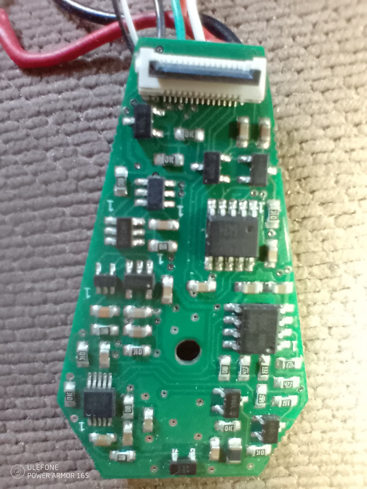

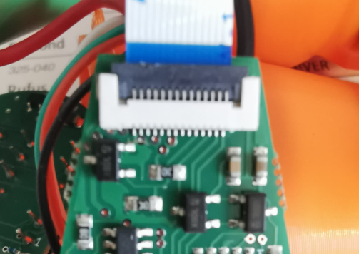

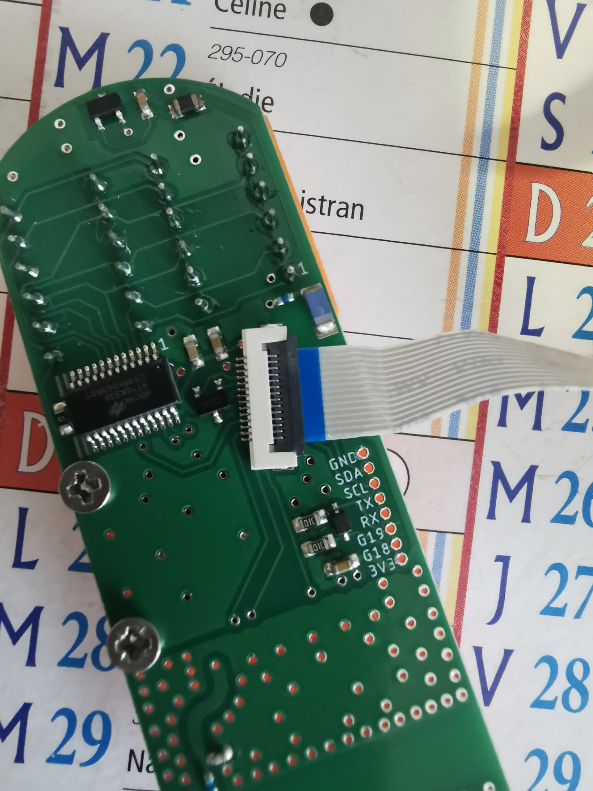

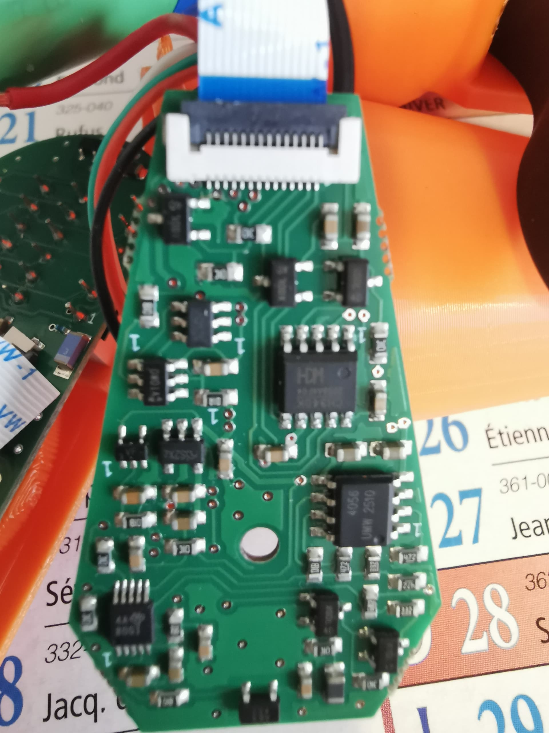

In that case there is a fault in the electronic parts. Please check that both ribbon cables are plugged in the correct way around. Also, can you please send me a HD photo of the connector on the bottom (coffin shaped) PCB?
the tablecloth is well connected fully in its housing and on both sides, here are the photos
The connector is incorrectly populated. It should be further back (up in the picture)
This likely creates a short circuit somewhere..
Please get in contact with Jasmin again for a replacement of both PCBs.
Please also check your inbox again, Jasmin already replied on 11th of July already to the last mail :slight_smile:
hello ludwig i do have the same problem here is picture of it do you think it can come from the same connector position,
