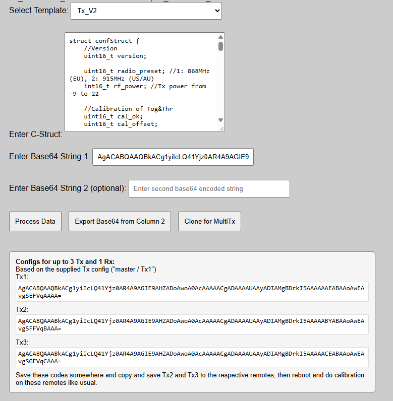

  4. Read out the conf_string from this remote (β€œmaster/Tx1”)
  5. Go to the setup page: LINK and select Tx_V2, enter string, Process Data, Clone
  6. You will receive the conf_strings for Tx2 and Tx3
  7. Send and save these strings to the other remotes
  8. Do the calibration on these remotes and you are ready to go!
Image of the output:
