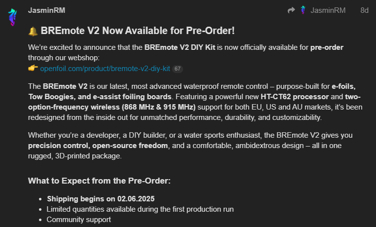

For sales, please check this post:
LINK

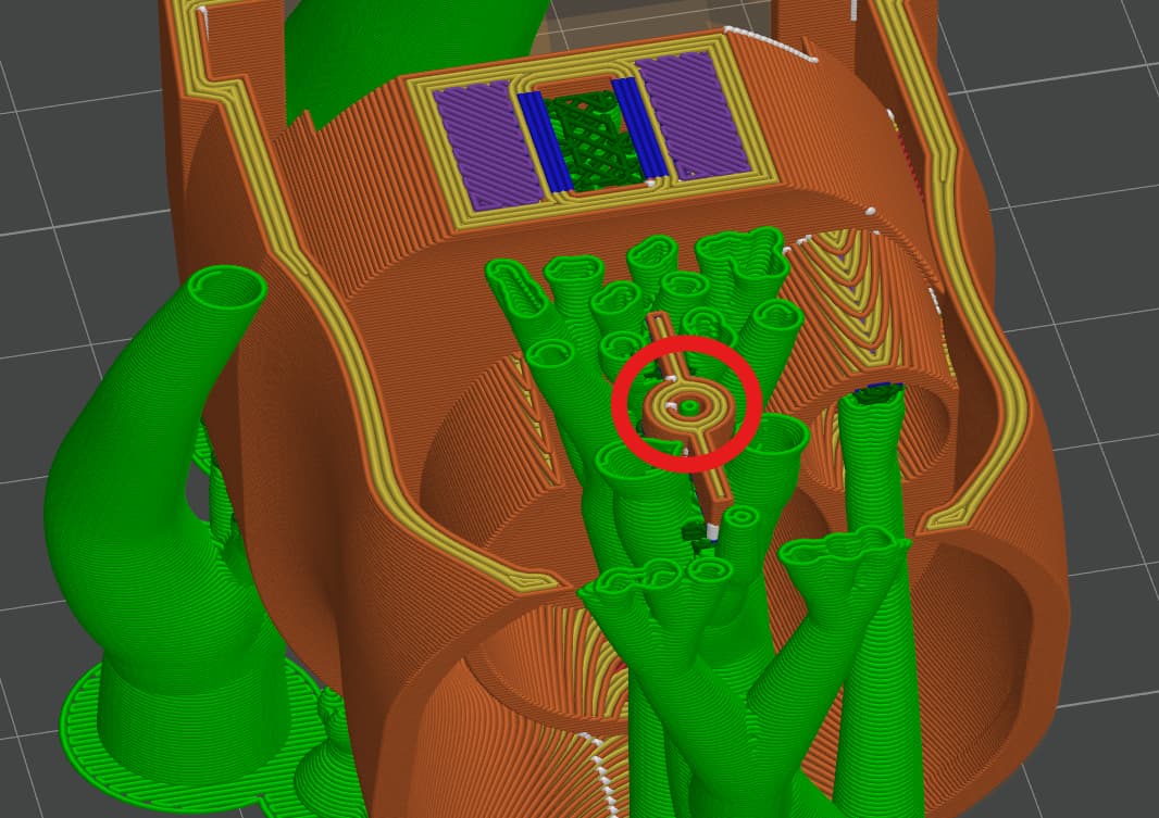

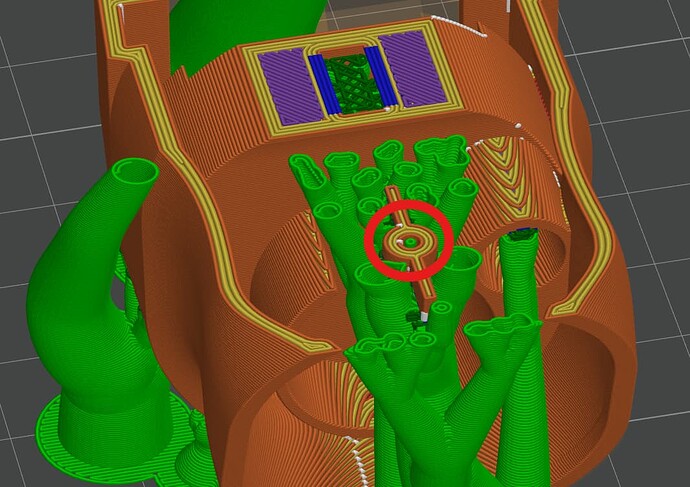

Just a small heads up to all who are printing the parts: Make sure there is no support in the tiny hole of the top part. I think i have to reprint mine because i could not get it out.
Did you use the pre-sliced files for Bambu studio? There I already put a support blocker exactly for that reason…
In the beginning I had this problem too. You can try to use a small drill bit to clear the hole and force the screw in afterwards, for me that still worked.

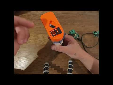

Hi everybody,
I have just finished the instructional Video on the V2
It includes the basic function and how to use the remote as well as how to configure and update software.
See here:
Also again, all other information can be found at the github page:
