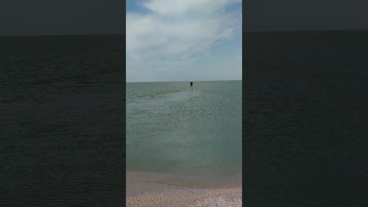

The purple departure of the “Black Cuttlefish” To the Sea of Azov! So far everything is working!
