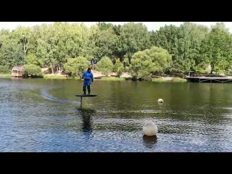

At last) Me and Anatoly met at Pirogovo wake park station and had test runs today
My board had large leaks, I did all I could to stop water flow inside) thanks Vitalii for test runs and first water come out of my board on the wing. Guys said that board goes stable) I ve tested their board it was my first time. All the feelings were similar with snowboard wakeboard etc until I got on the wing) cool feeling. I feel like I spoiled all this summer. I think I would spend all the summer in the water with this board)

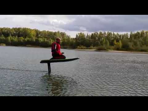

Hello everybody, after few attempts i started foiling

This weekend i spent with Anatoly on Pirogovskoe lake. Curious we didnt make group photo)
But we did about 10km one way trip. And on the way back i touched the sand with the wing and felt off the board. Battery shut down by short cirquit protection and i did SOS signal with my hands. Rubber boat resqued me
Dont know the bottom dont go to water)
Or spend time on the water at reduced speed, enlarge the navigation area step by step ![]()
Only press full trigger in areas you know.

Short circuit during a choc ? That is not normal. What if it happens again ? A zero might have touched a plus: you might have a battery design issue. If you have to rebuild your battery, just follow the guidelines shown here (cell separation, cell holder with plastic lip …) from @ludwig_bre , just one episode yet.
The more speed the higher the wing)
Thx for link i will go through it.i think yes something touched + to - and bms protected battery. It happend once.
And for some reason my cruising speed is 20-25 km/h and my collegues boards are little faster about 30kmh dont know whats the reason. But they looks like the pirates when reaching me and im like a trade ship haha
I have standard propeller 7 inch, and collegues tell me to cut it to 5 inches. I didnt have opportunity to test their boards
We have a maximum speed of 40 km.h, and I ride a maximum of 35 km.h. It hurts to fall higher!
