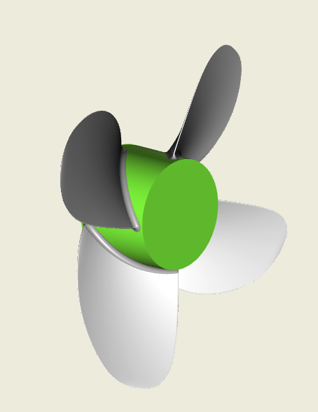

This web based free design tool is very good. Go to the geometry tool. It takes a few trys to find the correct parameters for thickness etc. Pitch is entered as a ratio of P/D.
You can export stl or step
Yeah…nah;
Thanks! Looks OK. Maybe not optimised for smaller lower power propellors, but able to get a shape. i think I would want to thicken up the blades a bit for 3D printing.
Can you elaborate on your cad process?
In the direct geometry editor you can thicken the blades and tips etc to your liking. Also possible to delete faces in cad to make a 2 blade.
