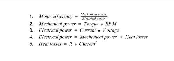

So basically, for max mechanical (output) power → aim for 70% or so from free spining rpm
For max efficiency-> aim for 85-90% of free spin rpm, but you’ll only be getting half the max mechanical power your motor can deliver
I didn’t find those numbers there?
Crude reading from the graphs:
So max mech power at; 5500/9000= actually 60%
Max eff at 8000/9000 = 90%
Efficiency depends on a specific motors’ losses so data can’t be used generally like from that diagram.
An example can be a motor with thick laminations but a hand wound rotor with max copper fill, efficient at lower speed, higher load/current.
Or the opposite, a motor with thin laminations but poor winding, efficient at higher speed, lower load/ current.
