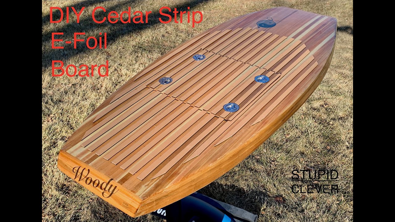

I’ve been lurking here for a couple of years. I started a new foil zone login linked with my youtube channel just recently. I spent the fall building my own version of an E-Foil board using a Cedar strip and fiberglass method used for Kayak and Canoe building. I painstakingly documented the whole process and just posted my first two videos on the build with the following links:
I look forward to constructive criticism on the build and guidance in selecting the propulsion system and battery components in time to launch the board this spring. I am offering the challenge to the group to suggest the safest and least complicated build components for a true beginner to E-foiling with basic cruising performance and ride time of up to 20-30 minutes.
Question: Is the Maytech E-Foil kit a legitimate option? (motor/ prop/ waterproof ESC/ remote for around $1200) If this setup is truly plug and play, I would consider the cost worth it to simplify build time and engineering.
I extend my sincere thanks to you all well in advance for your help and good advice.

Nice looking board!
If you buy the components individually you can get them cheaper and also get much better props.
Looks awesome!
Yeah I agree with Jezza.
I have been using a maker-x hi200 ESCs and it has been working pretty well: Go-FOC HI200/HI100 4-16s 75V 300A electric Surfboard Electric Motorcycle Electric kart bicycle ESC VESC - MakerX
A couple other brands sell the same ESC, some with watercooling attachments if you have a pump.
Flipsky, reachertech, maytech motors are all the same except for some shaft size differences. So I’d get one wherever is cheaper.
Maytech remote is probably the best commercial version currently, but there may be some more coming out in the next few months
Prop from flying rodeo is great if you can get one.
All that should still be cheaper then 1200.

Yes I am in Colorado! I’m just down the road in Boulder. I must have overlooked your build on the forum. It never occurred to me that there might be another local builder doing this. It looks like your setup has been very successful. Your Schrader valve idea is BRILLIANT! I figured I would have to wait until spring to try to test the water tightness of the board, or at least find someone with a really big hot tub!

Love the design. Interested to know what the weight is of the board
The board alone is about 21.5 lbs or 9.75 kg. I don’t really know what to compare it to, but I’m sure its a bit heavy compared to a carbon board. I built it large. It’s a full five and a half feet, similar to a lift “cruiser” board.
