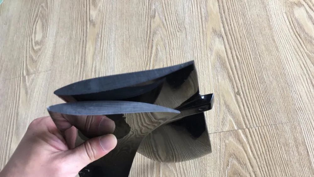

Ouch! How did that happen!?! So much for Bomb proof!
