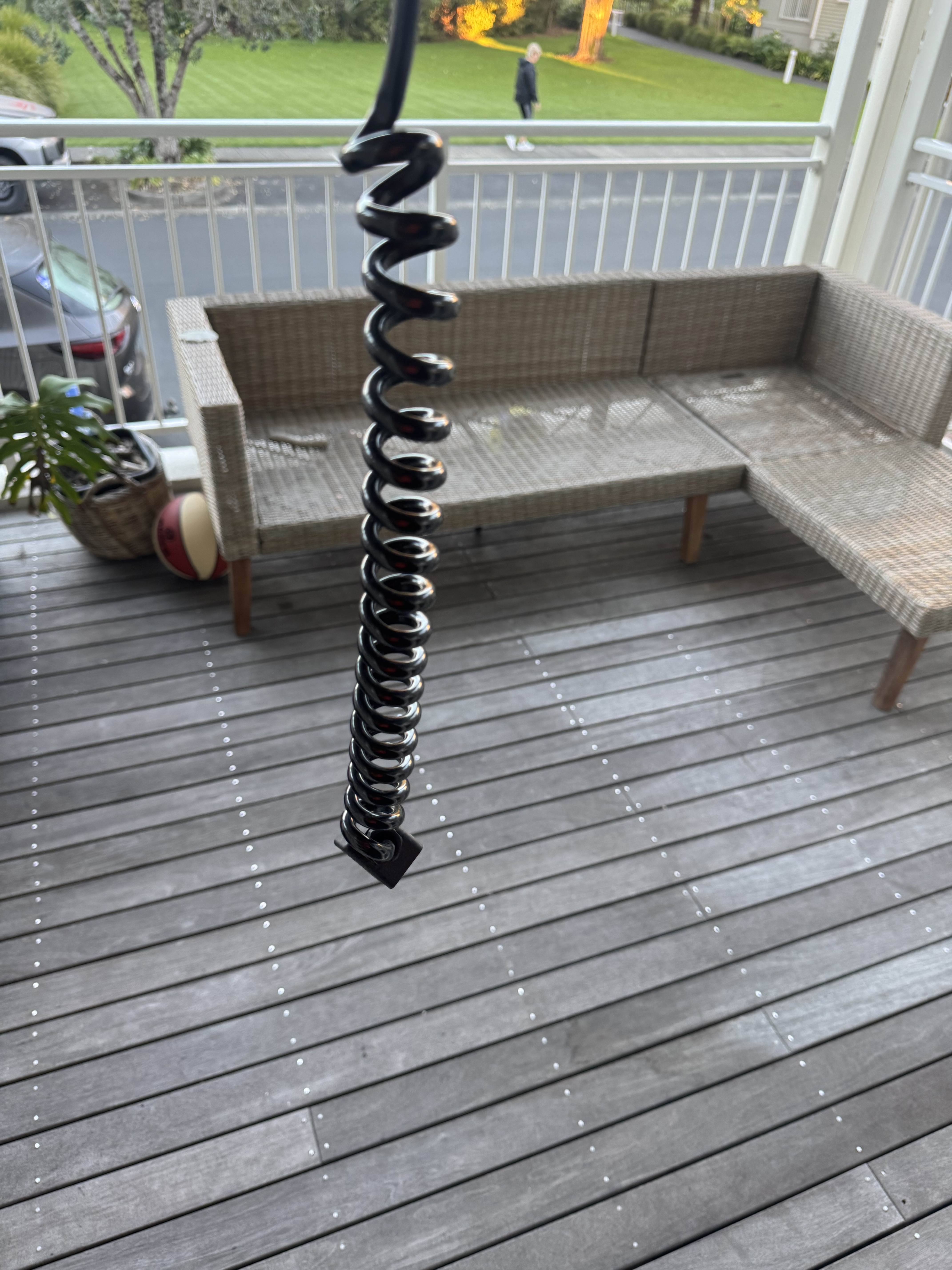

Coiled cable for backpack style foil assist
Researching some options for making motor to ESC connection with spiral cable, for the backpack style of motor assisted foil.
There are some cables with polyurethane jackets TPE-u
Or TPU I am not a material scientist, but it looks like this type of polyurethane is thermoplast similar to material for 3-D printing. I tried to get one these cables wrapped around a pipe and put in the oven for 20 minutes at 120 C. It’s coiled nicely and was holding the shape but the conductor number and size is wrong
This TPU material is way more robust than standard PVC.
I am currently struggling to find single cable with x3 core of 4/5/6 mm2 conductors with soft multi-strand copper.
The cable has to be about 2.5 m long, so 2.5 mm² cable like Foildrive use not going to work on that length.
The idea is to run safety leash inside the coiled cable.

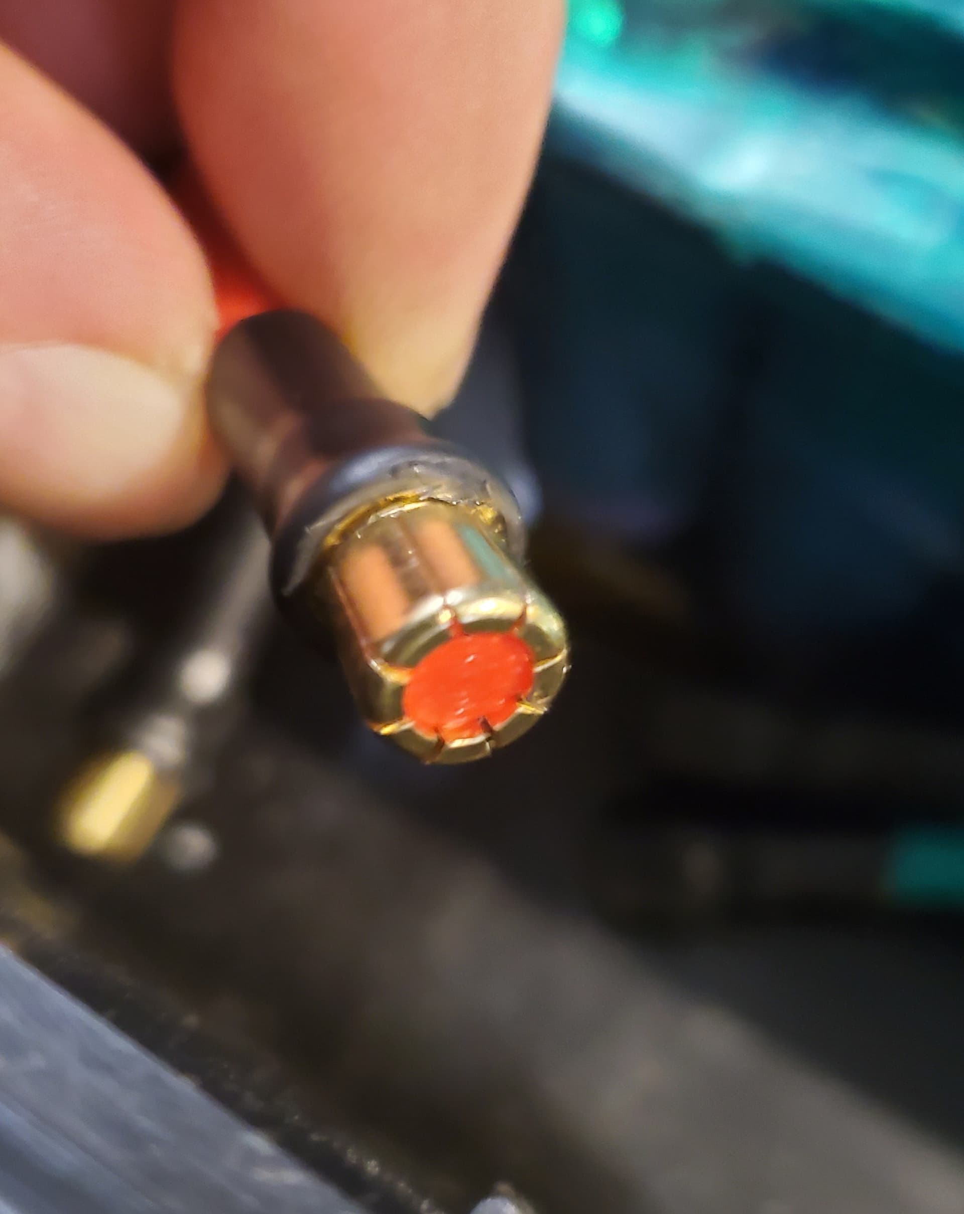

To connect the motor pod to the hip box cable, I built connectors from 5.5mm rc bullets.
Link to my build: Daniels assist (3rd build)
I would recommend using printed cylindrical TPU cores in bullet-type connectors. Over time and temperature, the brass tabs shrink, and the contacts can become significantly loose. Cores prevent this.
Yes, or use a cutter knive blade to bend them back when they lose tension and get loose. Worked for male xt90 contacts.

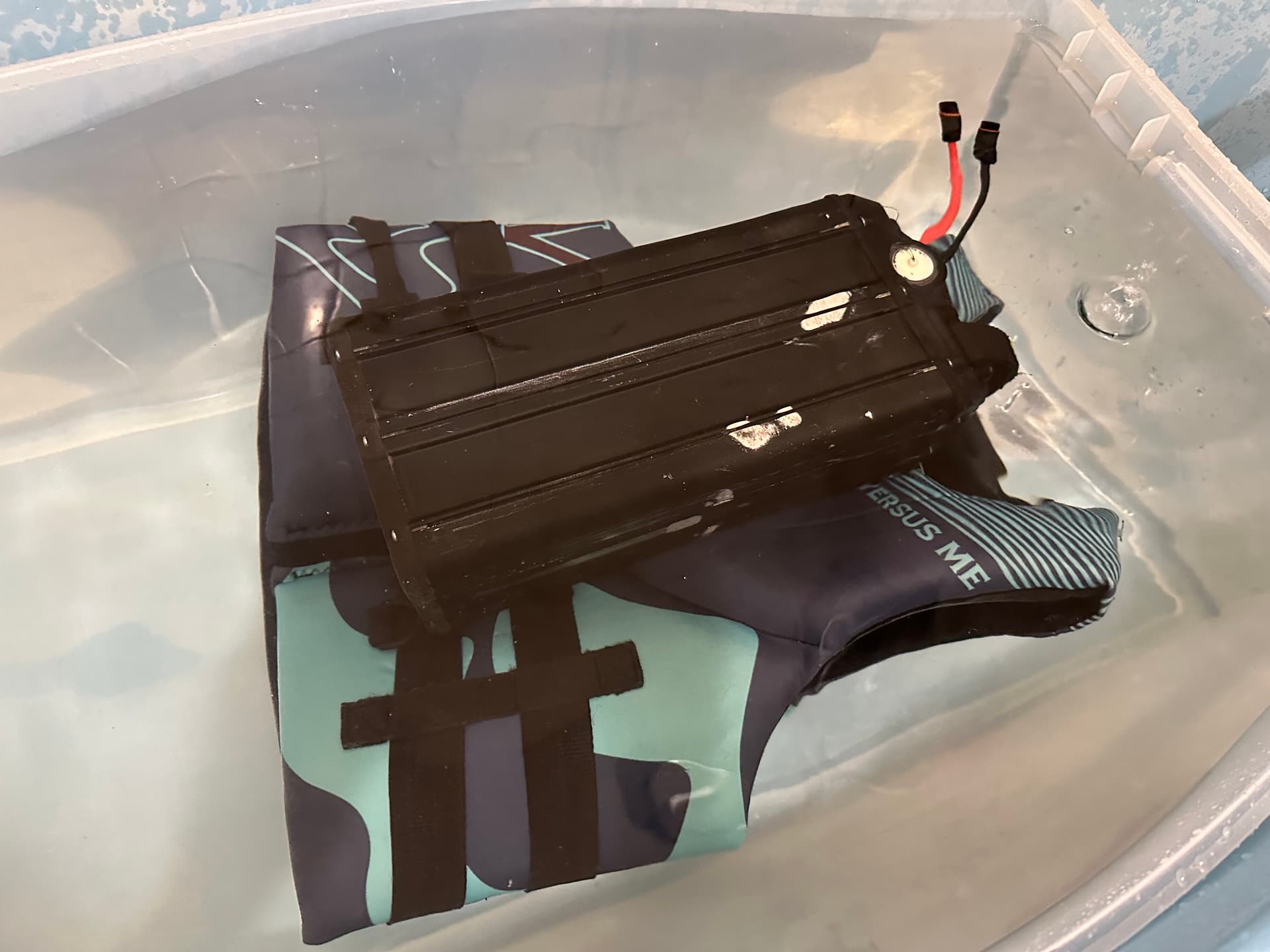

Buddy, that’s really dangerous. If something happens, like you lose consciousness during a fall or get an electric shock, that heavy battery will drag you to the bottom.
That’s why you wear a PFD. If you don’t wear a PFD and get knocked unconscious you going down regardless of batteries.

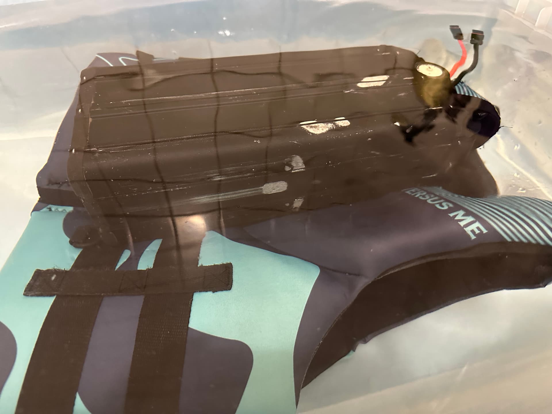

I strongly disagree with this! A PFD is designed to keep a person afloat, not a person with a heavy battery strapped to them.
I actually tested my battery with a PFD just out of curiosity, and it went completely underwater. Even if your battery is lighter than mine, this is still seriously dangerous. Please don’t risk it.

You took a 50N rate PFD (that provides 5kg buoyancy) and put a 10kg Surron battery on it and then claim you proved a point it sinks.
