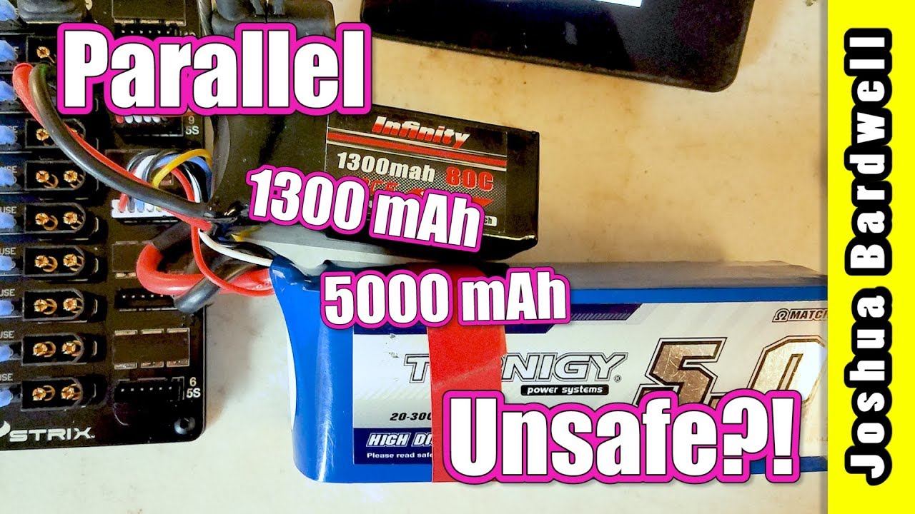

Your batteries are the same capacity and voltage so it should be okay, but the beepers are a good idea if on of your batteries degrades faster than the other.
Connecting different capacities in series is not a good idea. Different capacity batteries can be connected safely in parallel, this video explains it pretty good. (how batteries connected in parallel work)
