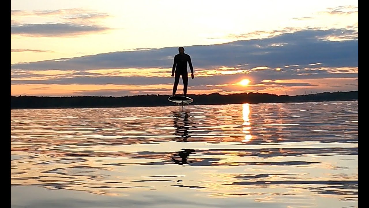

Project is done ![]()
Low Cost Converting an Indiana Wingfoil board into an E-Foil board.
Charging time: 45min
Travel time: 55min
Board: 128l Indiana Wingfoil
Motor: Maytech 65162 / 100KV
VESC : Maytech 50V 200A
Foil: Gong Allvator X-Over XL
Battery: 30AH, 1.5 KWh, 50V
Charger: AC 230V / DC 48V / 42A with BMS
Part 1
            Very interesting design. how is it holding up? seems like the weight distribution in how you split and located the battery packs is a big plus. nice work!
some advantages - but one disadvantage is 2x battery handling 2x BMS cable.
Otherwise the E Foil was built quickly and cheaply.
The VESC housing made of stainless steel (100% waterproof) has good heat transfer into the water.
The telemetry and the driving signal come to the controller via the plastic window (unbreakable Lexan Sheet) at the rear.
