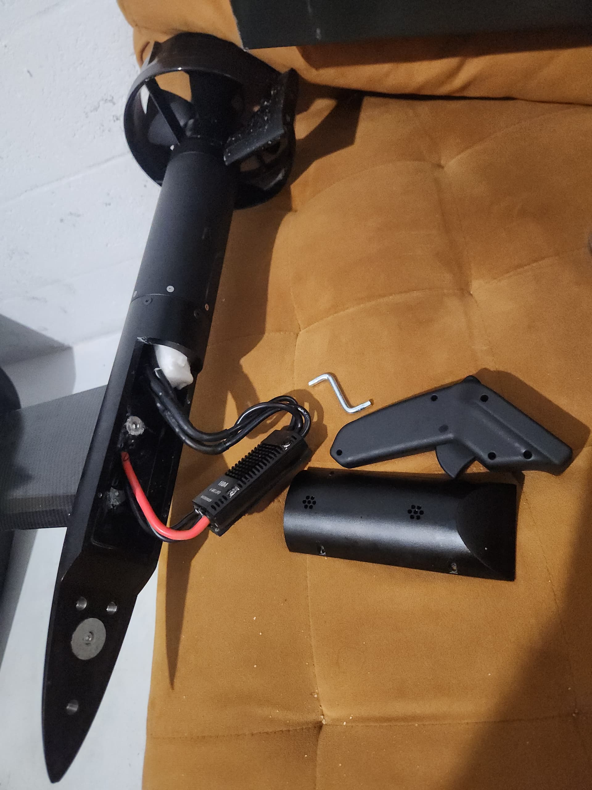

Then I disassembled the lower part (the wing, or the leg—what’s the correct name for it?)
And found this kind of mechanism there—
614S LIPO 160A - Is this a motor? There seems to be a slight burnt smell… Could something have burned out in there?
How can I check?
I have a multimeter. Which wire should I cut, what should I connect to what, and what should the reading be?
Is this the problem? Is it the reason it won’t run?
Can it be repaired separately? Can it be replaced? Can it be replaced with something more reliable? What’s the cause of the failure?
P.S. special thanks to the creators of this forum for making the post without media, because “An error occurred: Sorry, new users can only put one embedded media item in a post.”… :woman_facepalming:
The part with the wires is the ESC, it is the motor controller. 14S means input can be max 14x4.2V ~ 60V.
It can be replaced but it need to be the same (or one that fits with the same specs) and it might have to be programmed first to fit the system. Reason for failure is hard to say but likely water ingress, as it is built into the fuselage, which is below the water line.
Best would be to get a replacement part from the vendor. If that is not possible, replacing it with a diefferent ESC that fits might be possible but not easy without documentation.
