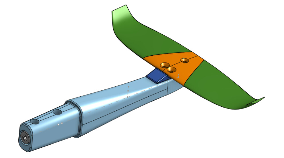

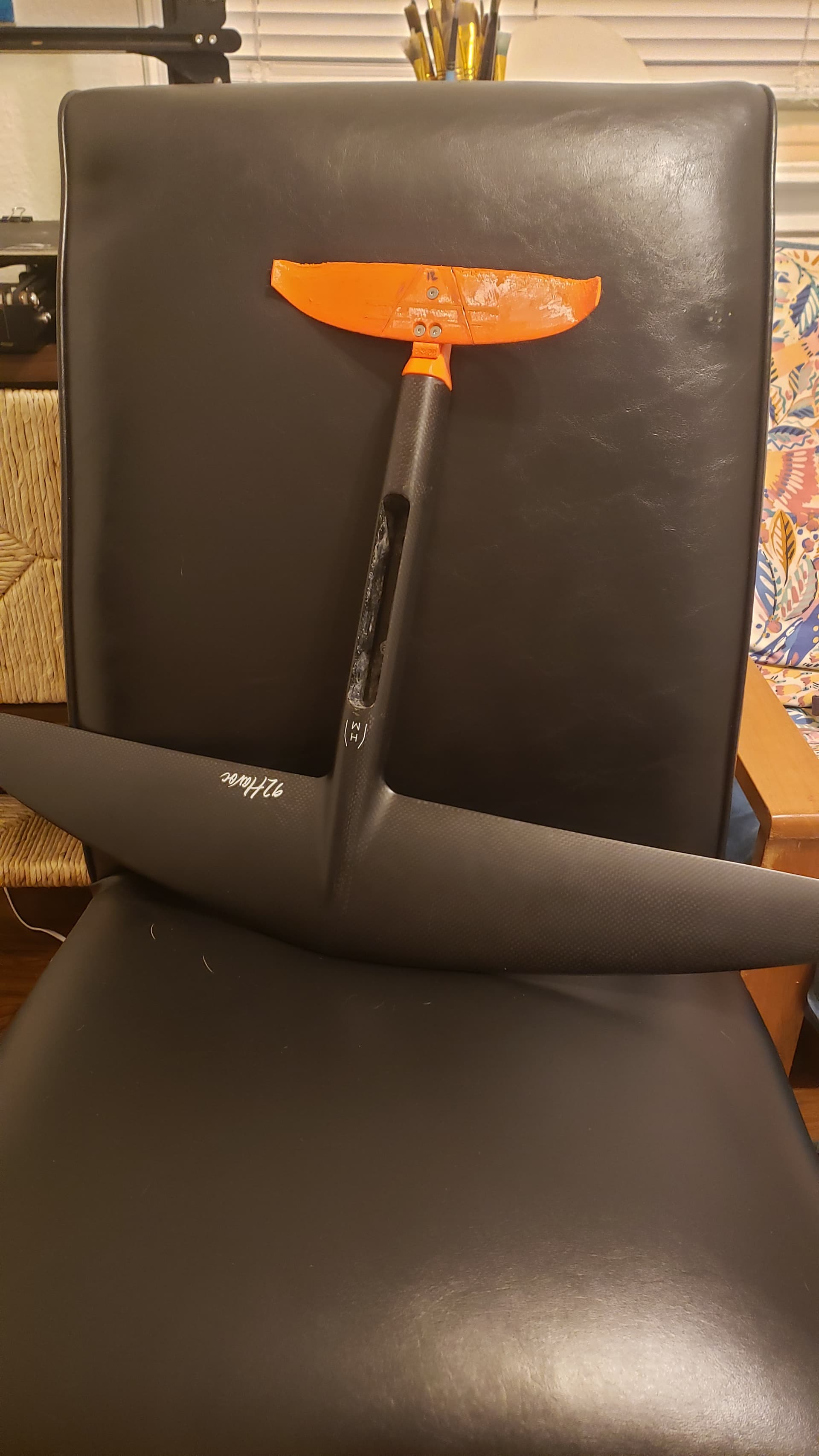

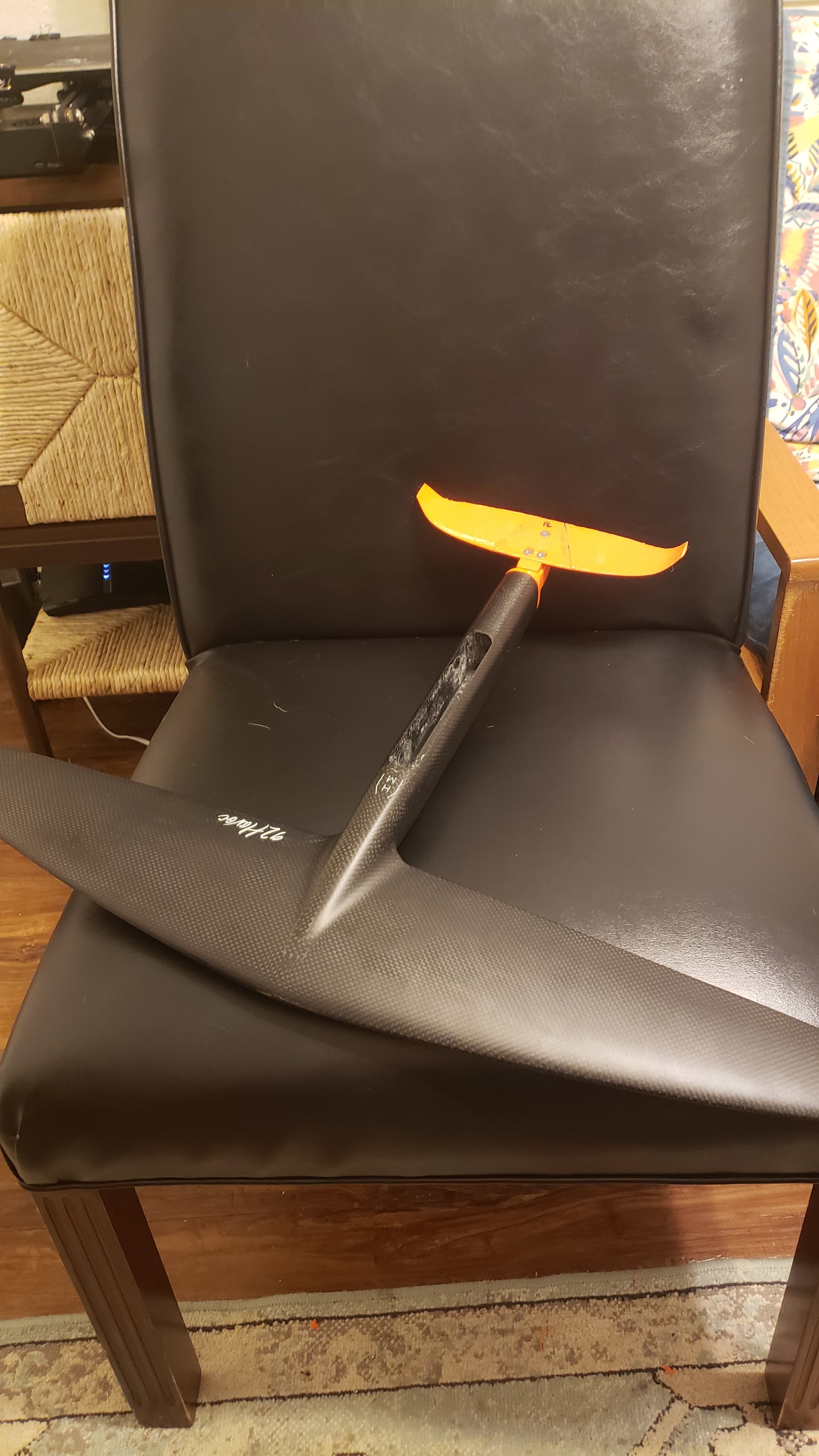

Greeetings everyone, been a little bored with the wing setups I had on the efoil and wanted a way to make custom ones for improved performance.
The parts are made to be simply 3D printed with easily available carbon fiber tubing epoxied inside for the strength. Same for the tail wings, there is a carbon spar that is inserted inside the airfoil for most of the length.
My goal is to keep reducing the size of the stabilizer on the efoil until it is just crazy maneuverable. Eventually I want to ride without the stabilizer like those crazy pump foils guys!
Mostly this is a way to get the heavy 70lbs board to whip and maneuver like one that is 40lbs or lighter, using the power of the wing and not just pushing the board around with body weight.

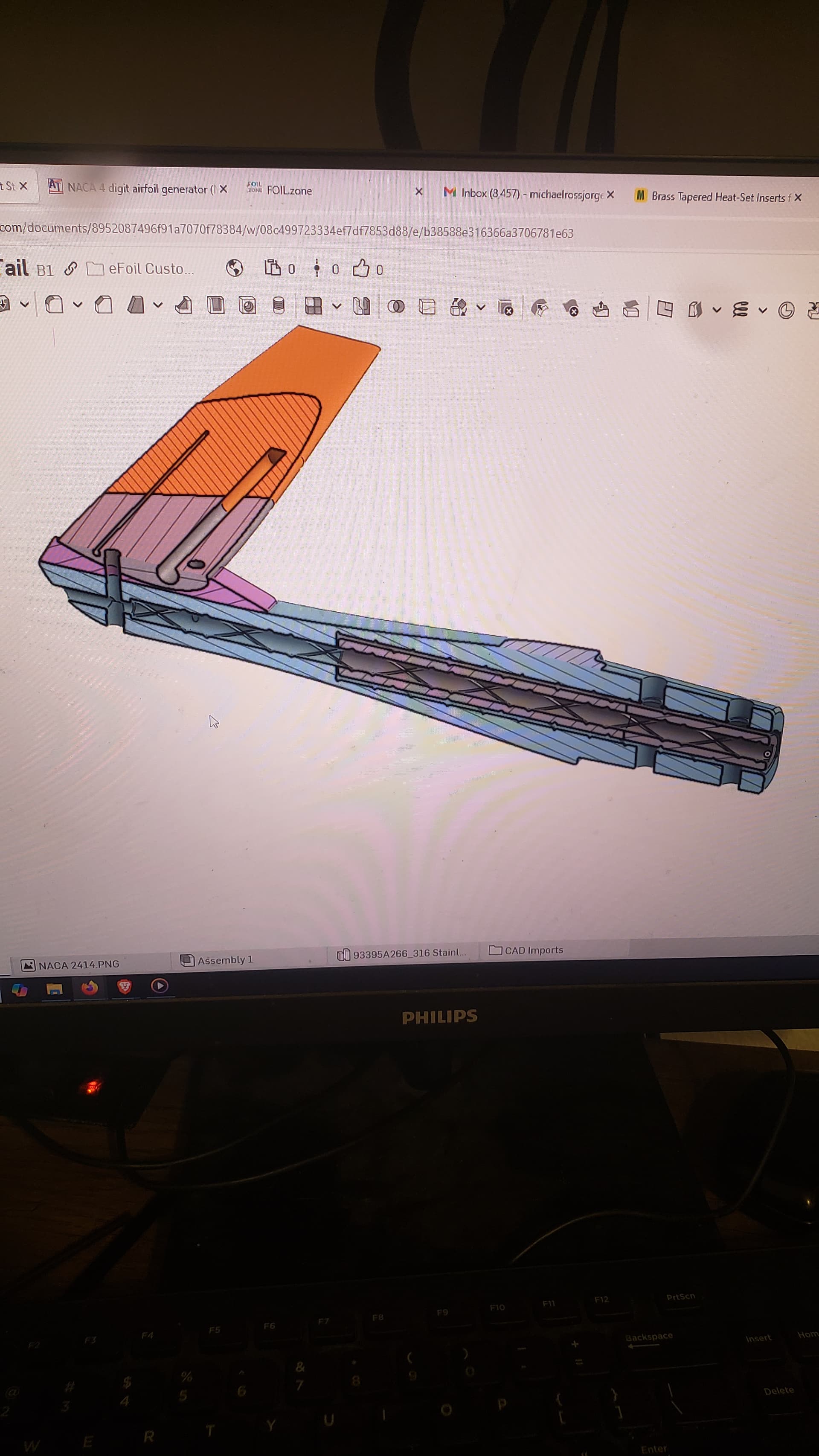

CAD is available for download and your own edits with OnShape. Happy to answer any questions about the build. Fuselage is nice and parametric but OnShape sucks for drawing wings so those tend to break.

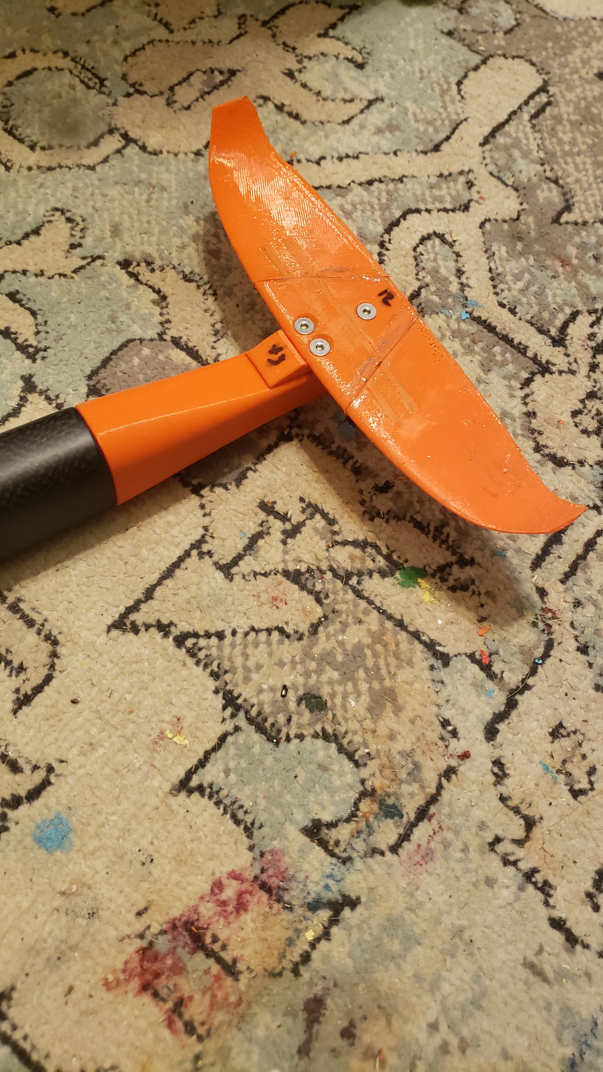

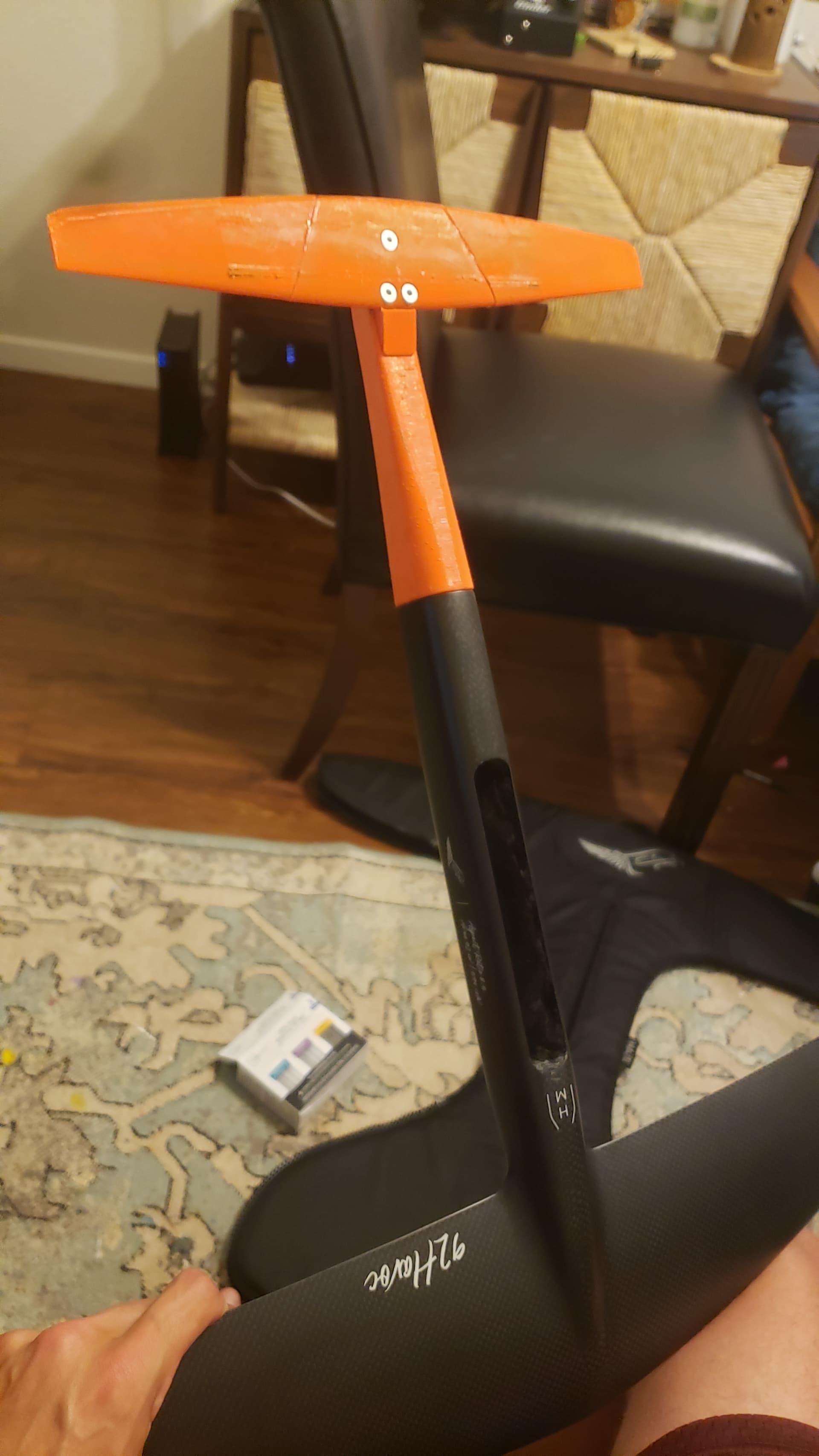

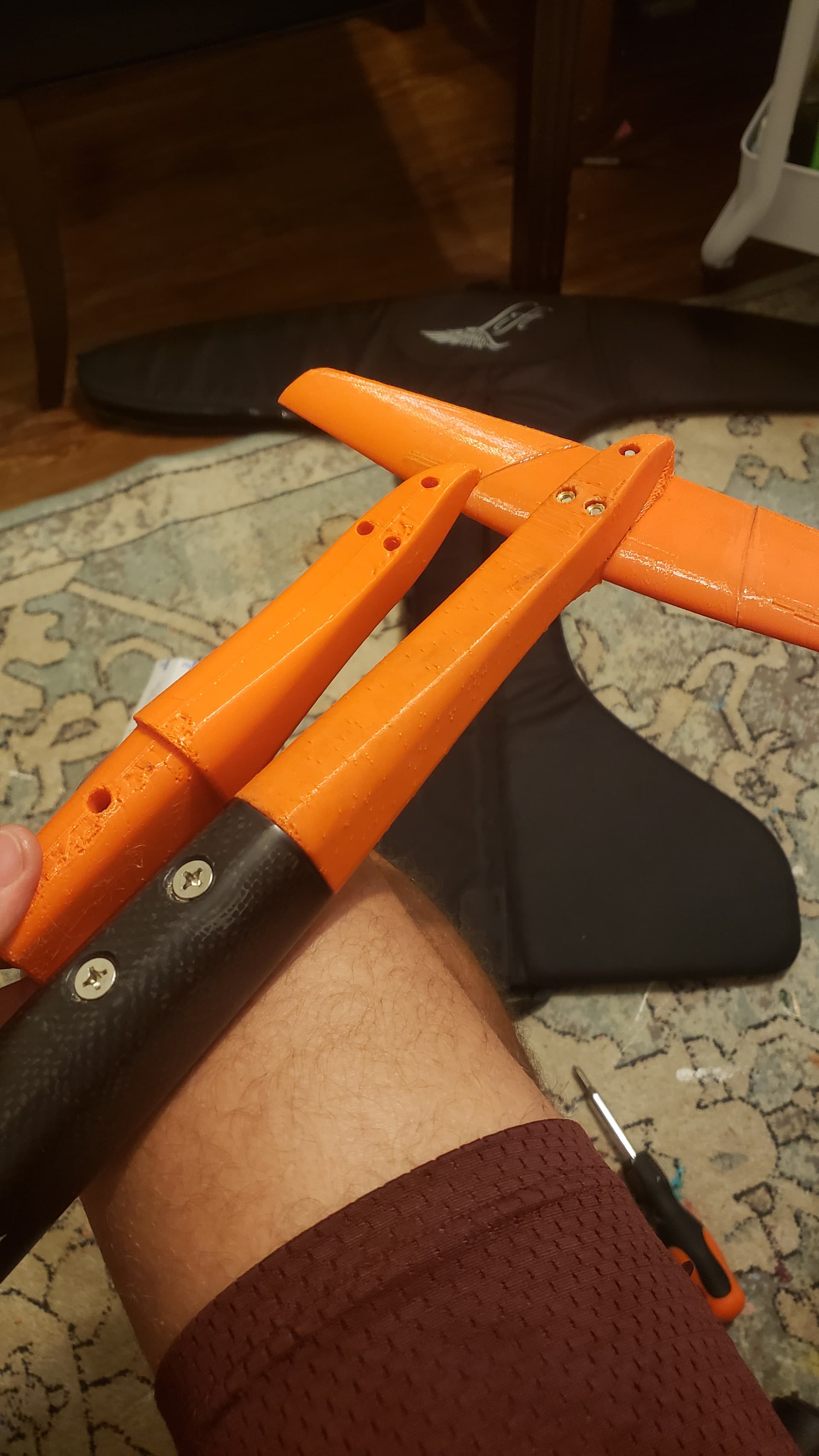

Been working on refining the design, have first build proto complete!! Will test this weekend but I think it has a high chance of success.
The model I shared can easily be adapted to work with any brand rear stabilizer wing. If you have one in mind let me know and I can help get it drawn up!

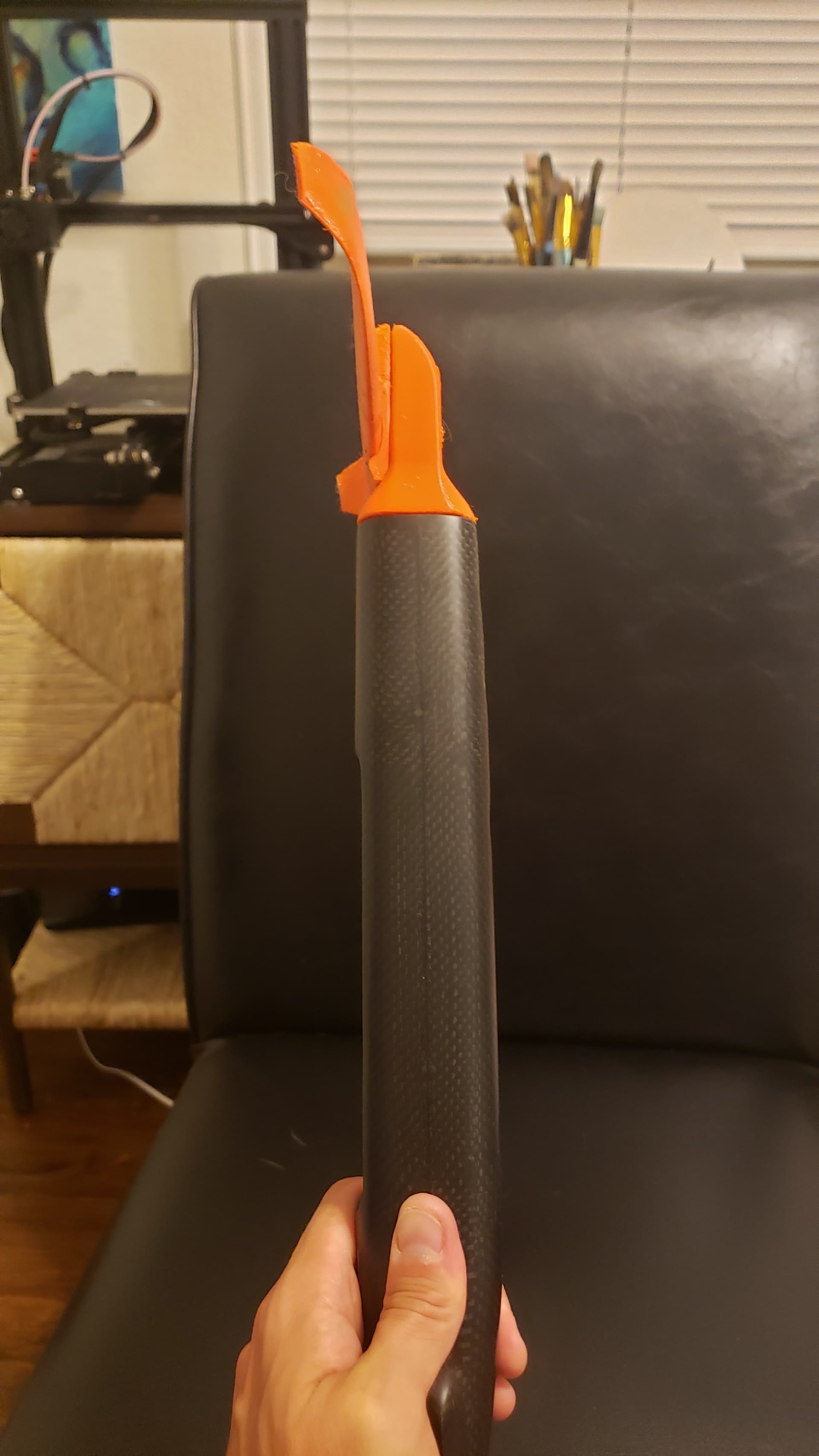

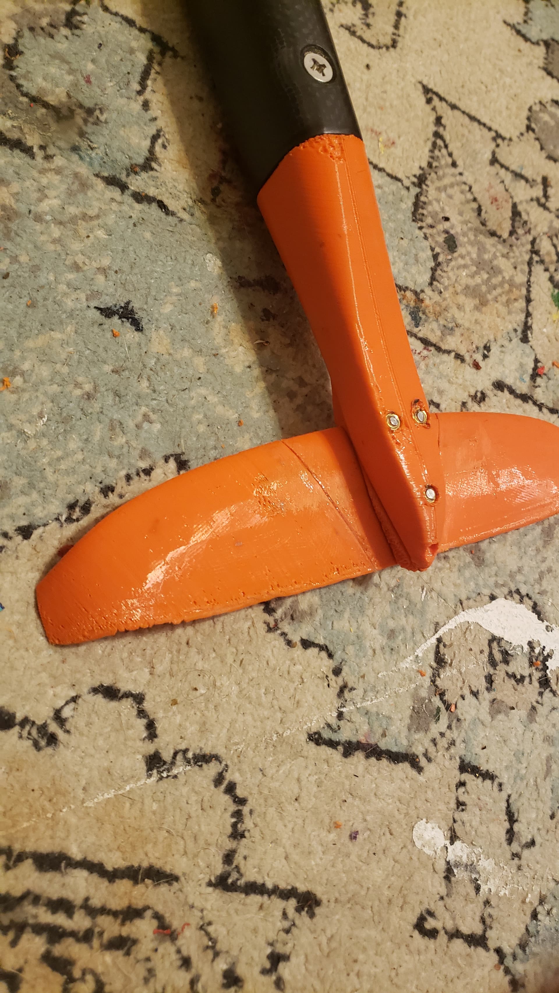

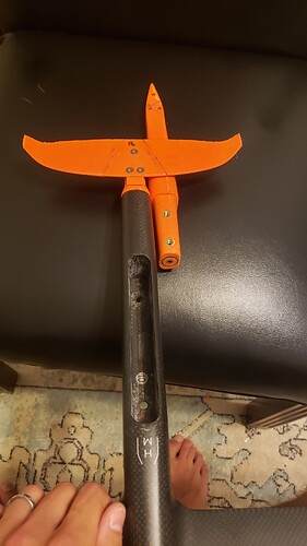

introducing the 12sq in Carve tail and the psycho short equivalent tail piece!! have a bunch of shims to test with both wings and tail lengths. Should be fun. Working on a super high aspect tail wing like the crazy axis skinny models, in the 30 sqcm range.

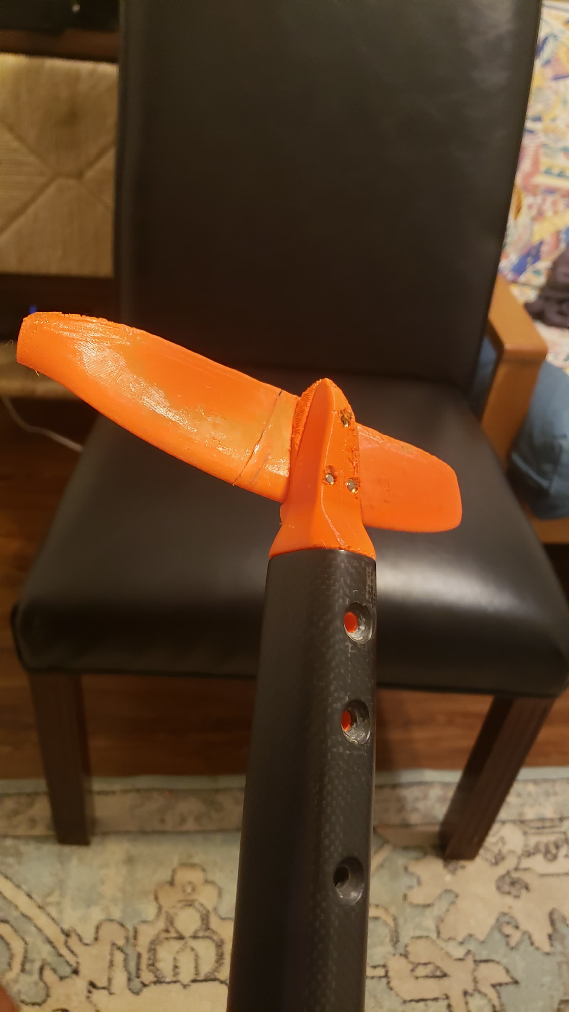

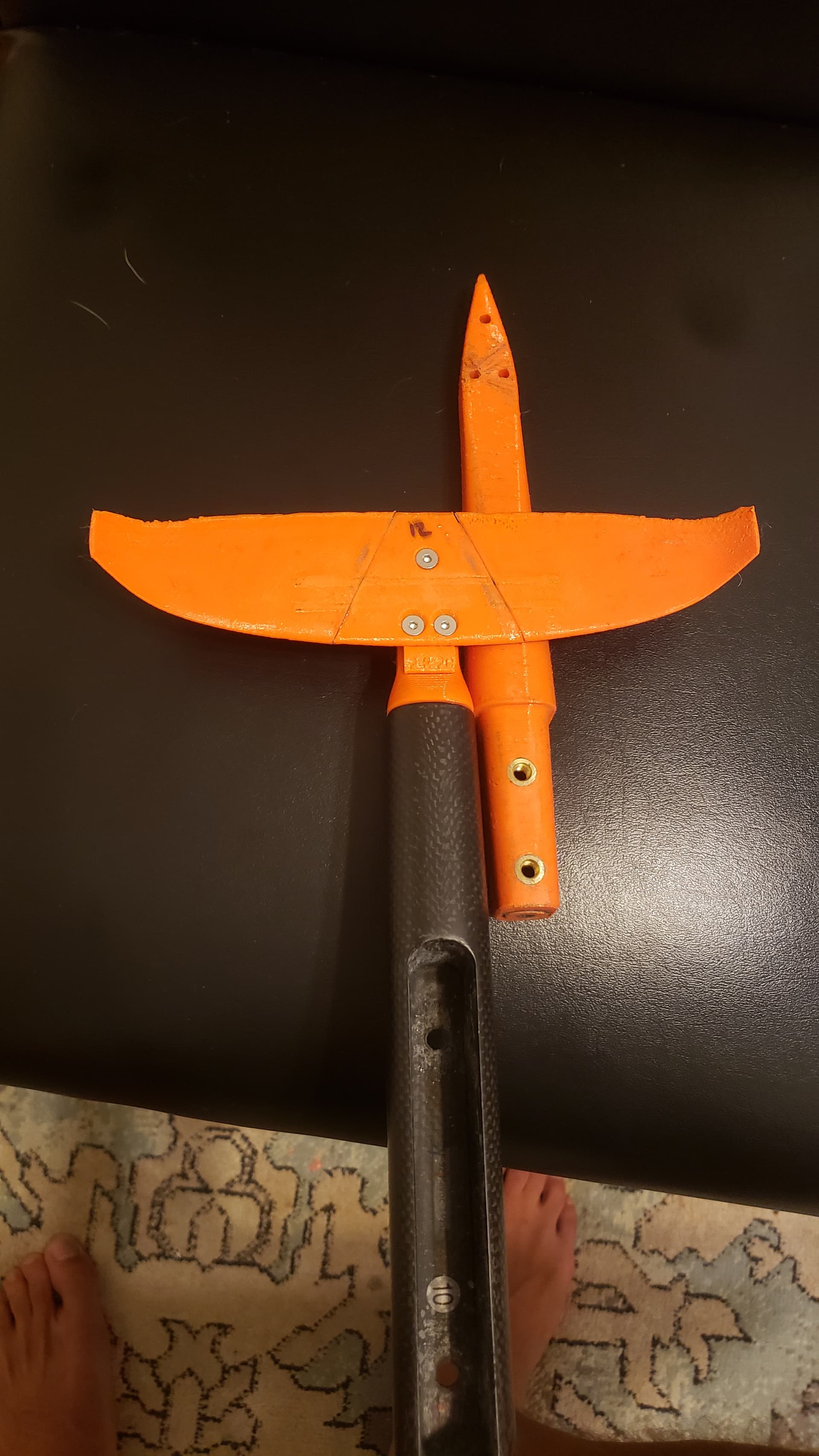

Got a little crazy with it, introducing what I call the clown car tail! 20mm to the front of the tail wing from the back of the fuse. About the shortest reasonable distance I can make it.
The 12 sq in tail is modeled after the carve series from Lift.

CAD model has been cleaned up and now rebuilds cleanly when changing tail length.
