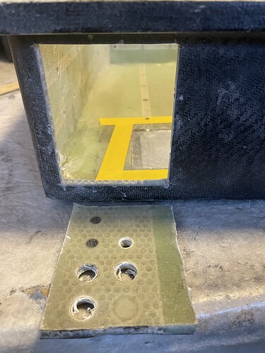

Instead of cable glands and couplers, I installed female flanged sockets directly to the battery/ESC Box. I cut out a part of the box and glued a part with inserts to match the new sockets.
