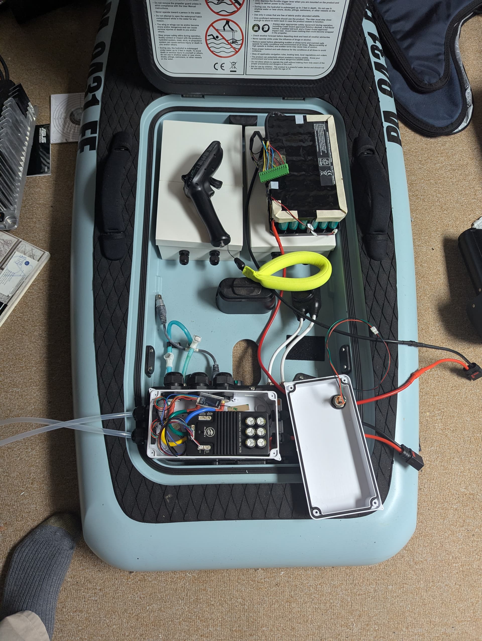

I own a Lift 3 myself. It works, but the underlying predicament is obvious. Following the advice from people in this group, I’m now running a third‑party setup: an ECS eBox with a compatible receiver, plus a third‑party battery and hand controller.

Cool! Rebuilding a lift to a Vesc system is definitely appealing.
