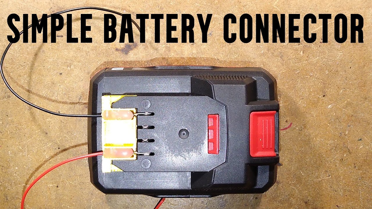

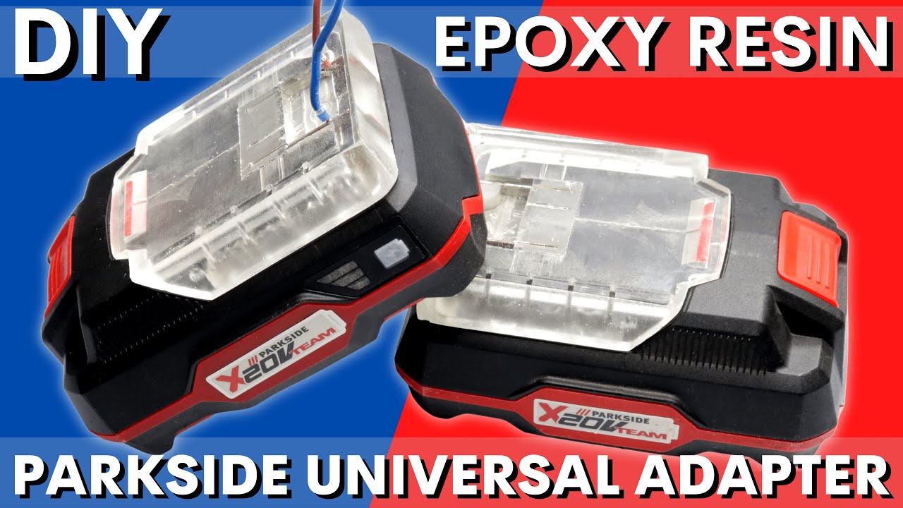

Looking at the 60€ PARKSIDE 20V 8AH battery from LIDL based on 21700 cells, it is easy to cast multiple adapters following YT tutorials.
