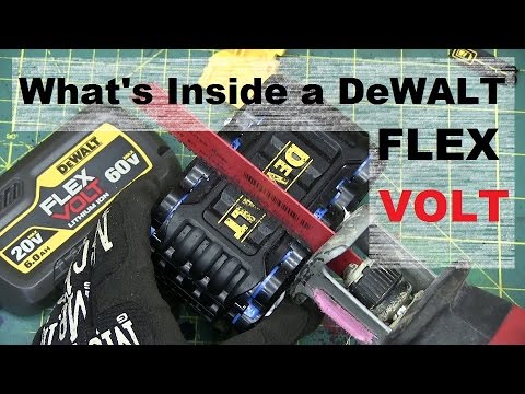

This might give you answers.
Summary of the teardown video posted by @Toto44:
  1. The DeWalt 60V / 20V has a mechanical switch, triggered by the cleat on different tools.
  2. Pulling 60V (without tearing it apart) would require some trickery. At 60V, it senses the tool differently and won’t give you more than 20V.
  3. The winters appear to be cold in Canada.
Can you explain#2? “At 60v it won’t give you more than 20v?”
Seems like it only needs a simple bridge according to this guy (https://youtu.be/grvdSvsED1g) at 4:20. He gets 60V with an adapter like that
Where are those long spade connectors from? They would be perfect for my build.
This type needs the mechanical actuation on the switch inside the battery ( which controls an electronic/solid state switch inside ) but also the external jumper to get the 60V out. They went trough a lot of effort electronically and mechanically to make the battery as universal as it is whilst also be compatible to a very big family of tools.
So unfortunately its a combination of two actions :sweat_smile:.
