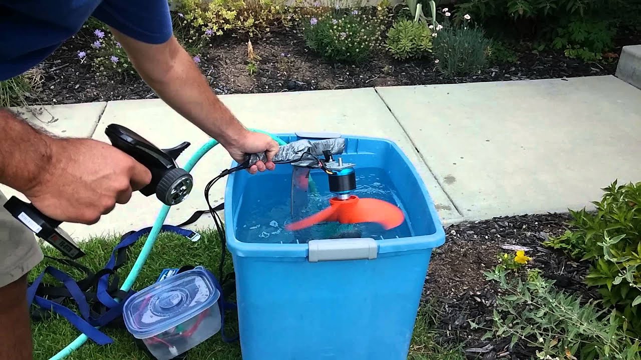

I made a few attempts at this over the years. I bought an old jet ski for the pump, bought a Kayak to try it out, bought about 4 different props that never seemed to work. Motor would always go out of sync or I’d have issues like the prop falling off. Here’s on of the reasons why I had so many issues, didn’t realize it at the time:
