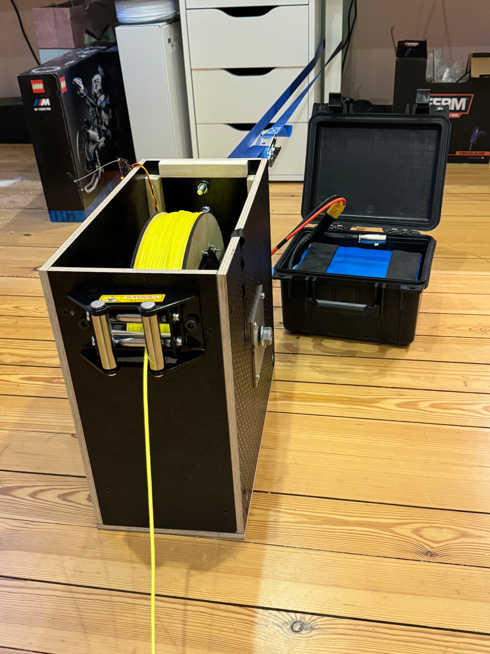

So V0.1 of a hub motor plywood box winch was born.

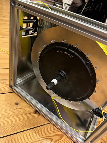

  • MXUS 3K V3 Turbo (16:4) hub motor - really nice runner, haven’t had any issues with it so far
  • Kelly KLS7212S - this has worked well for me so far, however there is an issue that I want to address (more on that later)
  • 20s4p custom battery pack with Samsung 21700 40T cells & BMS - through some friends I found a guy working on eBikes, eScooters and such, who built me this solid pack
  • 3mm dyneema rope

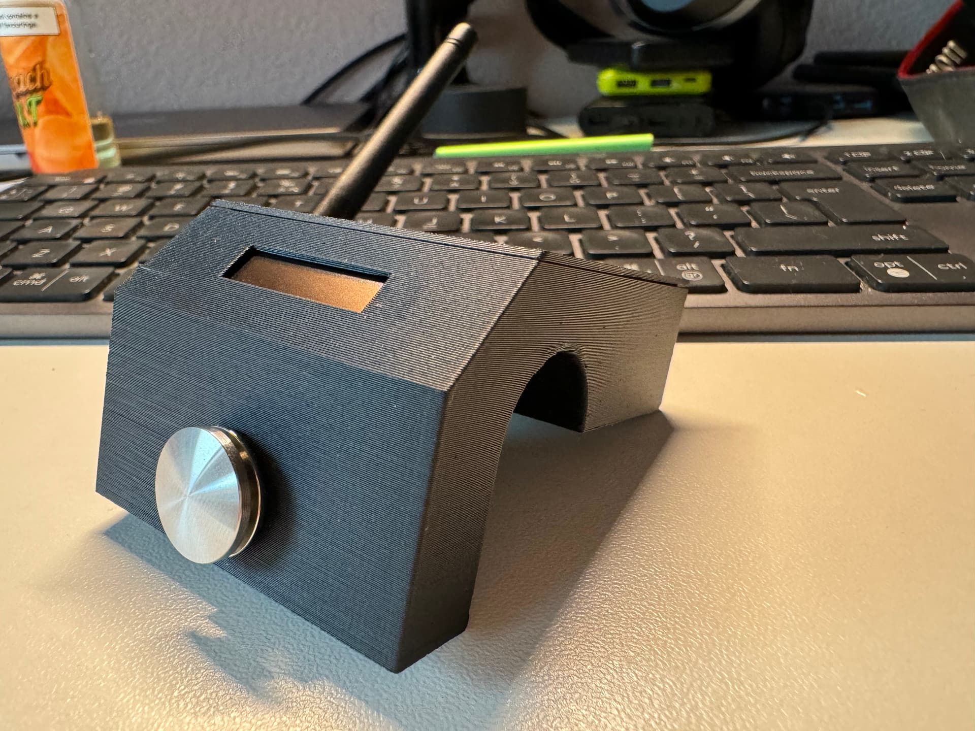

  • ESP32<-ESP NOW->ESP32 (DAC output) remote throttle - this has seen multiple iterations. Of course I wanted a “rider remote” installed on the handle at the end of the rope. I first tried using scooter throttle, but later switched to a momentary switch, long-pressing which would send a pre-configured “speed curve” to the receiver end.

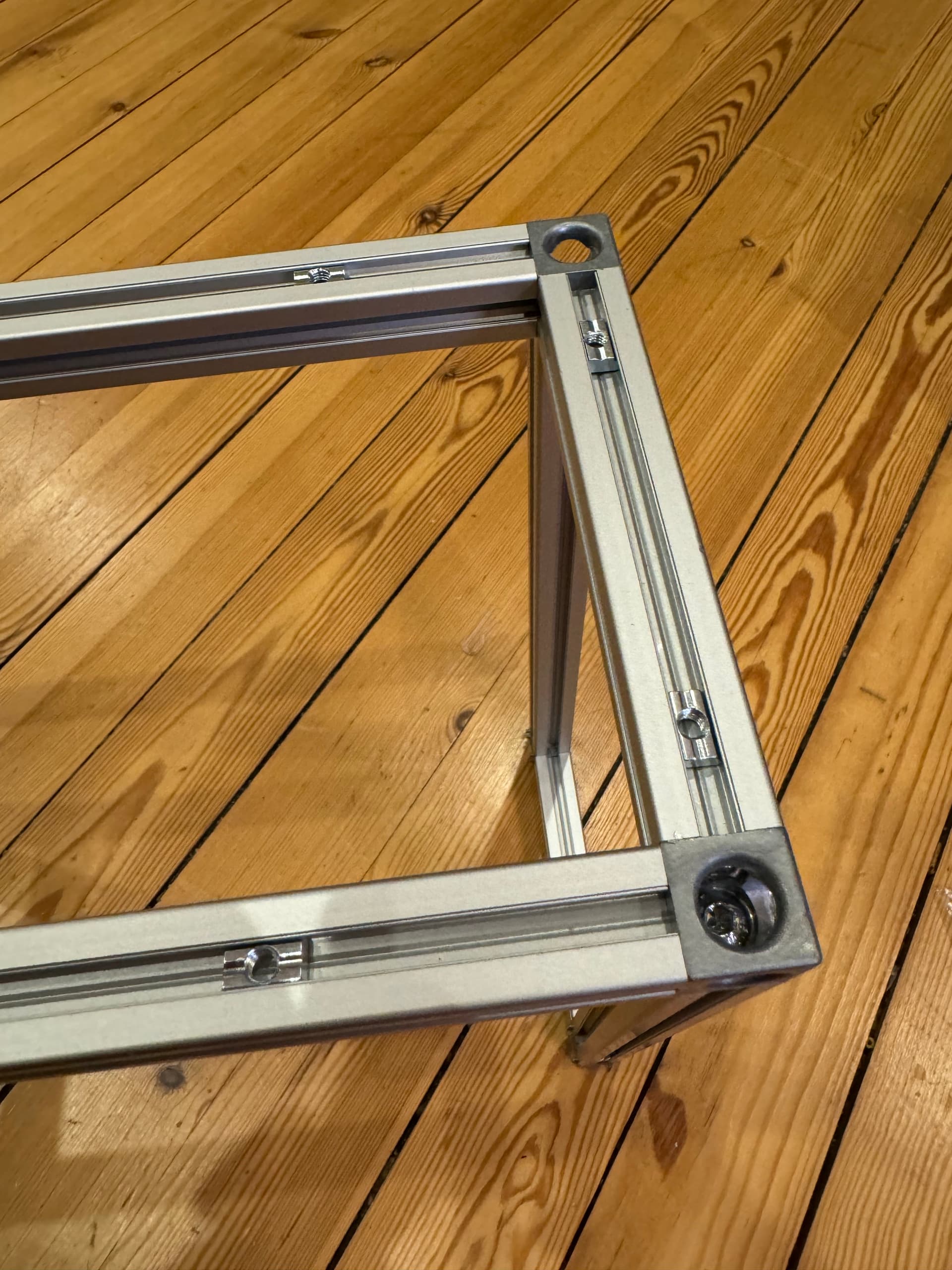

Fast forward last winter it was clear that the design could work, but needed certain improvements to more reliable. I didn’t want to get into welding, or any other type of complex frame building. So I figured I’d give 20x20 extruded aluminum + water jet cut aluminum sides a go. Around the same time I upgraded to BambuLab printer and designed a new rider remote.

  • 3D printed remote didn’t have any water ingress protection, and I temporarily re-fitted it into some PVC piping (grey cylinder on the last photo)

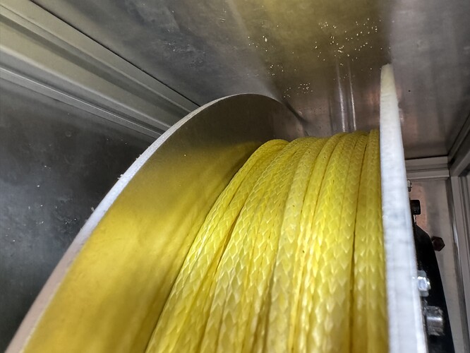

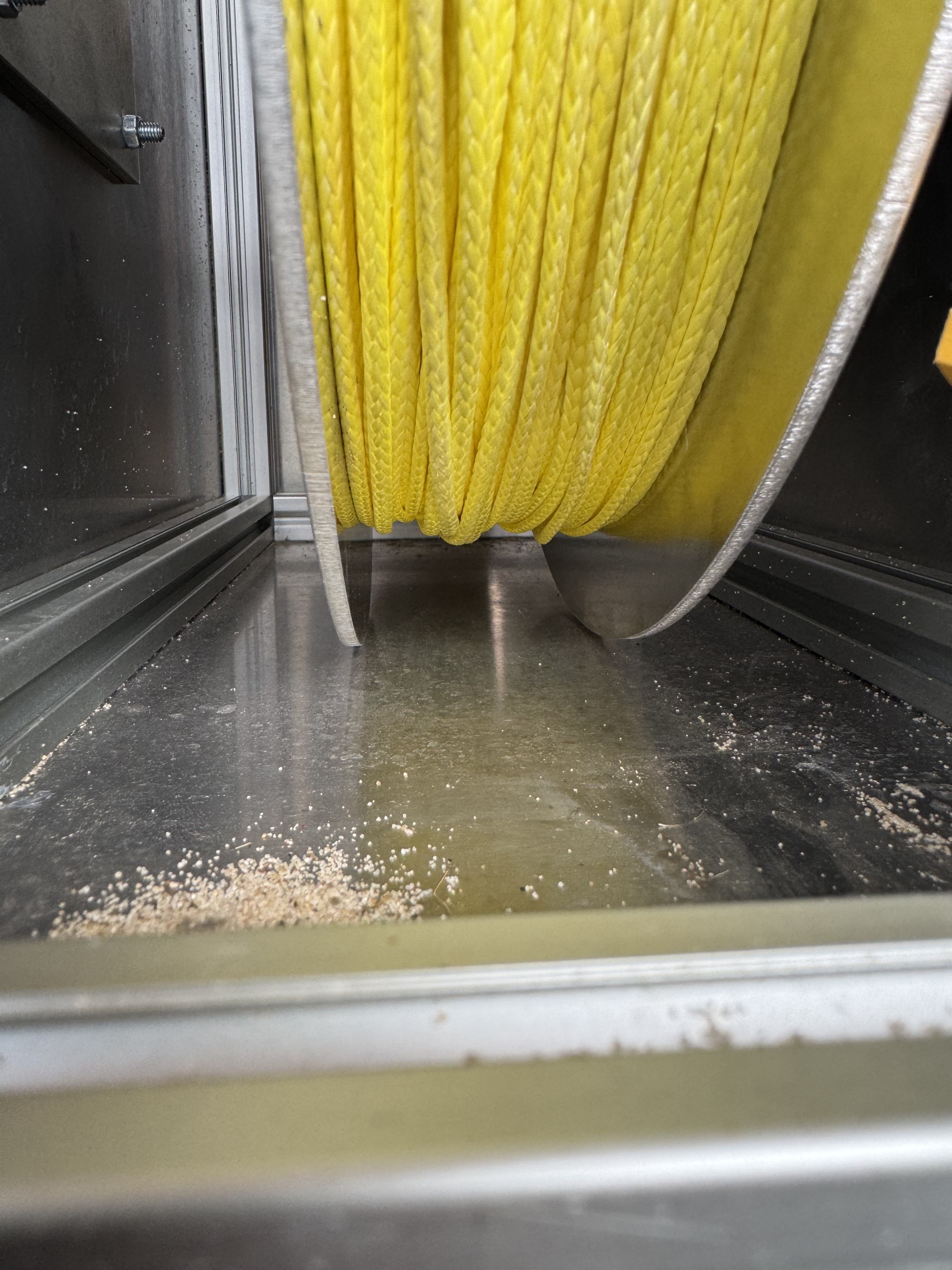

VESC has arrived! I ended implementing a function to track:
  • Tachometer - this value increases in both directions
  • Based on RPM (positive or negative), i’m tracking rope spool out, and spool in revolution count.
When spooling out I count revolutions, and the only permit spooling back in to spool_out_revs - 2. Works a treat for safe stopping of rope end before the winch.

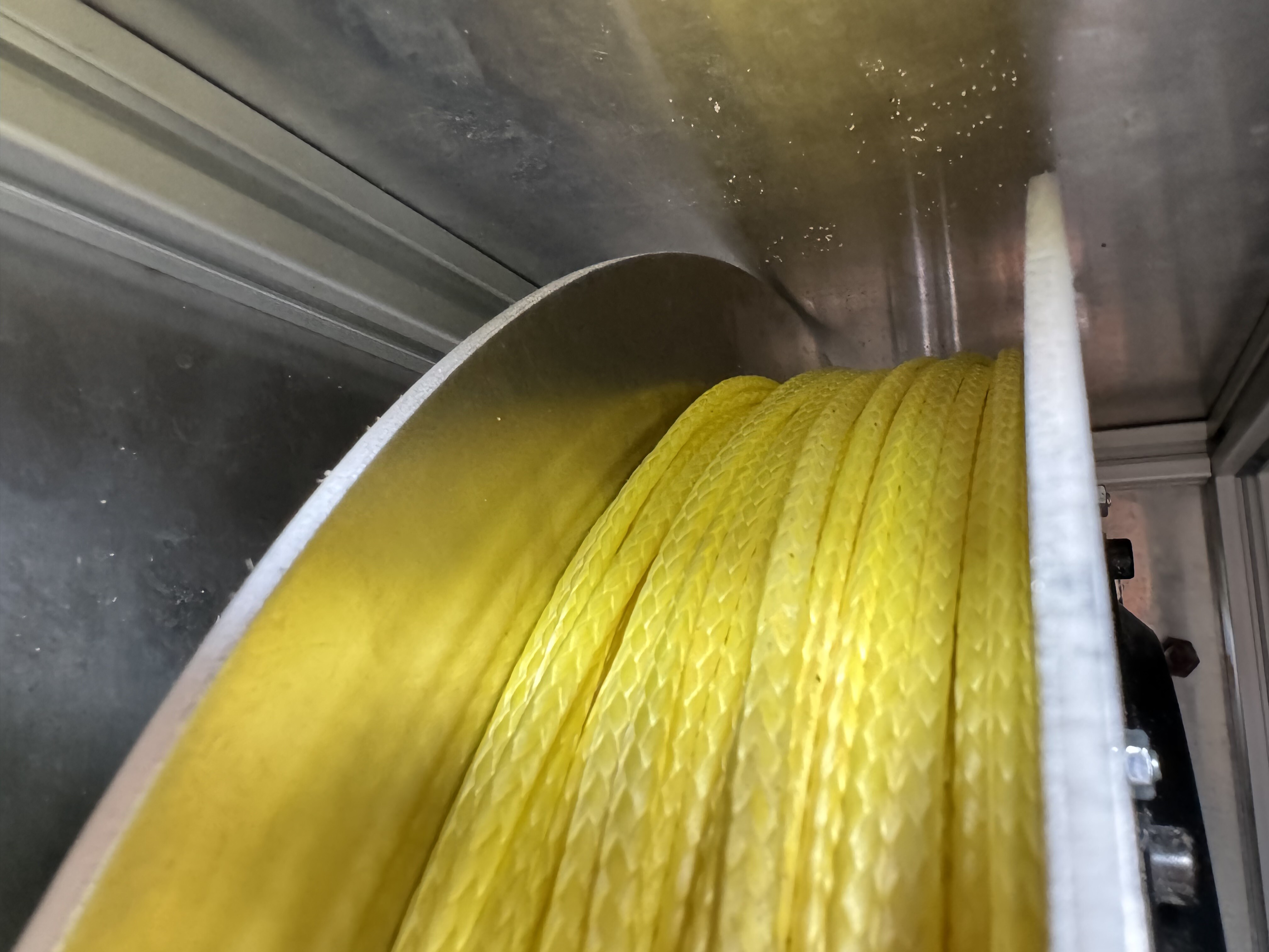

New 3mm spool sides replace the old flimsy 1mm sides, and with increased diameter there’s now only 1mm between the edge of the spool side and top/bottom cover. I hope this will help prevent some of the rare “rope off the spool” situations.
