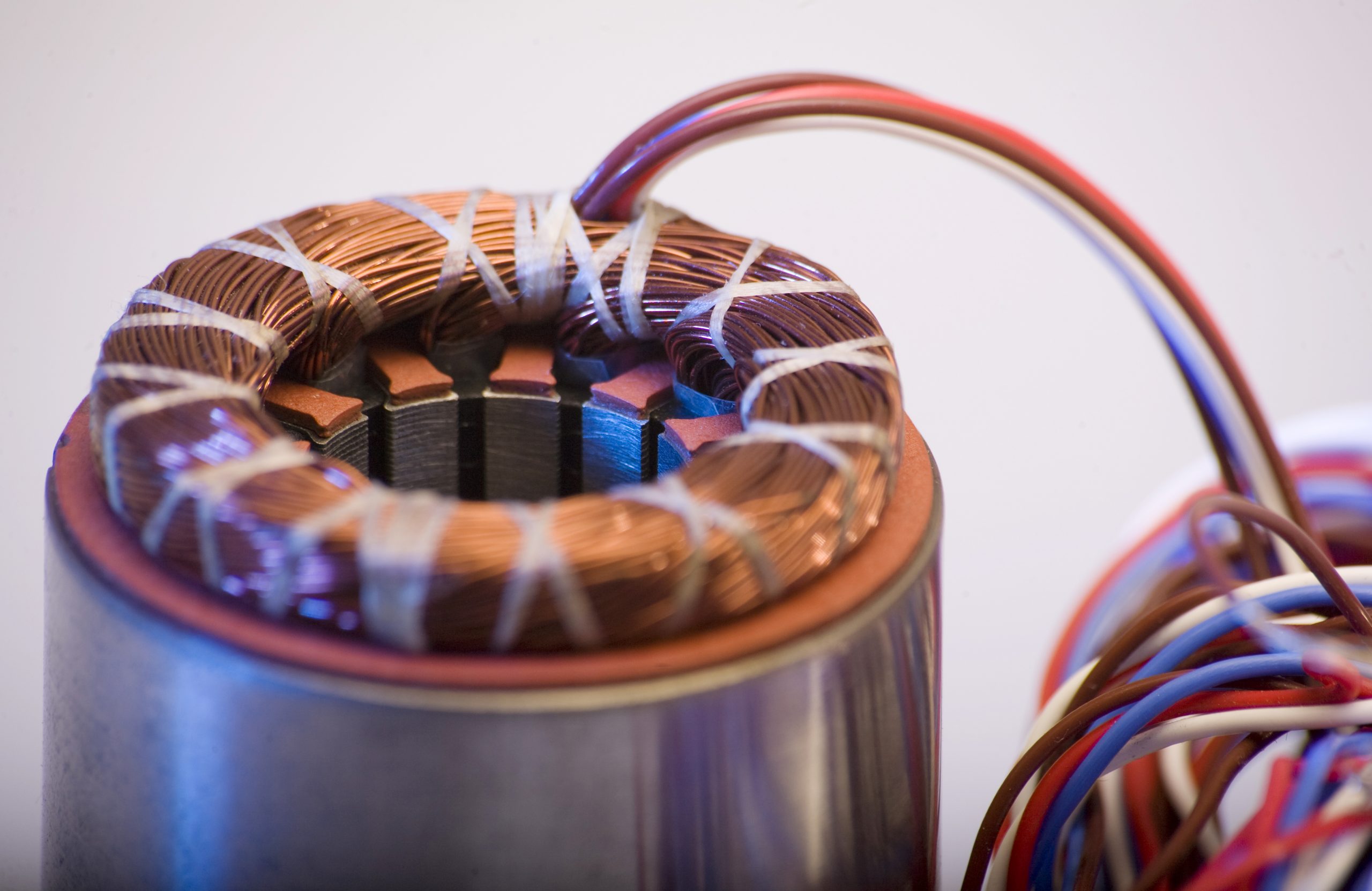

I did, but would rather love to build my own motor on my side. Sadly I donât own the necessary equipments. So, still open to any company that makes custom bldc motors in EU.
Remember, from a custom point of view : the more options the lower the total costs
There are companies that can cut stators and rotors for you. Then you would need to laminate them, wind them and build your own external housing etc.
I would rather go for a single company that makes the whole thing but can eventually begin like this. Do you have any company name on your mind ?
