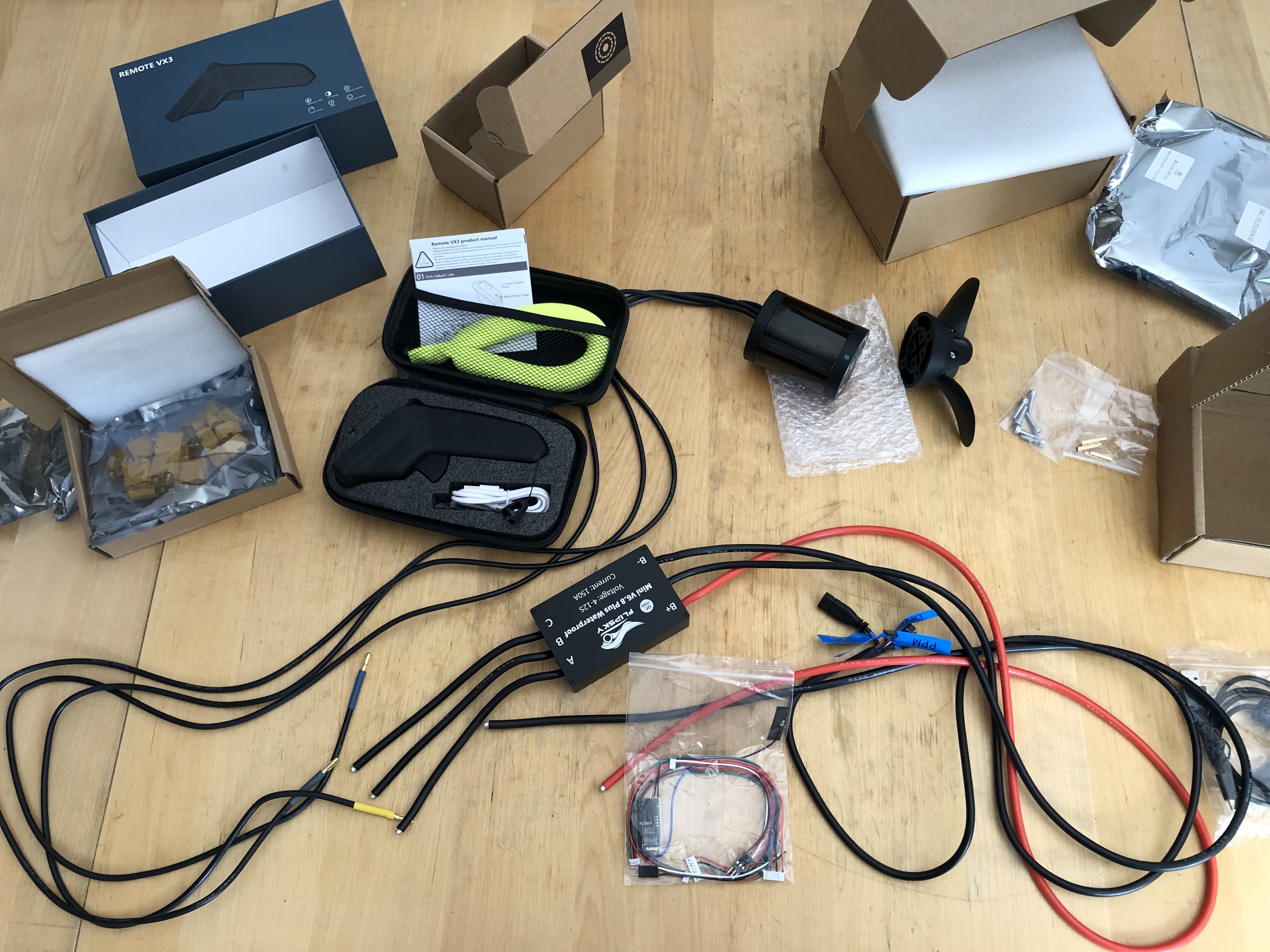

All right I ordered the parts! Hope it comes soon
XT60 / XT90 Male & Female AMASS Connectors PlugsXT90 * 5 pairs 1 $10.00
Flash Deals Flipsky IP68 Waterproof ESC Electronic Speed Controller Mini FSESC6.8 Plus based on VESC6 150A for Efoil Ejet / boat esurf
1 Flash Deals Flipsky IP68 Waterproof ESC Electronic Speed Controller Mini FSESC6.8 Plus based on VESC6 150A for Efoil Ejet / boat esurf 1 $123.00
Flipsky Fully Waterproof Remote VX3 controller For Efoil Esurf ESK8 - FLIPSKY
1 Flipsky Fully Waterproof Remote VX3 controller For Efoil Esurf ESK8VX3 Remote controller 1 $95.00
Flipsky Waterproof Brushless DC 6384 Motor 140KV 4400W for Surfing Boat Underwater Thruster Hydro Efoil - Waterproof Motor 6384 + 4.8" Foldable Propeller
1 Flipsky Waterproof Brushless DC 6384 Motor 140KV 4400W for Surfing Boat Underwater Thruster Hydro EfoilWaterproof Motor 6384 + 4.8" Foldable Propeller 1 $171.00

Got the goods :call_me_hand: quality looks :+1:
Finally took time to make all connections and tested. Unfortunately the mini 6.8 shows DRV fault.
I contacted flipsky for warranty…

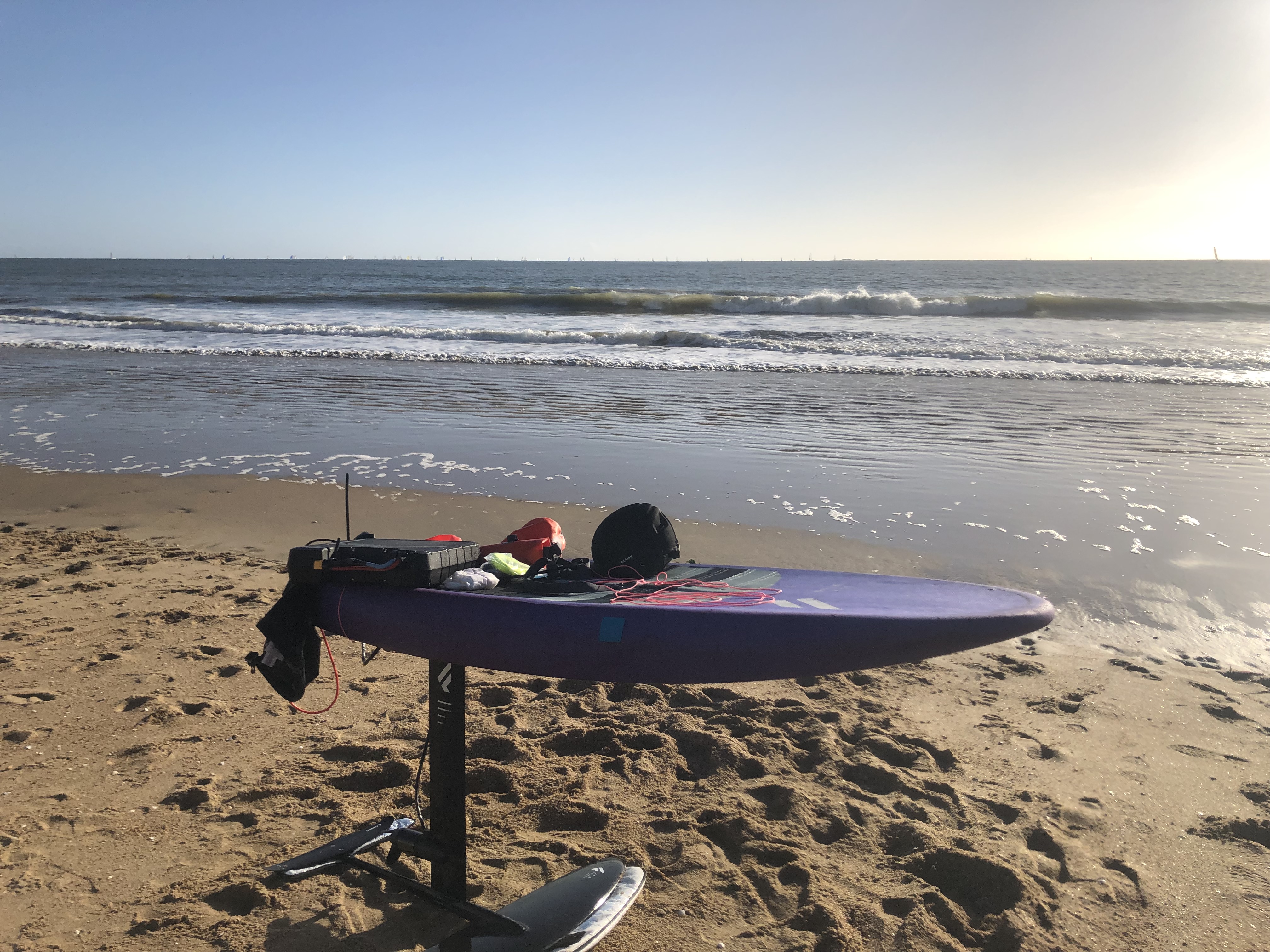

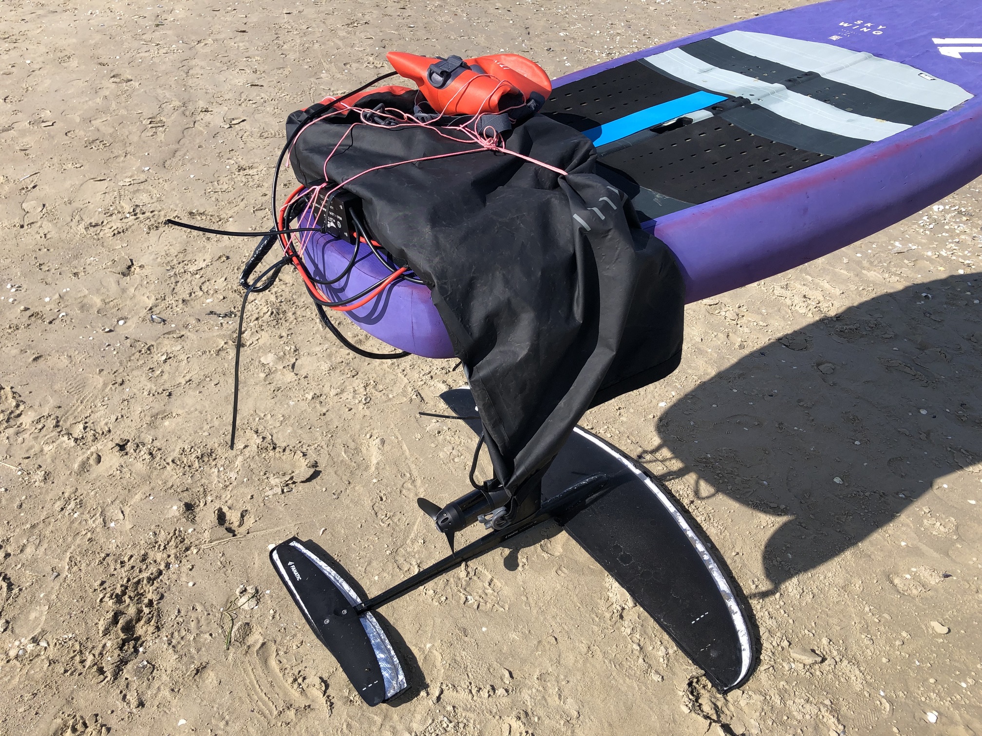

All right here is the return of experience on this project. It went full DIY . Super cheap, super quick to build. 0 time for craftsmanship.
I basically converted my wingfoil beginner board to an efoil.

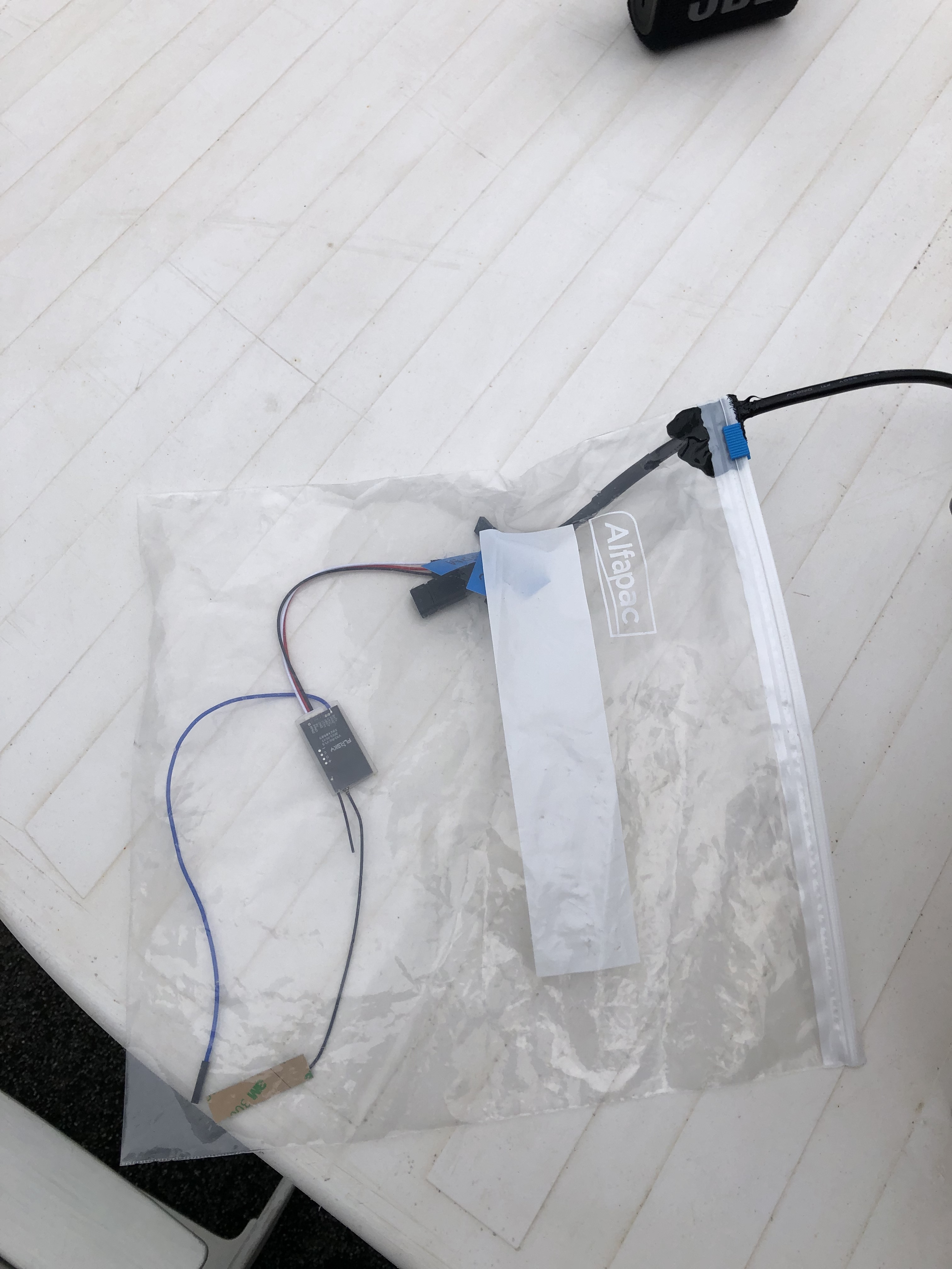

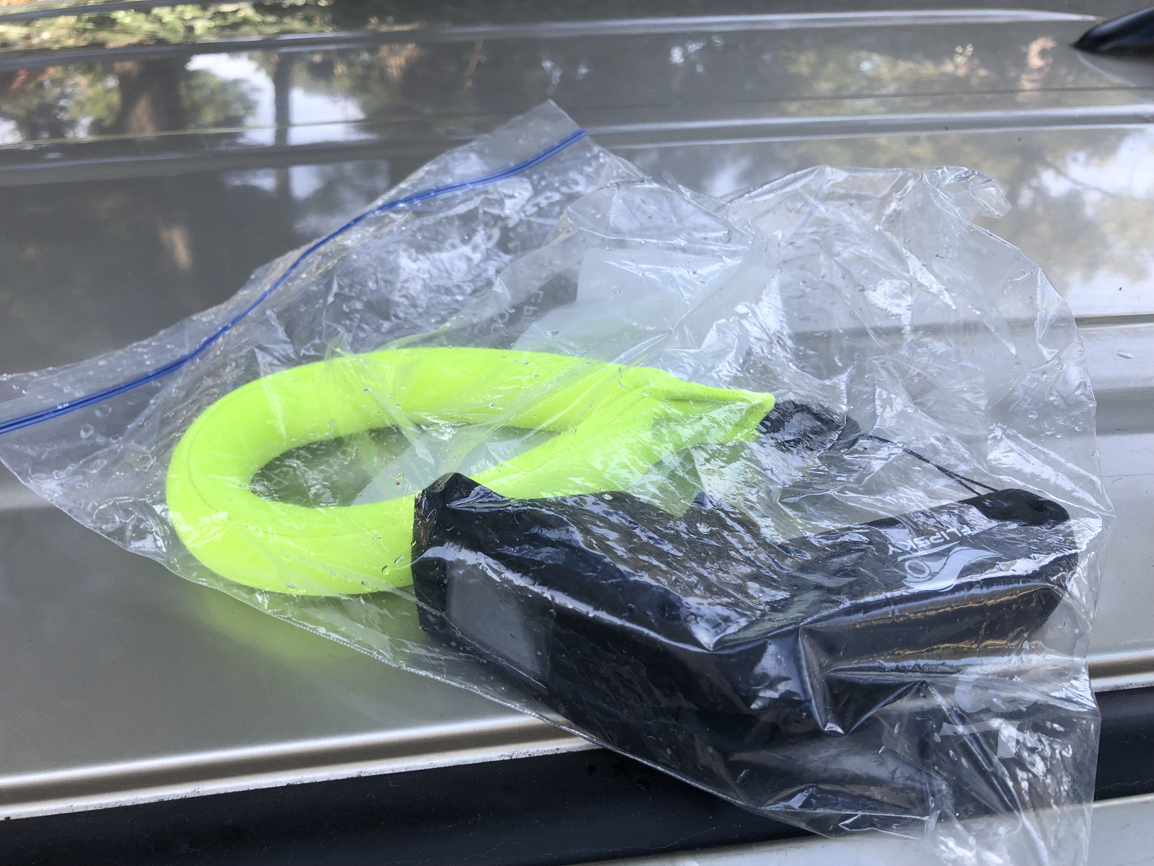

Seeing every issue on the forum with flipsky remotes I decided to use the remote inside a ziplock bag at all times which proved super helpful. The remote is like brand new after one season.

I must have done 10 sessions with the setup. I get 20/40 min per battery (20Ah takuma) so at least one hour per session .

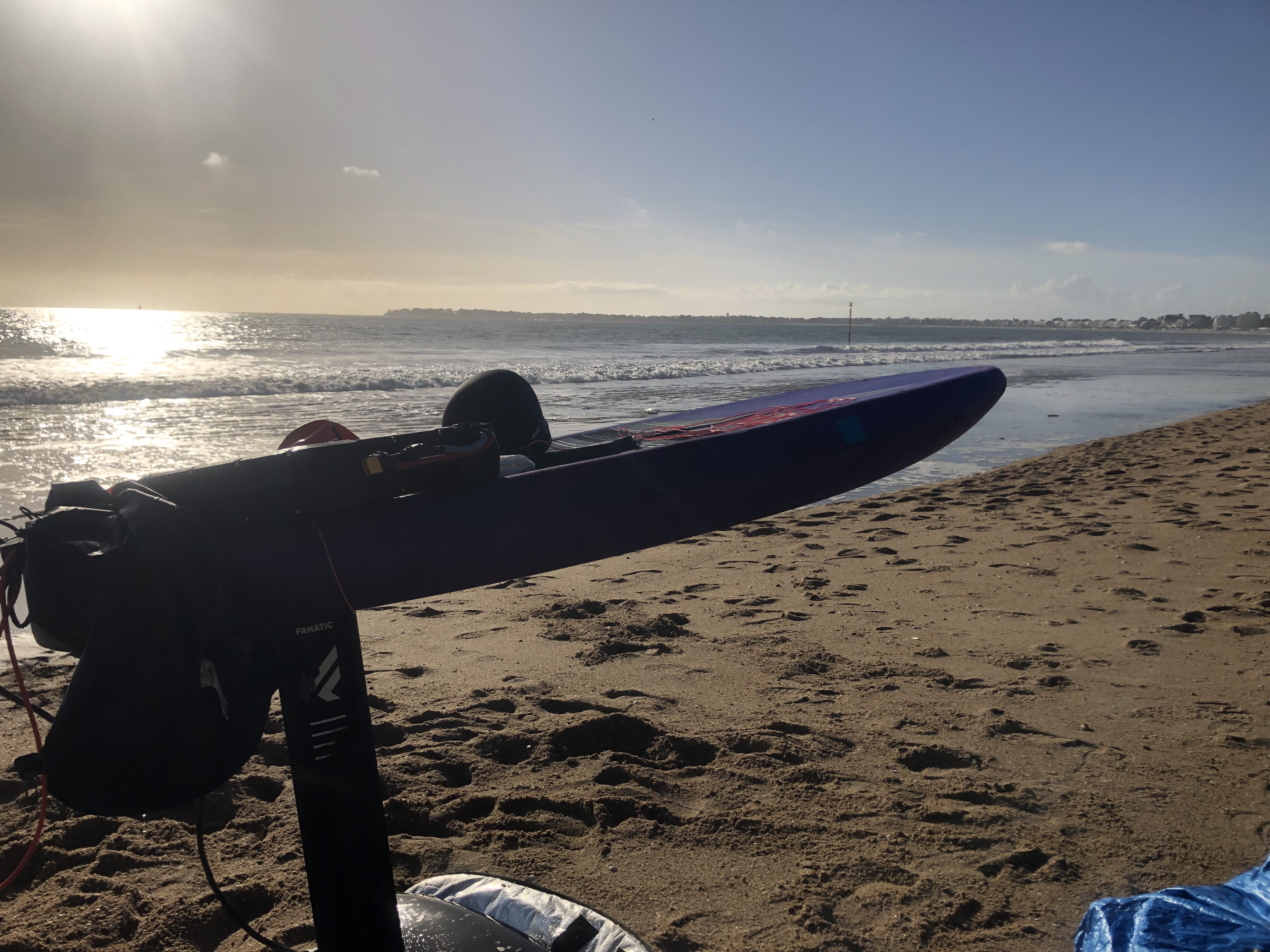

I mounted everything at the back of the board and so quickly realized the foil mast must be put at the maximum back setting. As far as possible.

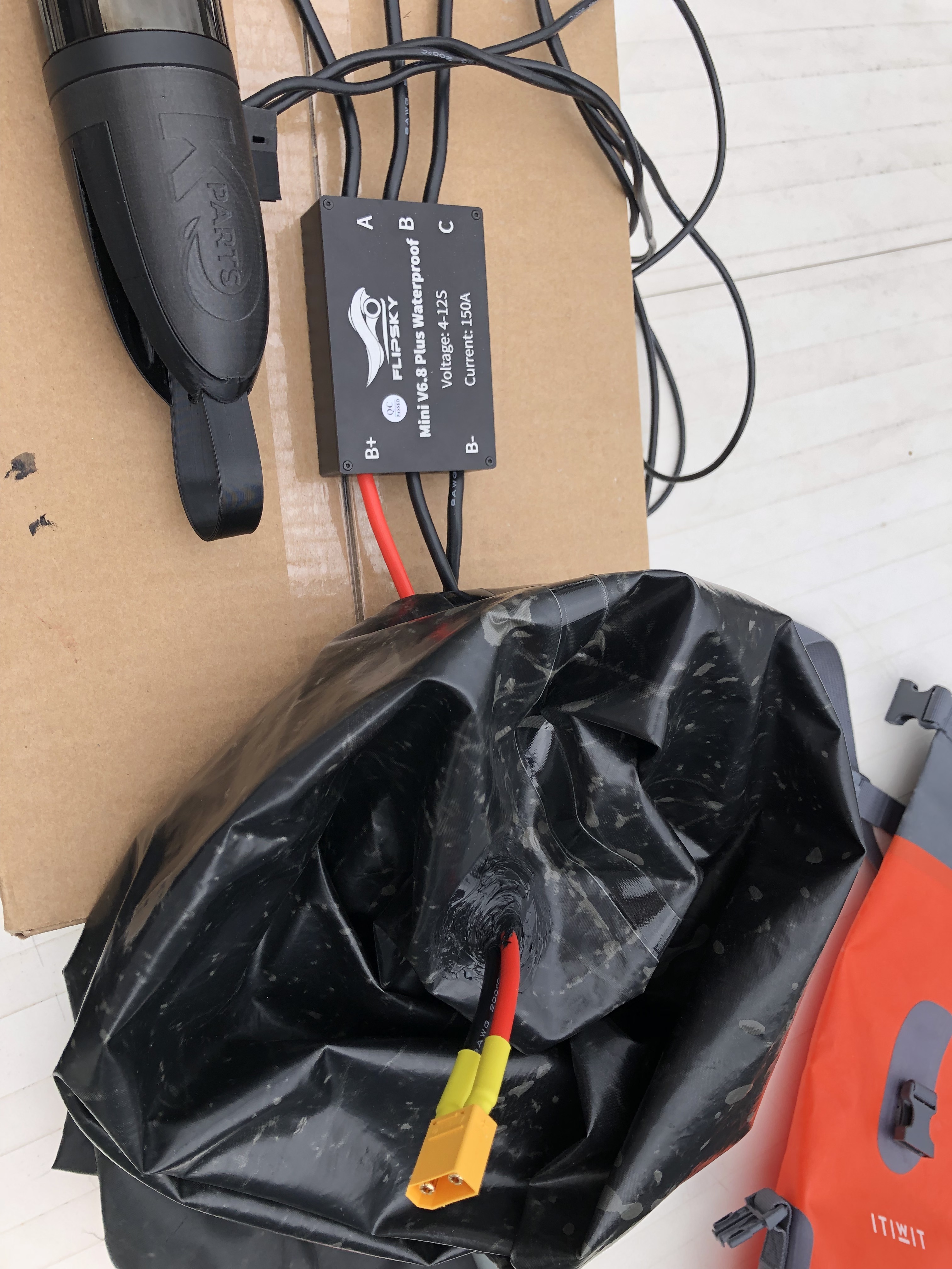

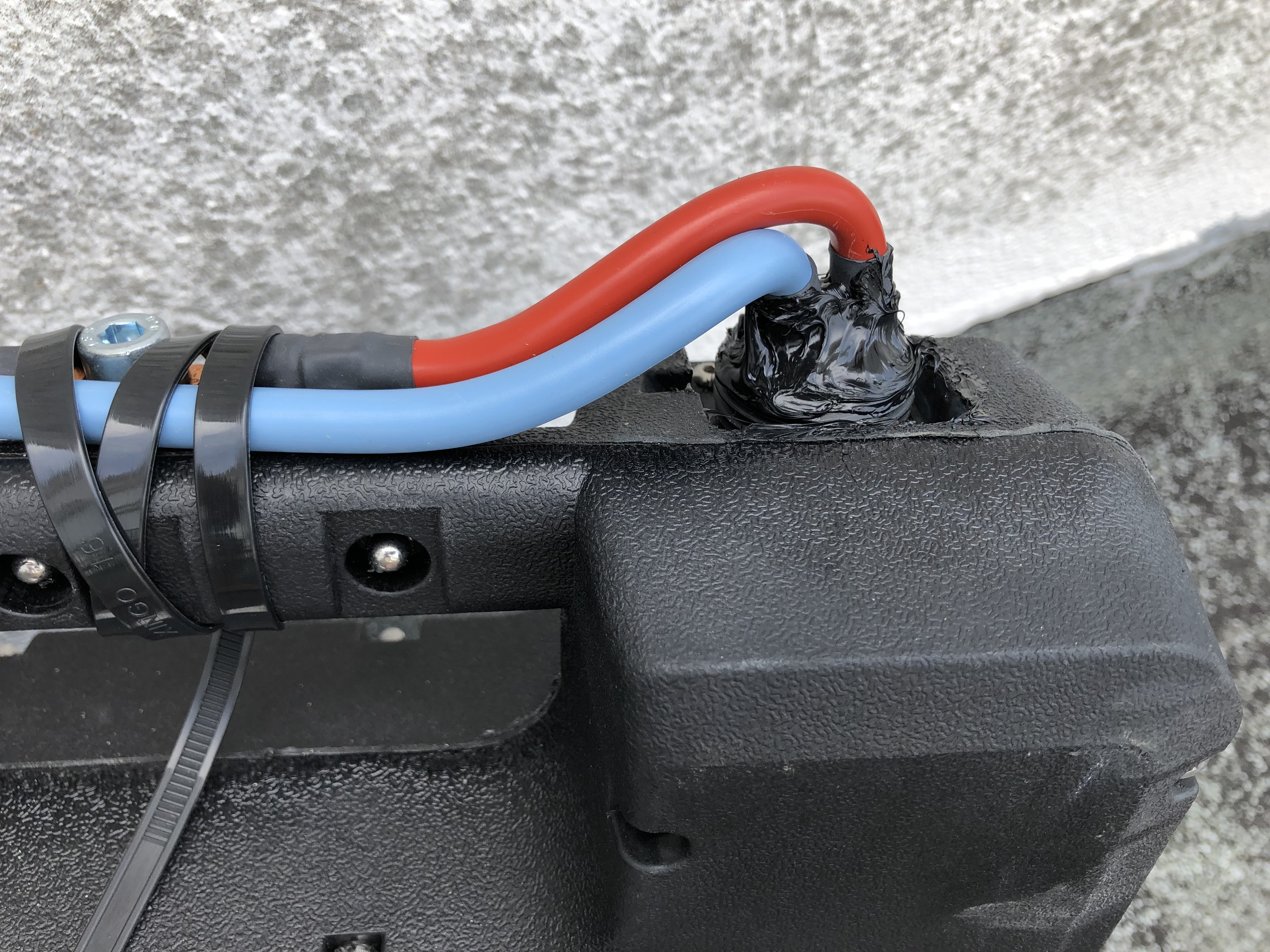

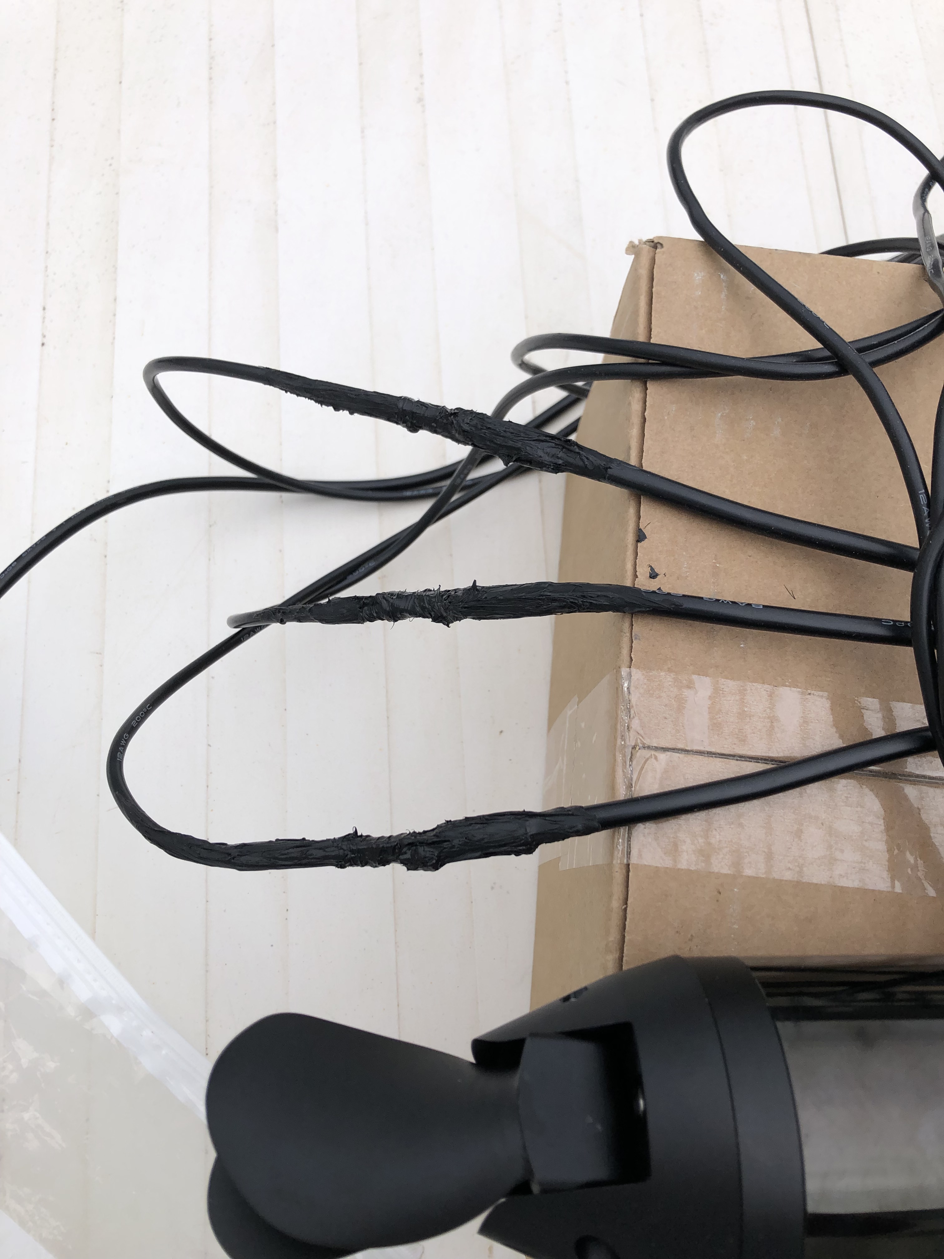

For the waterproofing, I ordered mostly waterproof parts and sunk everything I could think of in Sika flex.
I used old sailing waterproof bags I had around which worked really well even with cables going through the openings for the receiver bag (orange bag on pictures is for receiver and black for battery).

If I kept this setup I would try to find something like an eye lid to screw where the back foot strap is that way it would be possible to strap properly the battery. The string was a little light!
Here are a few pics following.
