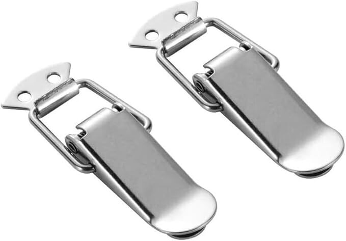

I would look at existing solutions to this, small latches already exists. The hard thing is making it flush mount “inside” the fuselage.
