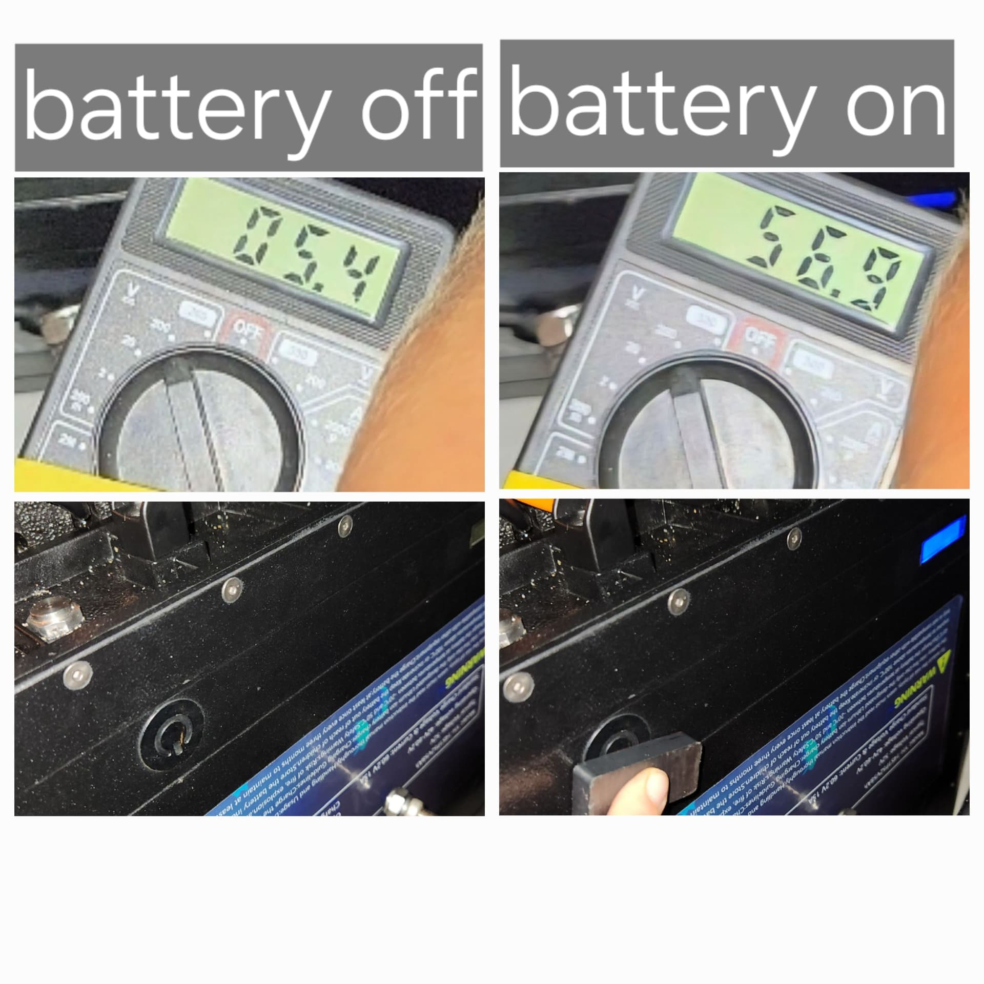

Can you tell us how much voltage the battery is giving out. I saw on the specifications of the battery that Max voltage is over 60 volts. Which would result in overcharging the battery.
Maximum charge should be 58,8V in your setup. Absolute Lowest discharge voltage is 35 volt. Below that the battery will be damaged.

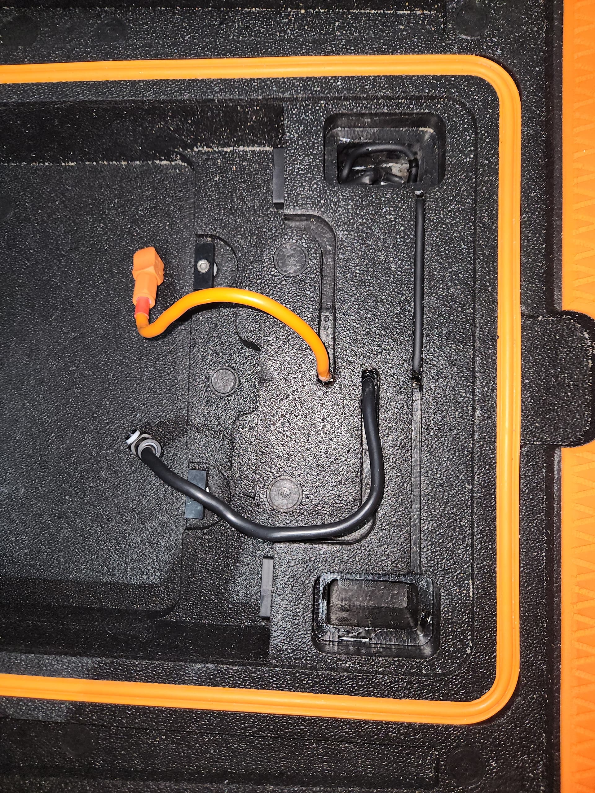

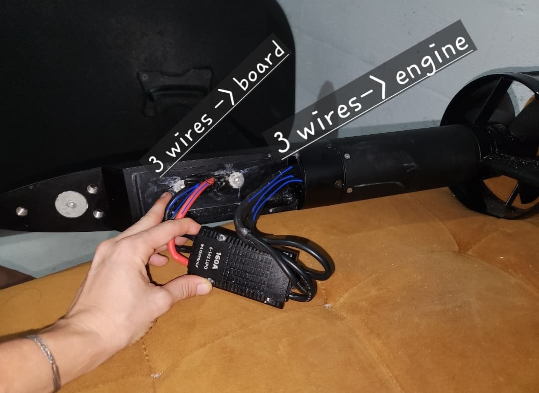

I think I can handle replacing the esc, I found the same one on the internet, there are 3 wires coming in and 3 wires coming out, I can connect that. But how can I tell that it’s not the engine? I haven’t measured anything with a multimeter, except for the battery itself. What is a remote transmitter? And what is a bluetooth unit?
As far as I understood from chatgpt, the speed controller is what is in the board, correct? but I don’t have anything there, as I wrote above, I unscrewed everything that could be unscrewed in the board, and I didn’t find any elements there.
What was the actual battery voltage?
The board has a receiver to receive signal from the transmitter and send it to the ESC.
If the motor is turning by hand it may be alright.
If you replace the ESC, you need to ensure all connections are waterproof.
Don’t go to ChatGPT, its just going to confuse you more. It doesnt know which board you have and if it cant find that, then it will just approximate based on whats more popular in its training.

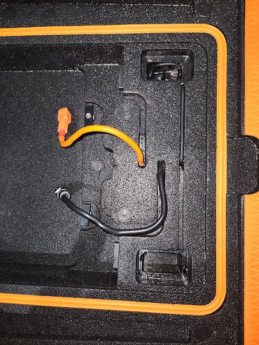

There is a third wire near the back of the board. That most likely runs to the receiver.

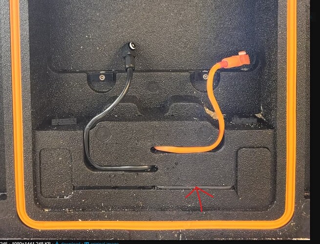

:roll_eyes: are you sure? are you sure? that is, in the board, there is some kind of receiver that I don’t see? or maybe it is that there is no receiver?
This?
That is the 3rd wire from the ESC to board and will be linked to the receiver. Exactly where the receiver is in the board I don’t know, but you will need to try figure that out.
I see 3 options for failure:
  • Remote and receiver
  • ESC
  • Motor
If you have a spare remote and receiver, then you can just unplug and plug the new one in and eliminate that entity.
Assuming the motor still turns by hand when off, then you can assume that its not the culprit and swap out the ESC.
Finally if its not those, then you’d need to swap out the motor…

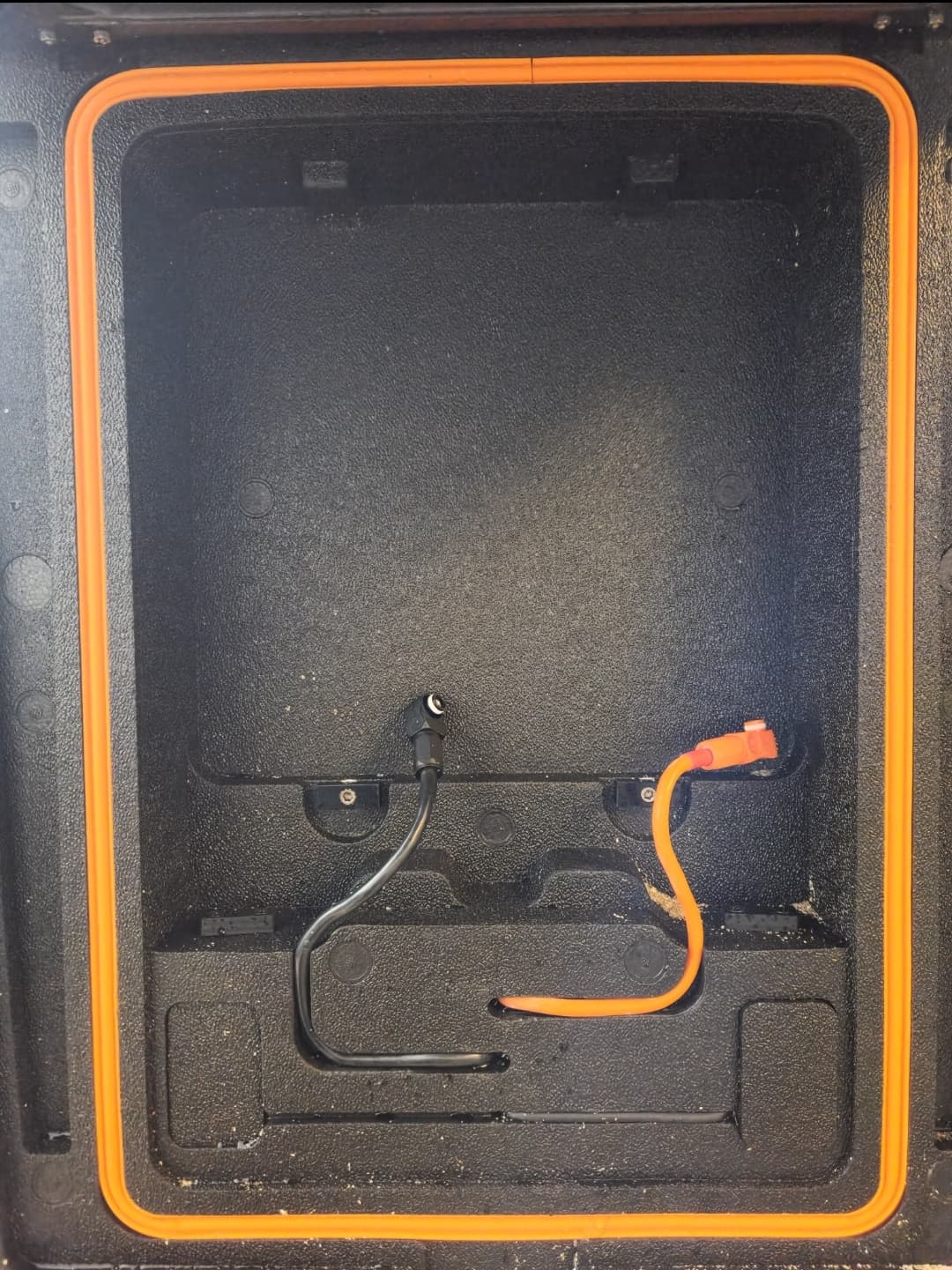

Thank you. Sorry, Where is the “receiver” here?

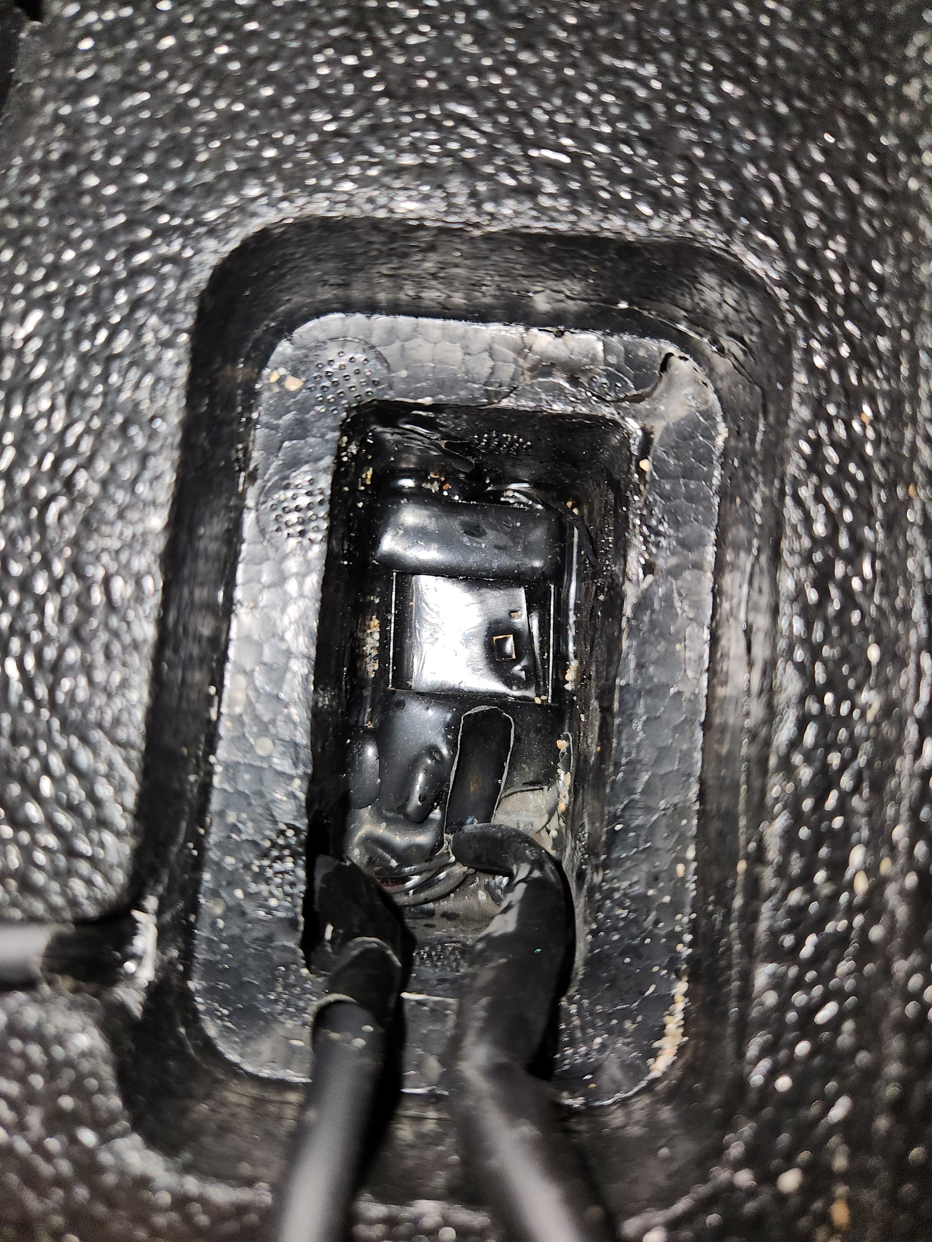

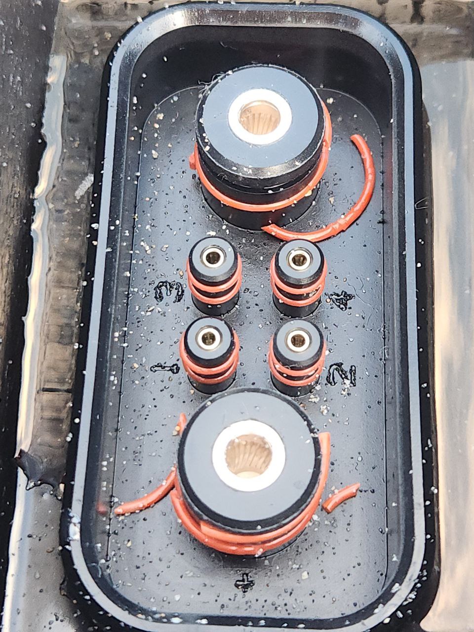

This looks like it might be the problem
It looks corroded down there and it shouldn’t be.
You going to need to try get that out of there.
If you’ve bought a spare remote, it should have come with a spare receiver too.

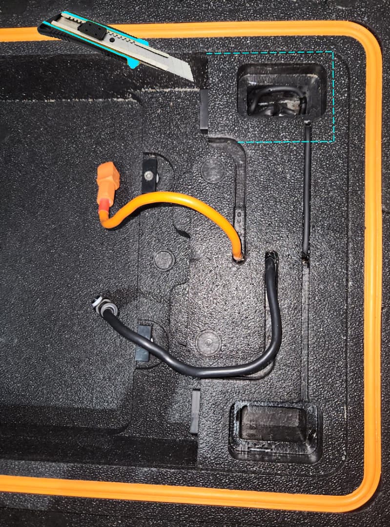

okay, thanks. to get it out of there, you need to break the structure - that is, break it, destroy it, since it is imprinted inside. I can do it. What should I do? Is this normal?
How do you connect the mast to the board?
Is there a big plug? The battery and the signal wires pass through that so this needs to be in good condition with no corrosion etc.

there was water there - is that normal?
