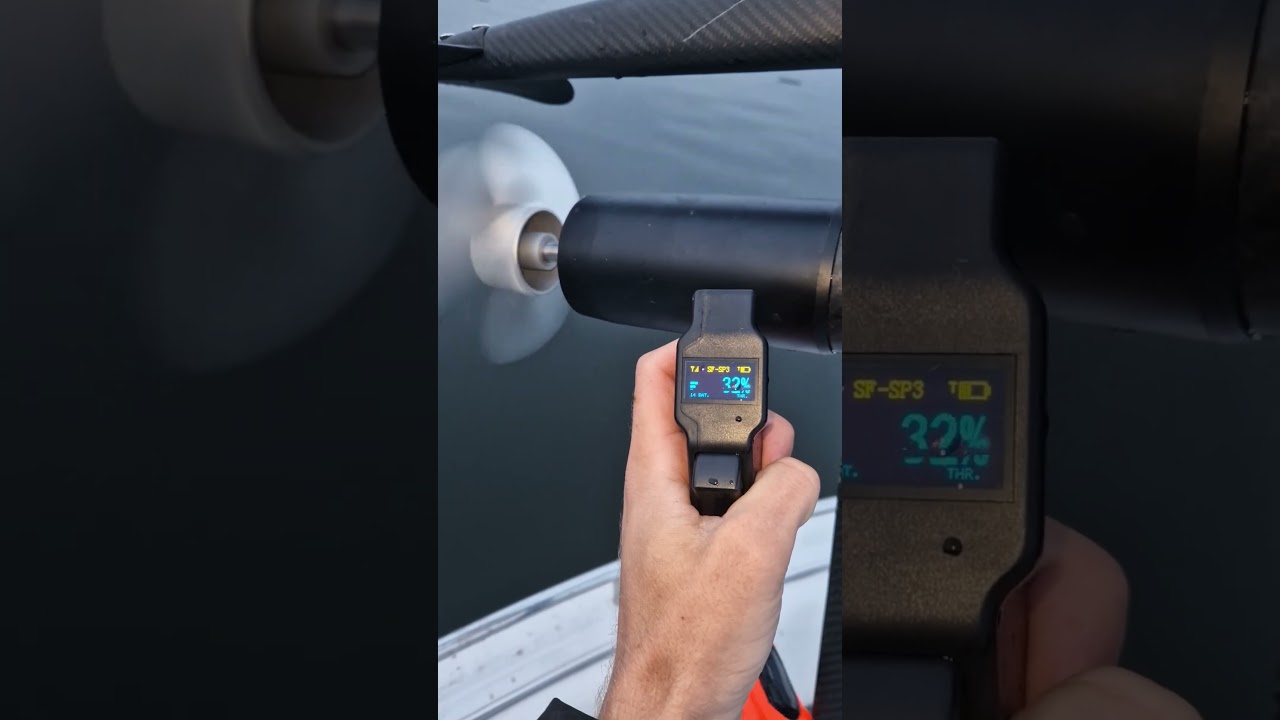

Does anyone have a clue what is going on here? Desynch?
Hello everyone,
My efoil has a SEQURE SQESC WP14200 wich is a couple of hrs old.
Suddenly in the middle of a session the motor started to behave like this. Sometimes it even locks up completely. Has anyone seen this before? Is this desynch?
If it ran ok before then not really desync issues (it used to have ability to sync). Loss of control somehow. Could be the esc is faulty or a minor short somewhere on the motor/ motor wires. Any signs of water leaks?
I’d try unplugging/plugging and checking all wires first but don’t run it at full speed with these issues, this could kill the esc.
