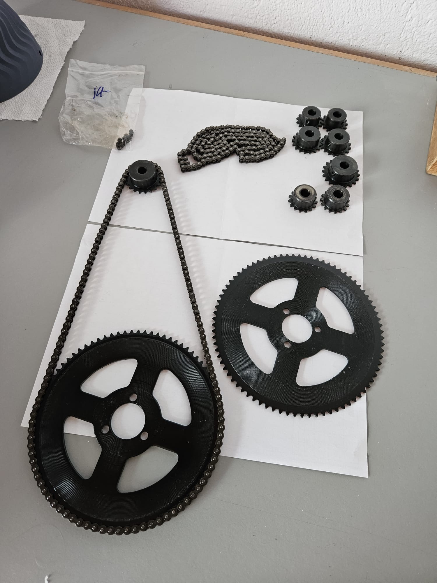

I was not happy with the belt because i always had to tighten them each session. I found a good pdf online on how to design a belt system and choose the right belt. After a few calculation i realised that my belt are really undersized for the power that is delivered. That would explain why the belts were slipping and why i had to tighten them so much.
So i decided to switch the belts to chains :
I will test this setup this afternoon but i’m really hoping for better performance.

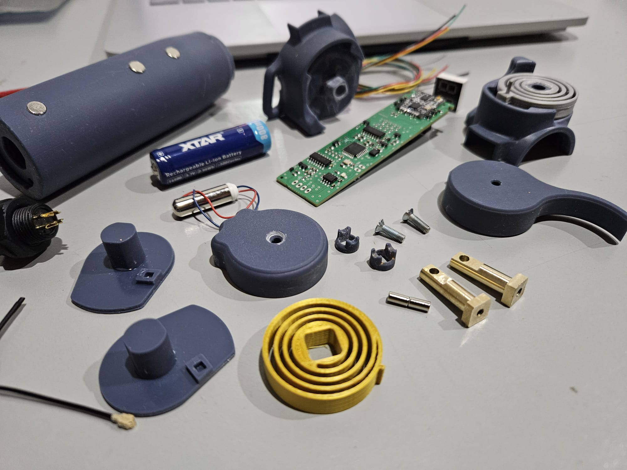

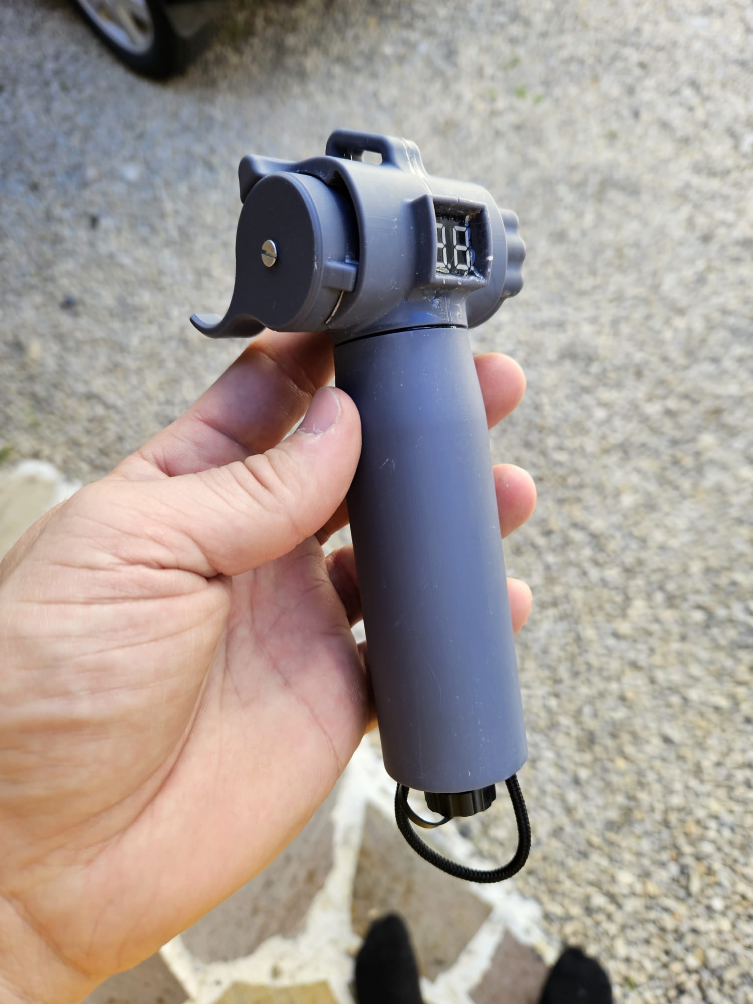

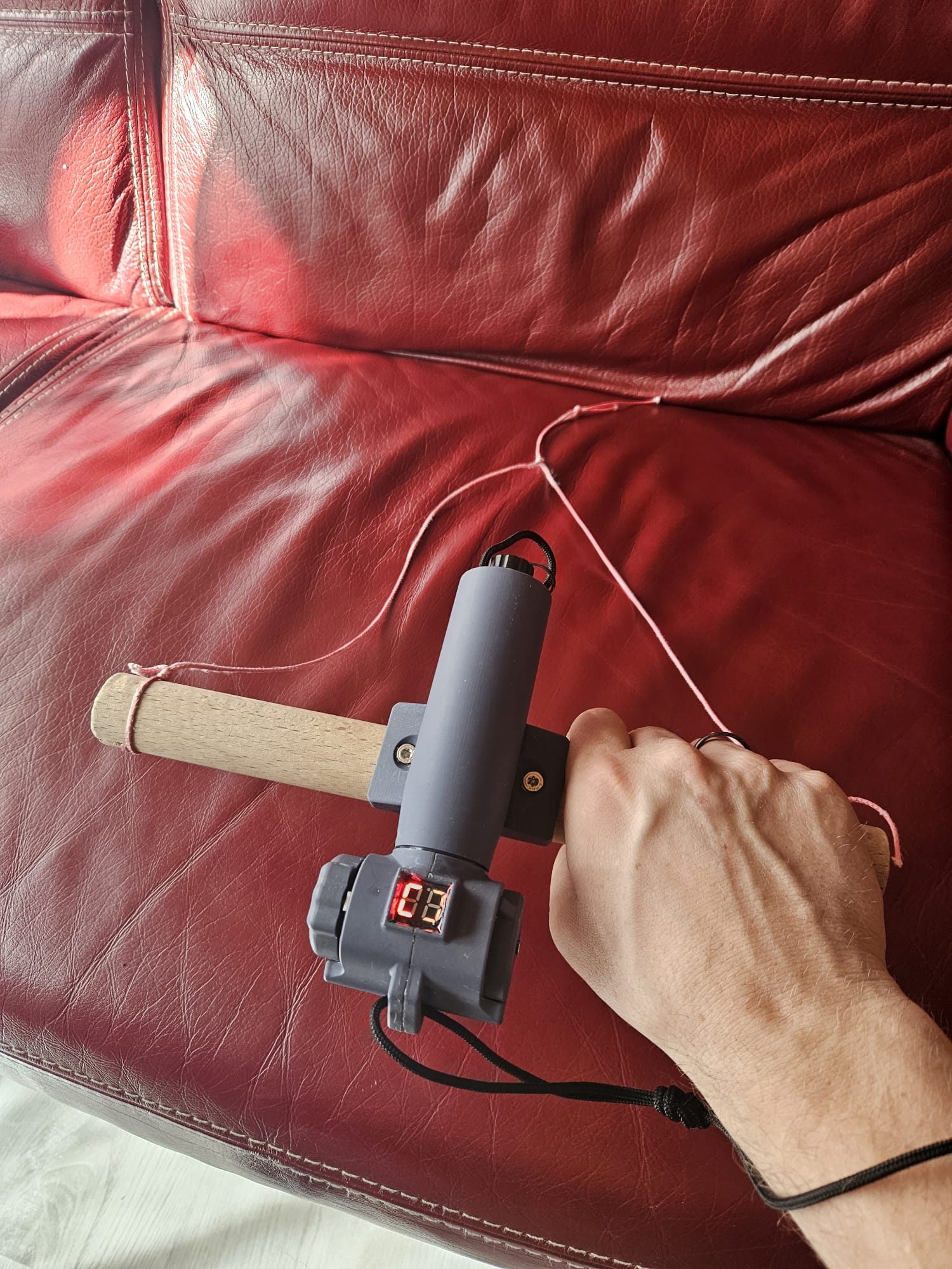

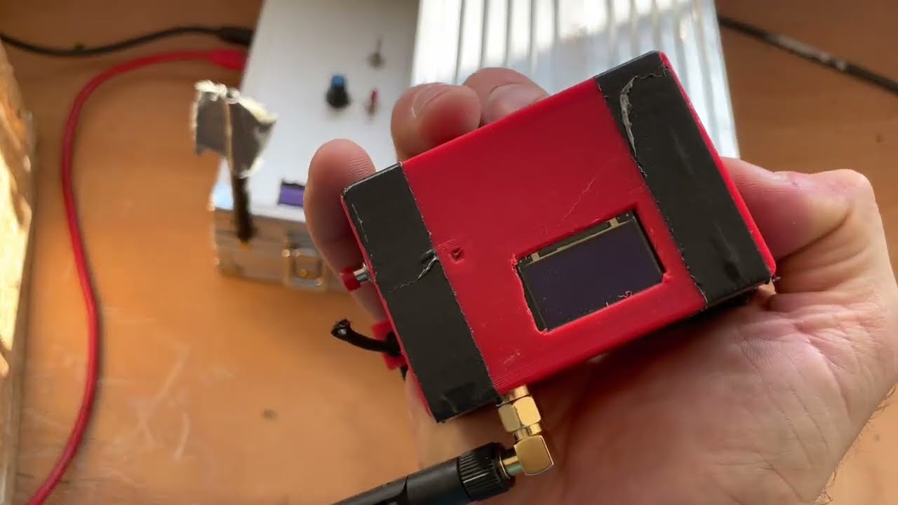

Also I built the Bremote V1 that @vincent sent me (thanks again).
This remote is amazing, such a good design, bravo @ludwig_bre !! It was a pleasure to assemble.

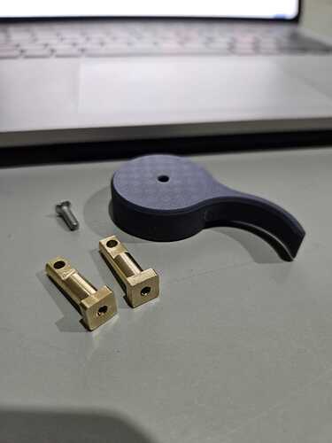

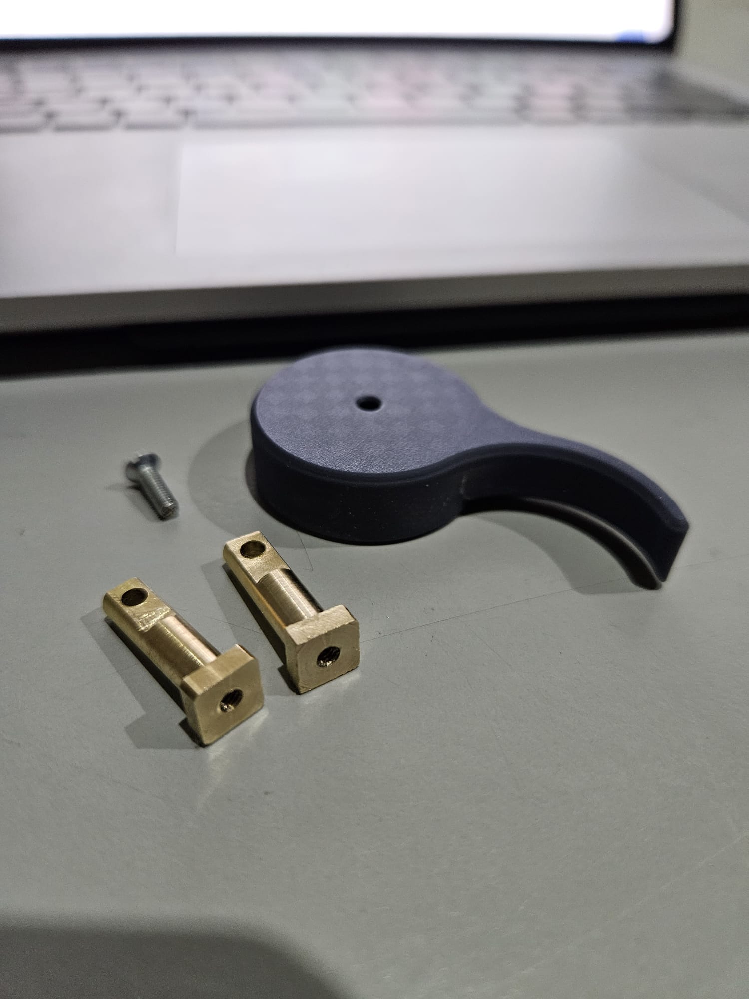

I decided to go crazy and make some parts in brass for better durability :

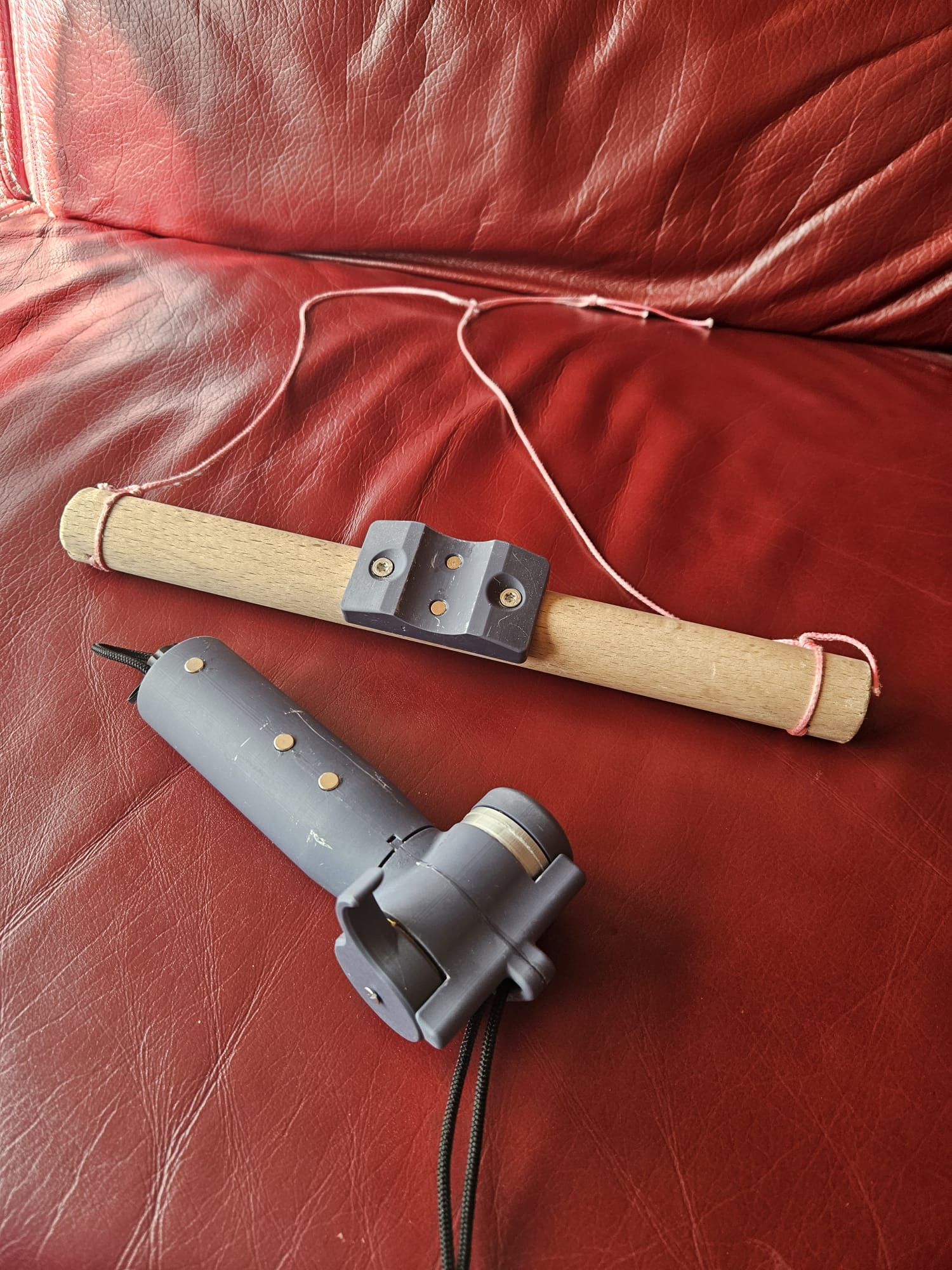

I did a few modifications and added some magnet on the casing. The goal is that i can control the remote with my 2 hands on the handle and when i fall the remote detach and stays with me.
This remote will be used for other projects too so i like that i can detach it :slight_smile:
Let’s try all of those new features this afternoon :sunglasses:

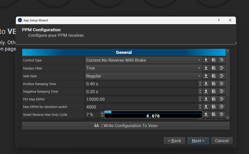

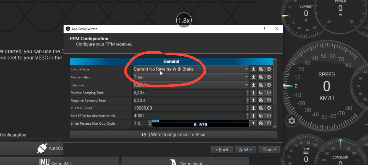

@Jezza can you tell me exactly how you set this up ? I don’t find how to set up forward only with brake.
Right now i can only accelerate and when i release throttle it freewheels until zero. But that’s not great because with the inertia it keeps turning when you fall… I would like it to brake automatically like yours and walk out the line without any braking… i tried everything and i don’t manage to get this setting

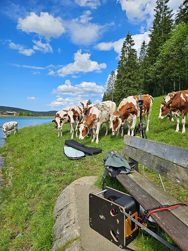

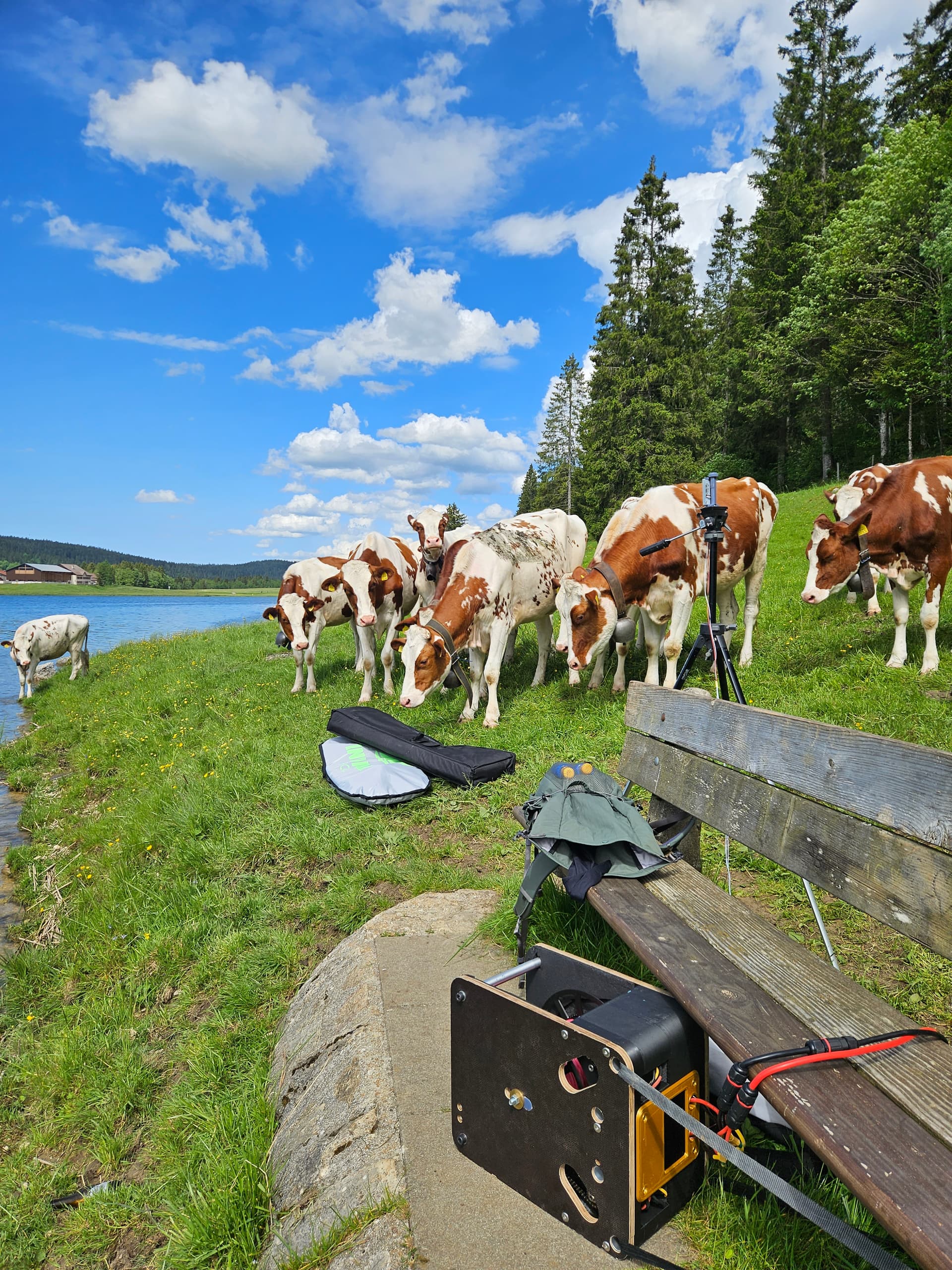

Report of last session :
I arrived to the spot and it was crowded there :laughing:
It was much better with the chains, no problem anymore, I could even put the max amp of the motors down to 100A. Somehow with the belts those values were not enough to pull me out of water.
Also the bremote was absolutely perfect, I had no range problem, really happy about it !
@Jezza thanks, I tried this setting and it’s definitely not braking, still freewheeling… something else must be wrong in my settings.

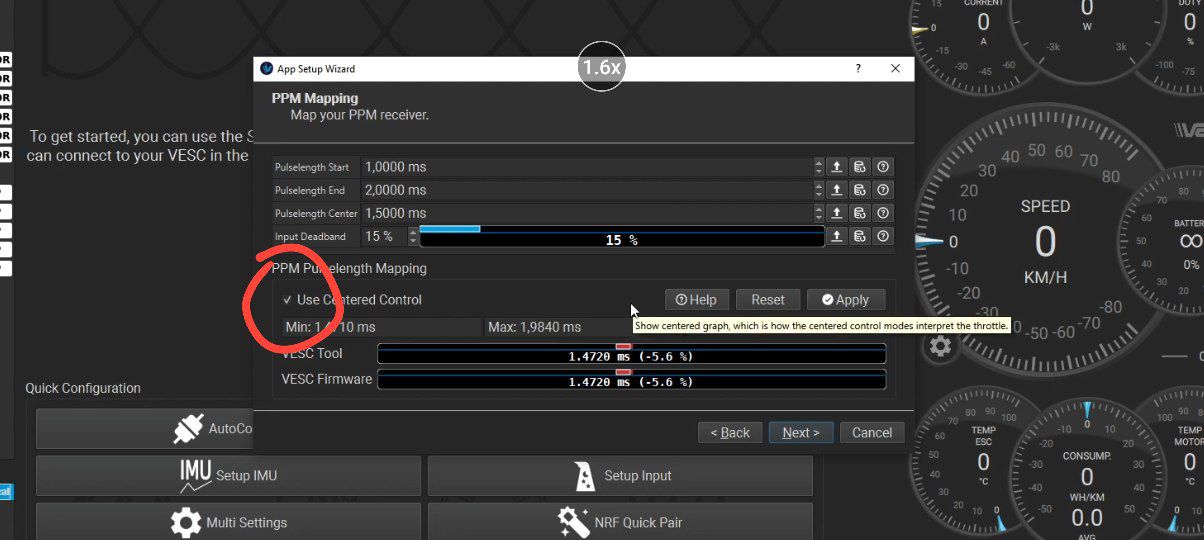

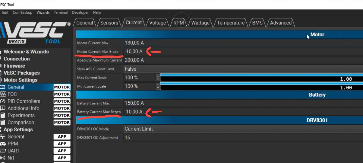

Regarding the braking of the motor: Make sure you set control type to “Current no reverse with brake”. Make sure the input is actually “centered control”. Then make sure to set the timing values in a way that no throttle= -100% on the visualization in the bottom.
I show the exact setup here, except the last step with the -100%… https://youtu.be/QaVPISP8BF4?t=1005
Also set a sufficient brake current in the motor current settings, both for motor current and battery.
For your setup with the big amount of mass spinning, I would probably use 50A of brake and batter Regen current

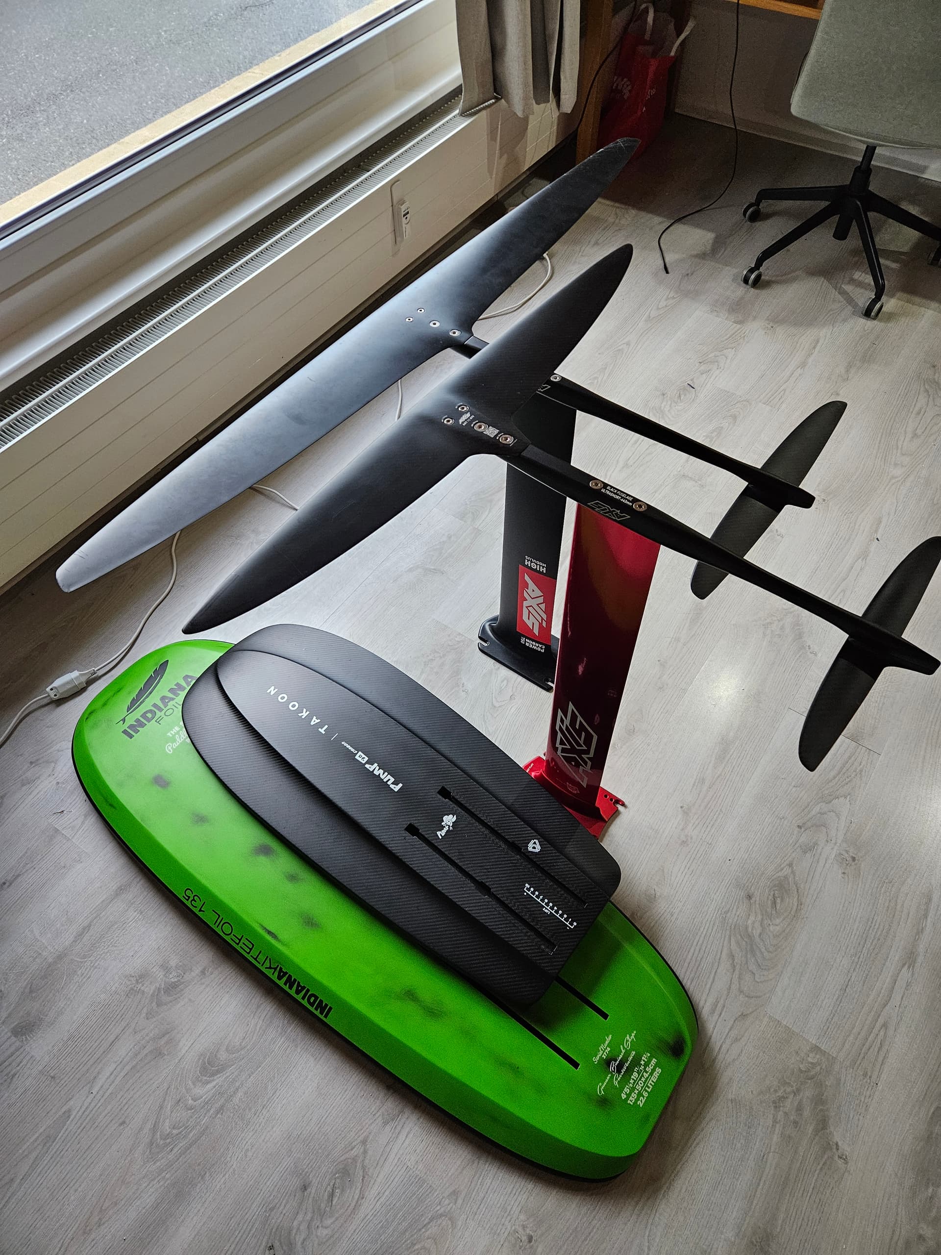

I recently bought some faxis gear from China. One set to learn pumpfoil and one for a new efoil project :
I’ve done a few session with the winch ,the green board and the pump wing. It’s difficult to get up on the board (i’m starting laying on the board) but i’m getting there and managed to fly like 15 seconds… I also bought a thick neoprene suit so I can continue until winter.

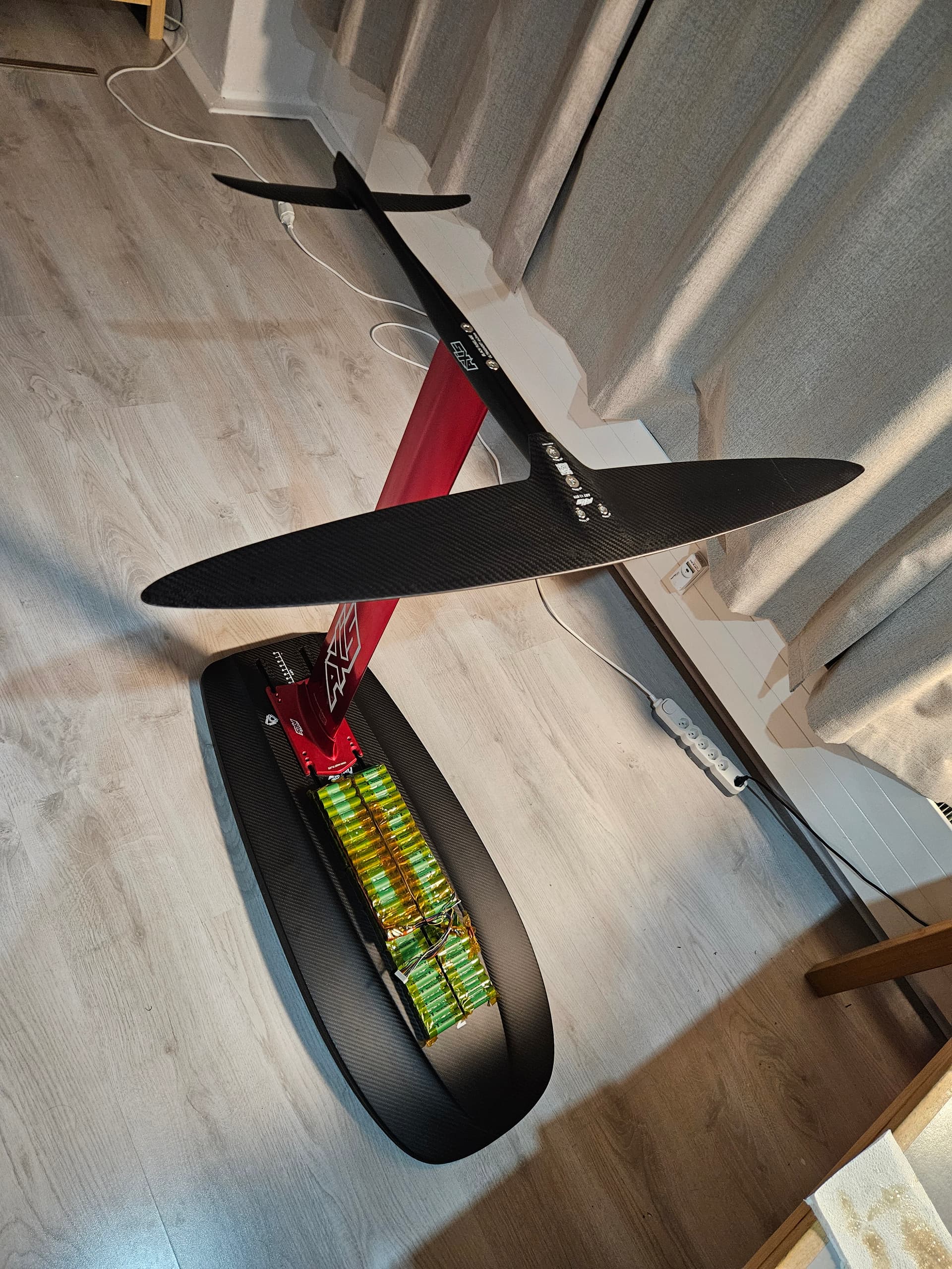

Also this weekend I disassembled some eskate batteries and it gave me some ideas.
I’m thinking about doing a very low volume light build.
I will try the winch soon with the pumpfoil board to see how difficult it is to stand on it, but i don’t see why it would not work.
It would be amazing to have an efoil of this size, it could be manageable by laying the battery flat or i’m also thinking about a backpack battery.
The biggest problem with low volume boards is not that they are difficult to stand on, but the exposed propeller that protrudes beyond the dimensions of the board.
