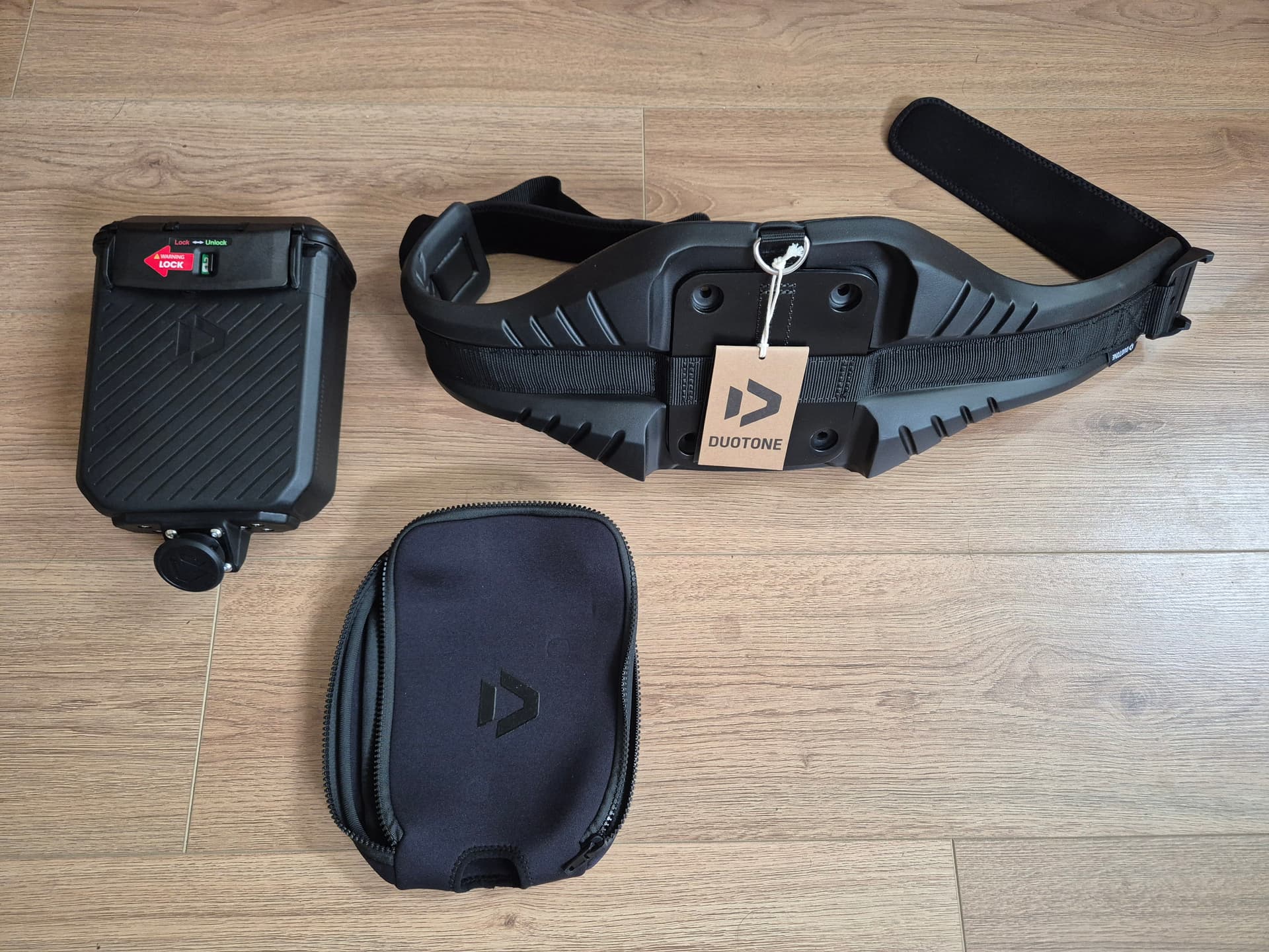

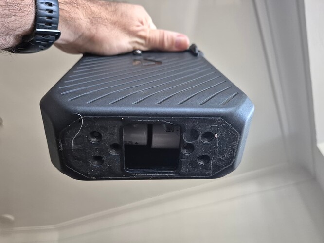

So I decided in order to speed up a waist assist build, id buy the duotone harness and assist box. Really glad I did as the quality is fantastic and and it’s incredibly comfortable. This is what comes with it:

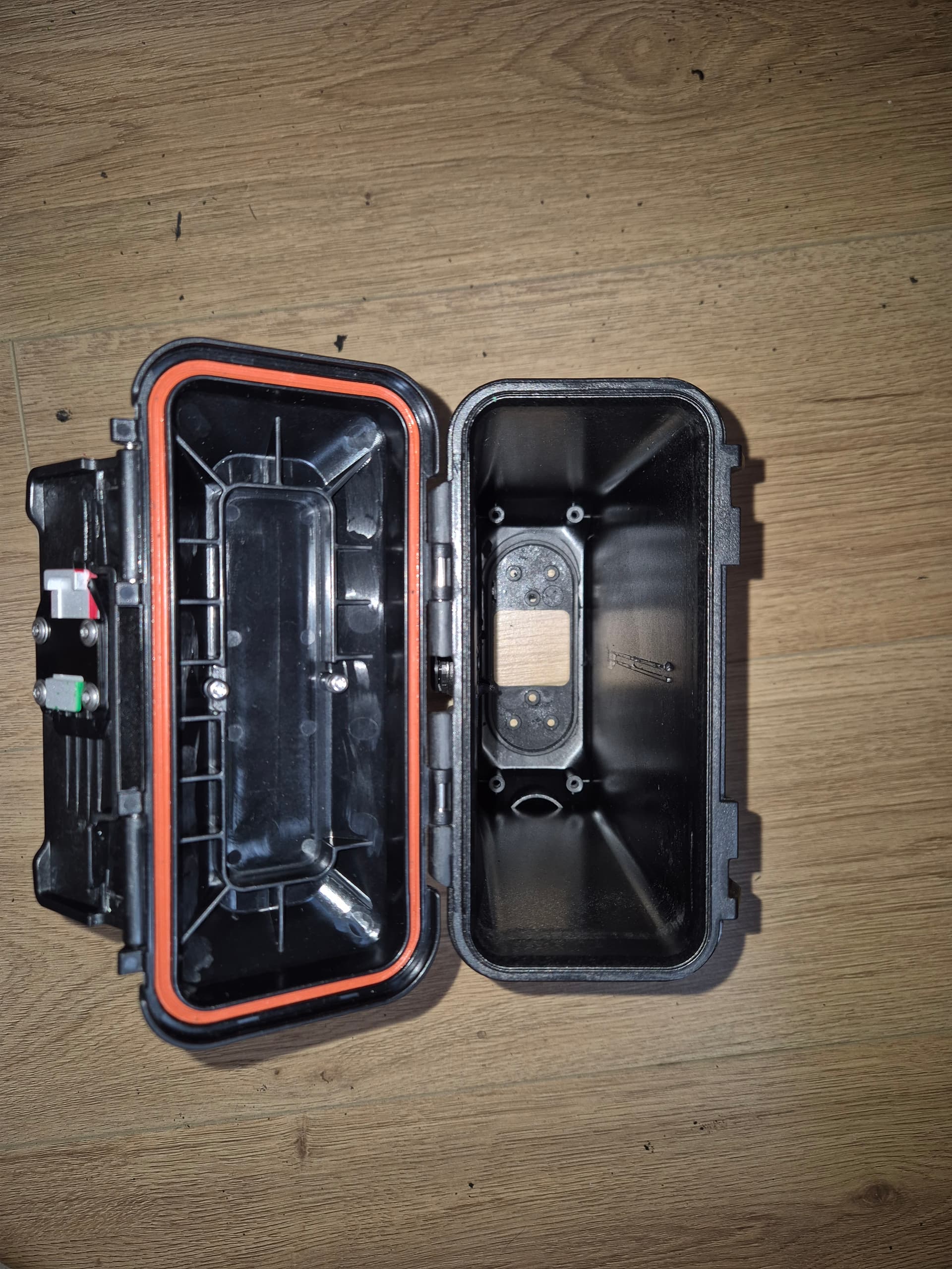

Dimensions of the opening start at 150 x 63mm and then taper down slightly towards the bottom where its around 144 x 57mm. I will get a pic of some 21700 inside it for ref shortly and add it here too…

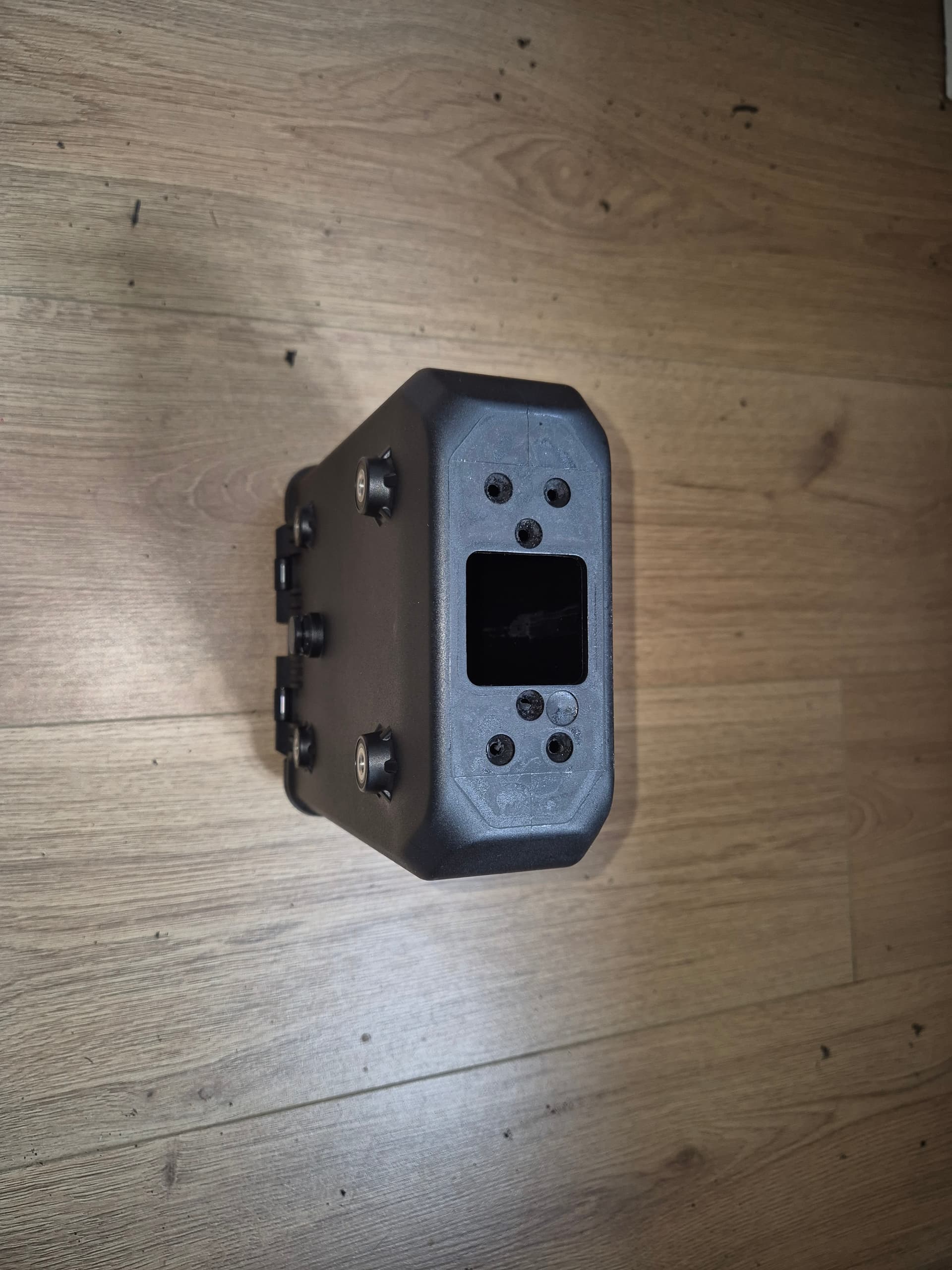

I’ve already torn the box down slightly so that I can replace the connector with something different and also place the esc at the bottom of the unit.
It should fit up a 14s2p pack which is nice.

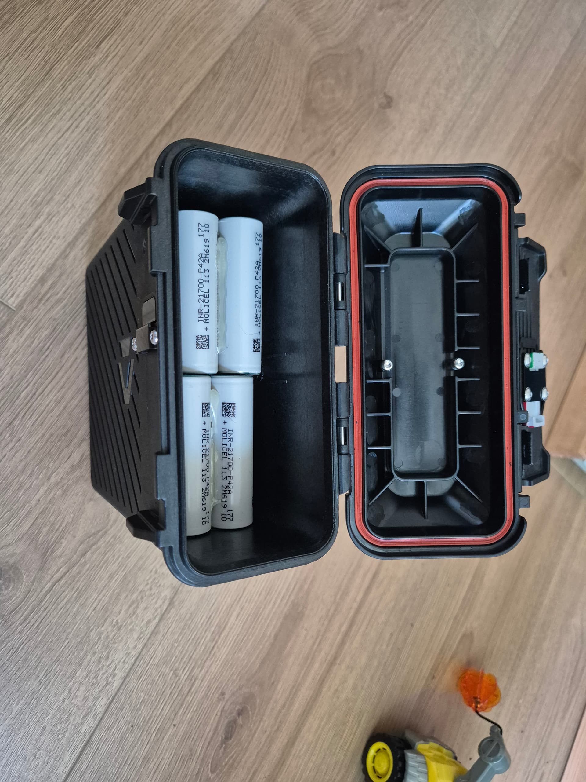

Here are some pics of what 12s2p looks like:
There is 42mm free at the top and 23mm free at the bottom. Cells can’t run lower down though.

Waist harness was £99 and the box was £169 with the neoprene cover. I think for the quality it’s actually a fair price.

That would have saved me a lot of time for building the box, can you share a picture from the inside of the box.
I have updated the original post with these pics.
@Jezza could you please measure the inside dimensions of the batterie box? Your idea is fantastic. But want to know which batteries would fit the box. Thank you very much!

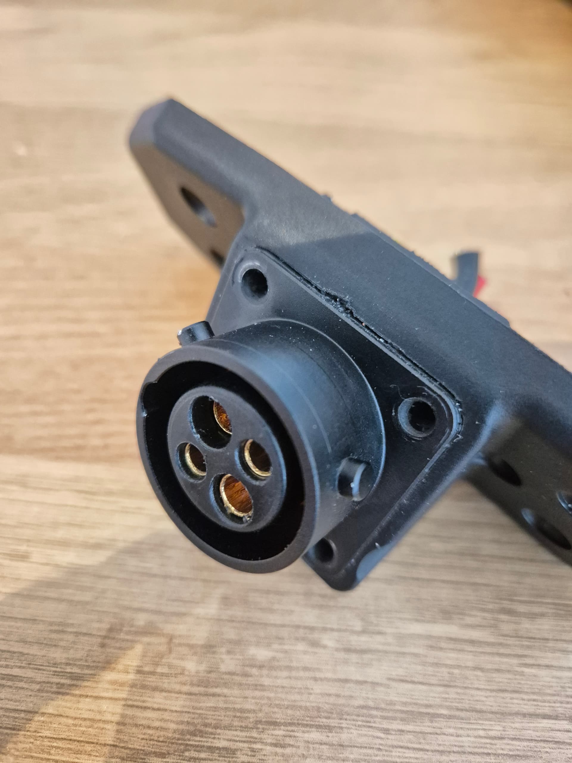

This is the duotone connector. It’s metal and unbranded. But if I could find a 3p version it would be ideal. The panel mount section is 36mm wide.
The closest connector I’ve seen so far is the weipu WY28
The dimensions of the base of my connector are 36x32
