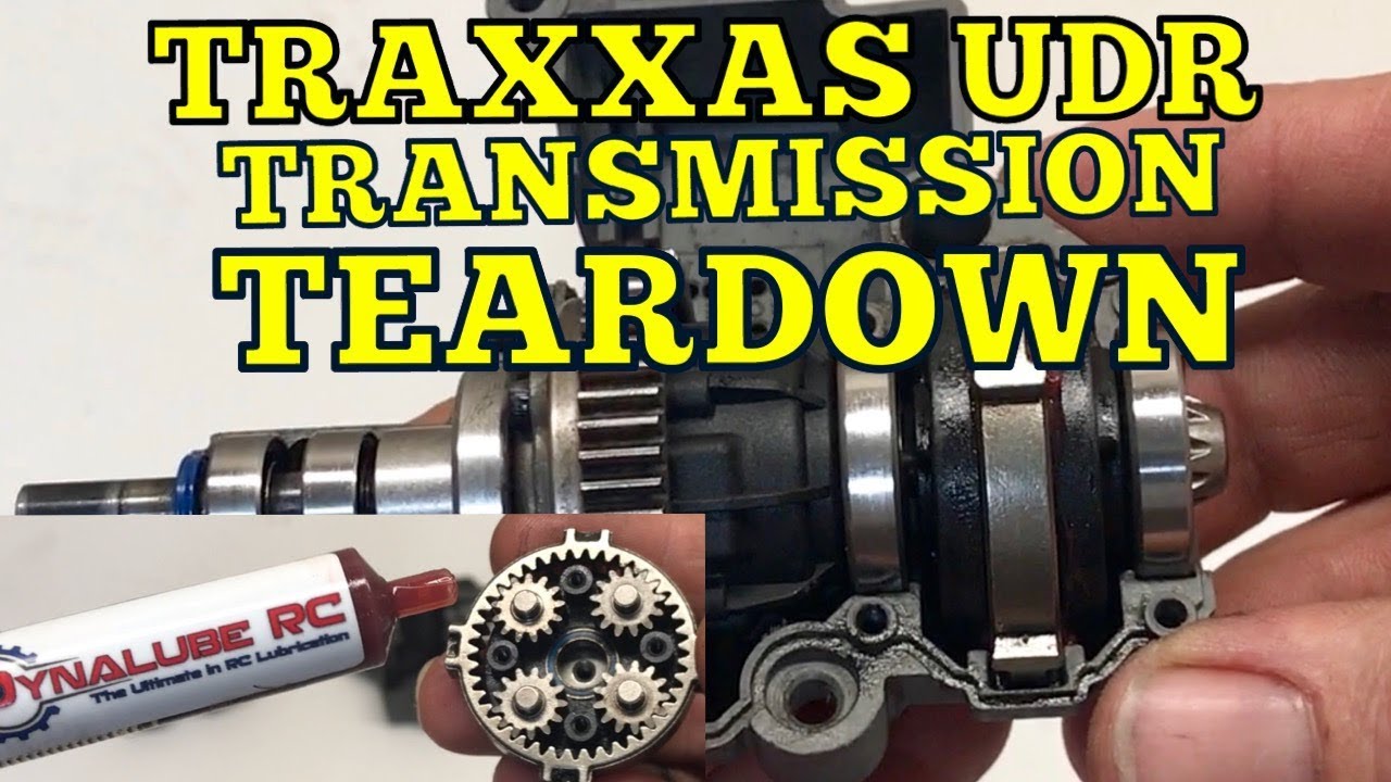

The last is going with the SSS 56114 motor with a gearbox like a lot of successful builds here. The only spin on this is that I would use a reasonably unconventional gearbox to reduce cost. I’m looking at one from a large scale RC model which seems to have the right RPM rating just slightly lower power rating. But since the gearbox is designed with large teeth and RC cars (constantly slamming throttle from standstill) in mind I think it should be plenty robust to transfer the torque. I can’t find a picture of the gearbox fully assembled so leaving that out for now. It would require some mods but nothing I can’t fix on a CNC. Cost is roughly 35 euros for all the parts (bought as separate spares) and would need some interface parts printed/machined to be suitable. Going down this path I would consider either having a POD (like everyone else) or integrating everything into the fuselage. I still need to work up the CAD since I only recently found this option and there are no resources for the gearbox online.
The last is my preferred option since I’m interested in testing that gearbox and it seems more efficient than the outrunner.

Edit:
Found a video showing that planetary. It’s pretty similar to ones from a gearbox by the looks of things.
