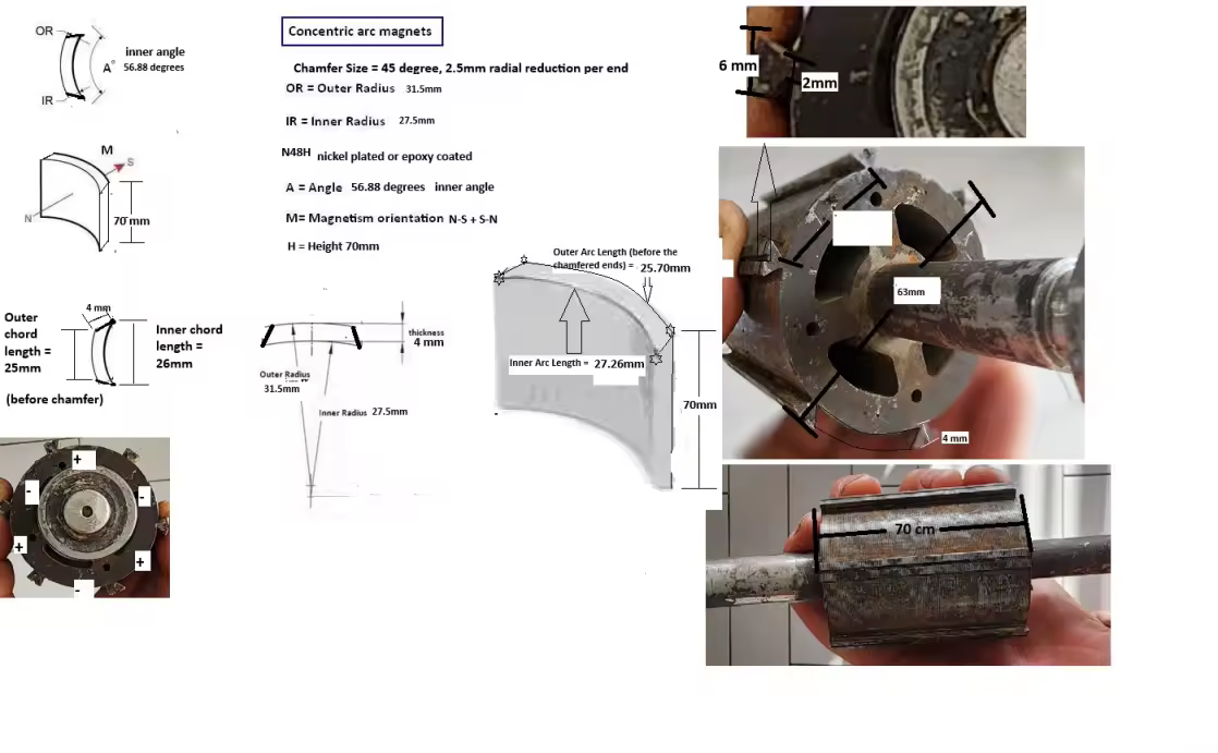

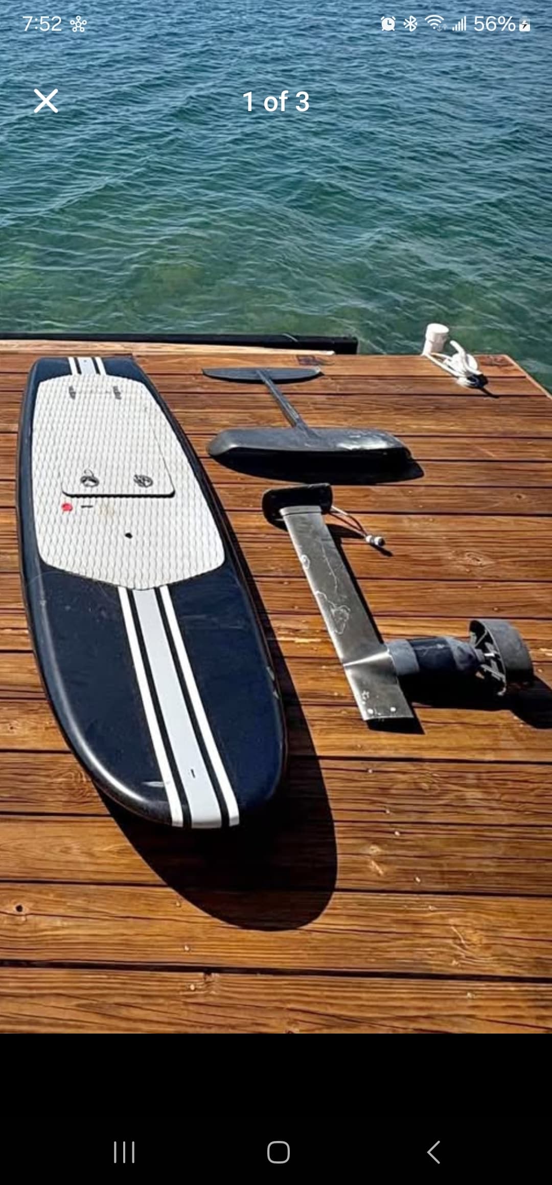

Rebuilding a motor with bad magnets. Only market that offers the magnets are custom made in chine. Still trying to find the original specs of the motor, no info at all anywhere stamped or traceable. Bought the board on facebook. Looking for advice or motor swap that will fit the original mast. The diameter is about 105mm. Searching also for replacement magnets. The micro controller does light up when connected to a battery but it still needs a controller.
