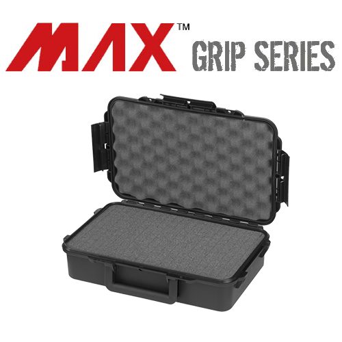

Came across this box. Seems vendor has good reviews but they didn’t respond to my questions. Height is little high but it can feed for most of the DIY boards. ny board requires battery box to be less than 87mm
https://www.aliexpress.com/item/4000003122025.html
@samisin Not much choice for your board , check maxgrip 4 and maxgrip 3 ( I fit a 6s14p folded)
