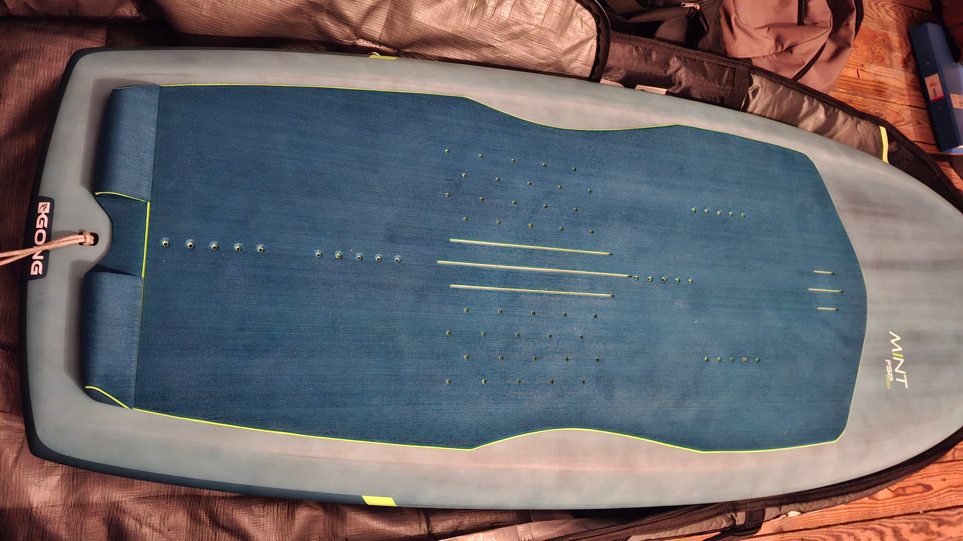

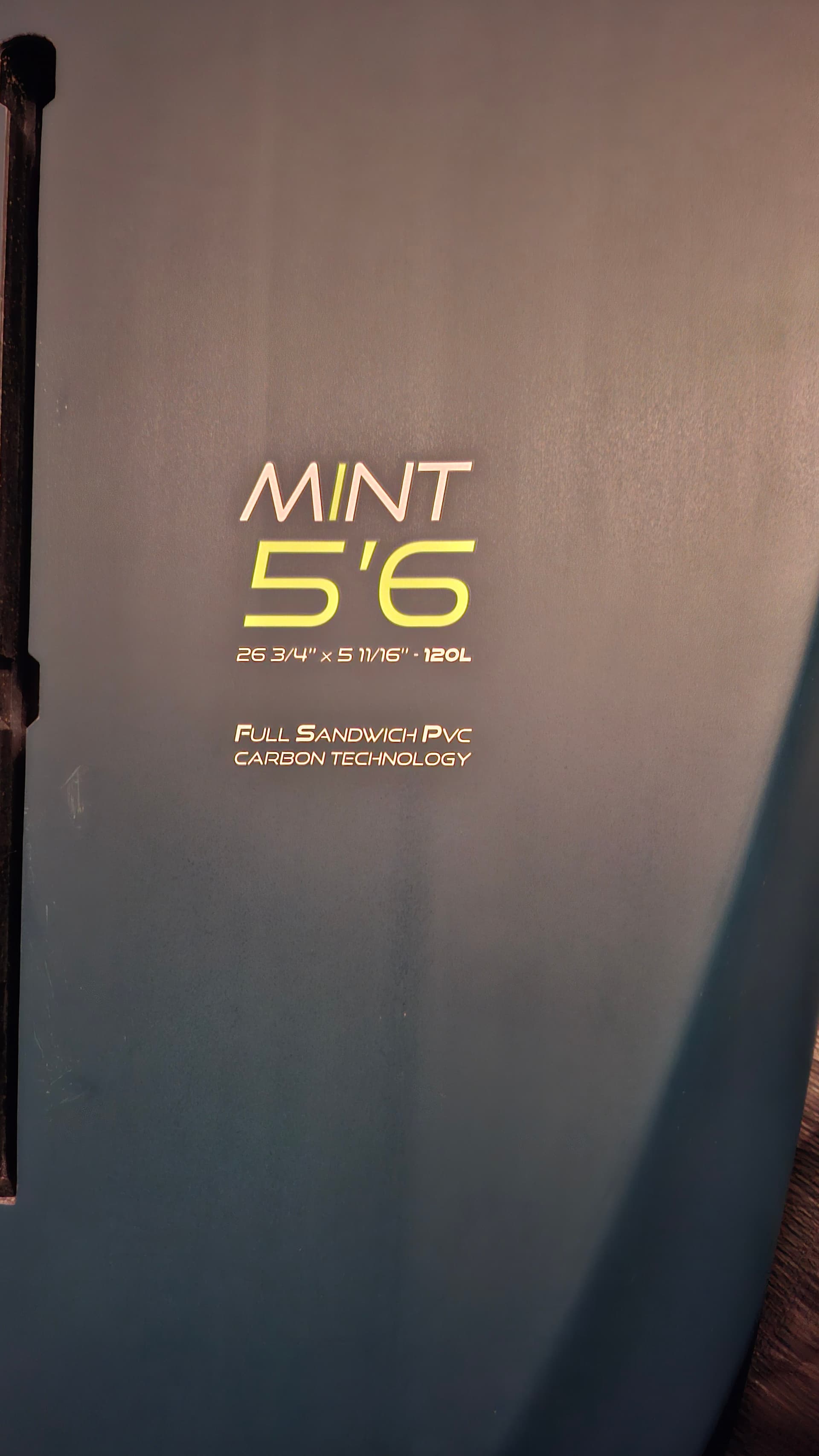

board i have is a gong mint pro 120l (5.6’) so this must be ok for the extra box (also inflatable one from my starting days but will sell this)

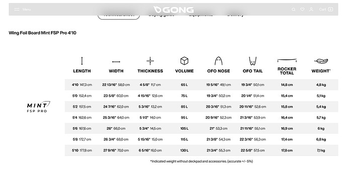

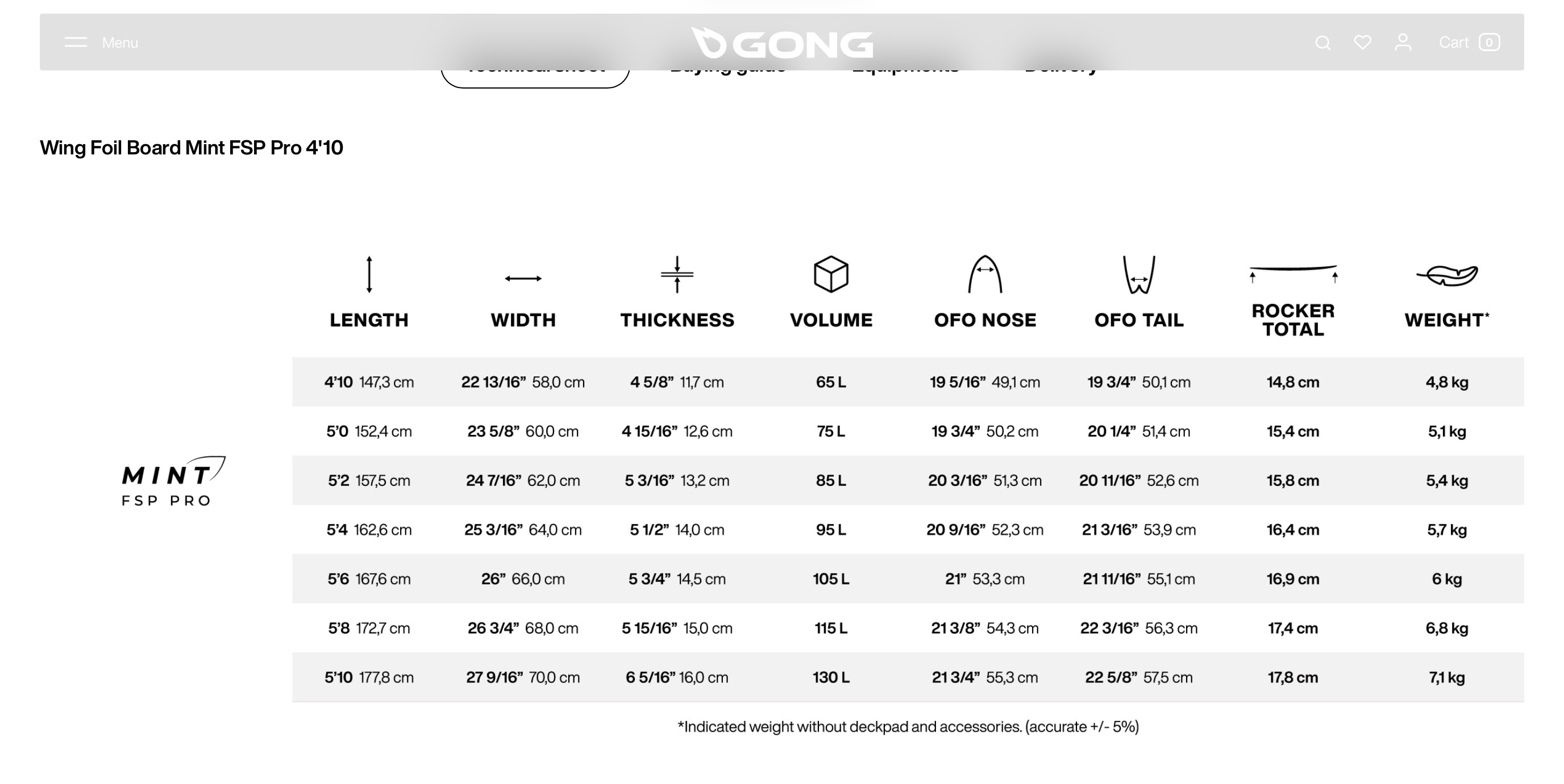

I don’t see this is the chart I posted but 120l is lots of volume for Efoil. Fliteboard largest glass board is 100l.
I use XOver L size with same motor, 75200 VESC and 10S 11P (42V max battery). I have the XL and XXL sizes but now that I know what I’m doing prefer the smallest of the three. I weigh 85kg on a 100l Fliteboard.
