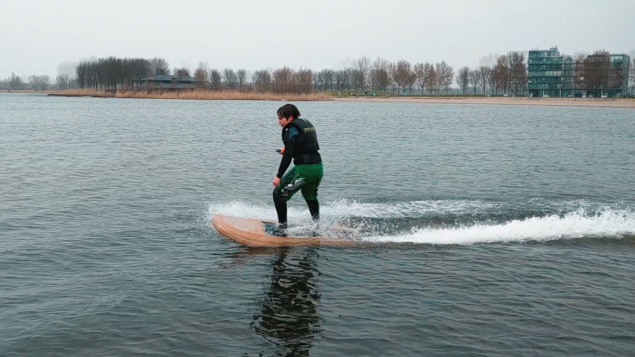

Finlay. The maiden of the new board.
The new board is way more snappy than the old board.
I’m testing it here with a 6S. Next week 12S :slight_smile:
